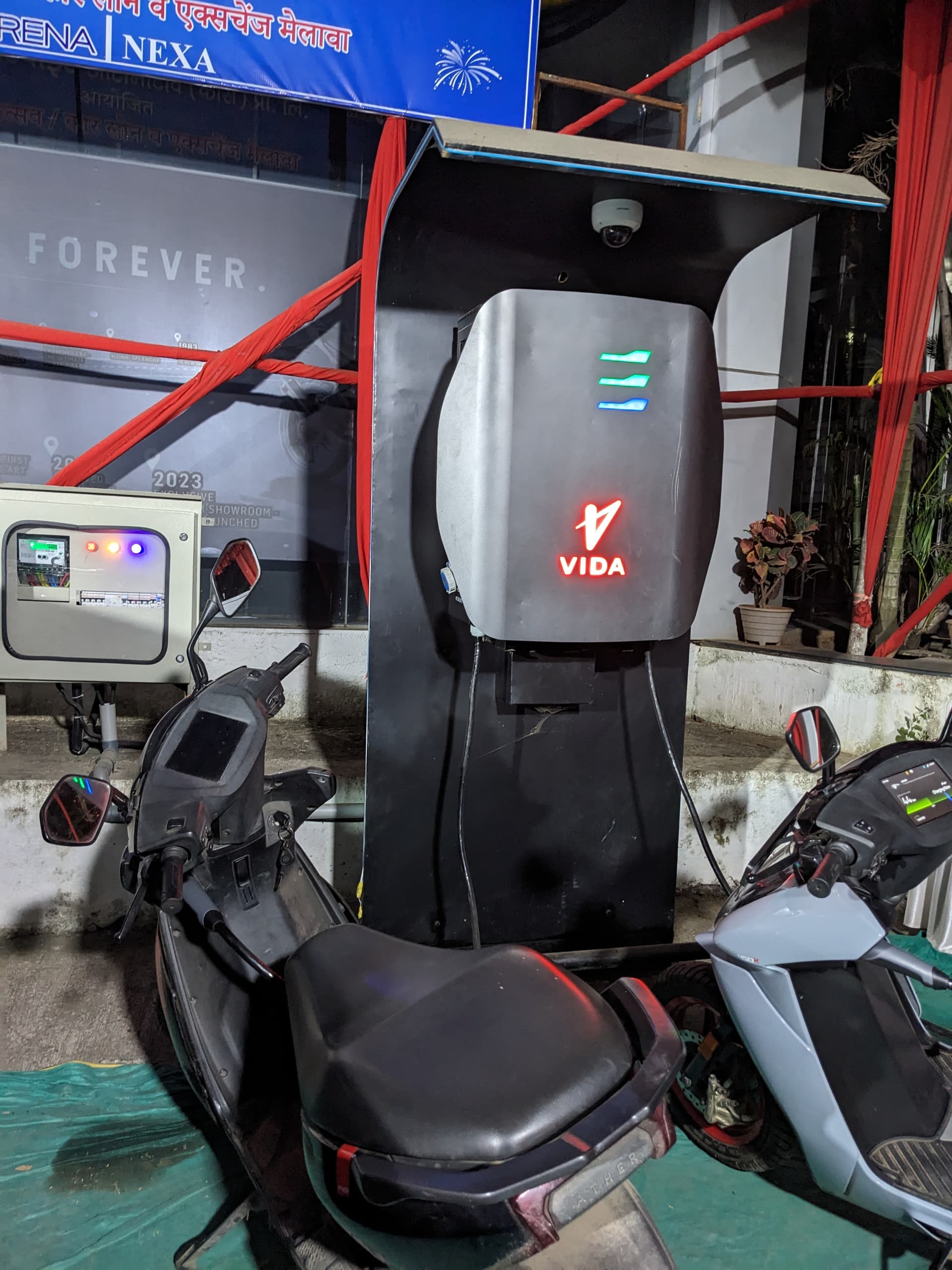

Guys I Live in Wagholi there is no Fast charger currently available so have to visit kharadi or Viman Nagar Ather Charger for Fast charging during long rides. Recently news came that we can charge Ather at Vida chargers I visited nearest Vida Charger which was Mokha Hero Near Wagholi. I thought there would be plenty of space to park vehicle and in images there is place to sit but the condition of that Vida charger was worse literally no Space to park. My Ather was not able to reach the Vida Charger I have to move 2 to 3 vehicles then I would reached the charger this was really bad experience. I thought it would charge at the same speed as it looks big compare to Ather Charger but it was very slow for 20% almost it have taken 40 minutes very bad experience faced with Vida chargers what to do now guys where to report as it is not Runned by Ather where to report or Request.
Hello Mohan, Actually Vida Charger look Big because It has Two Ports.

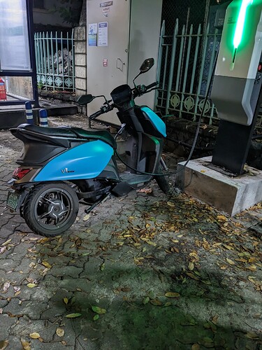

Even When I went to Aluva with Ultraviolette
I was charging it in Aluva Ather Showroom
By the Time a Vida Guy Came but Ather EC Security didnt allow him
Then I explained and Then He let him in to Charge
Coimbatore, It worked Well

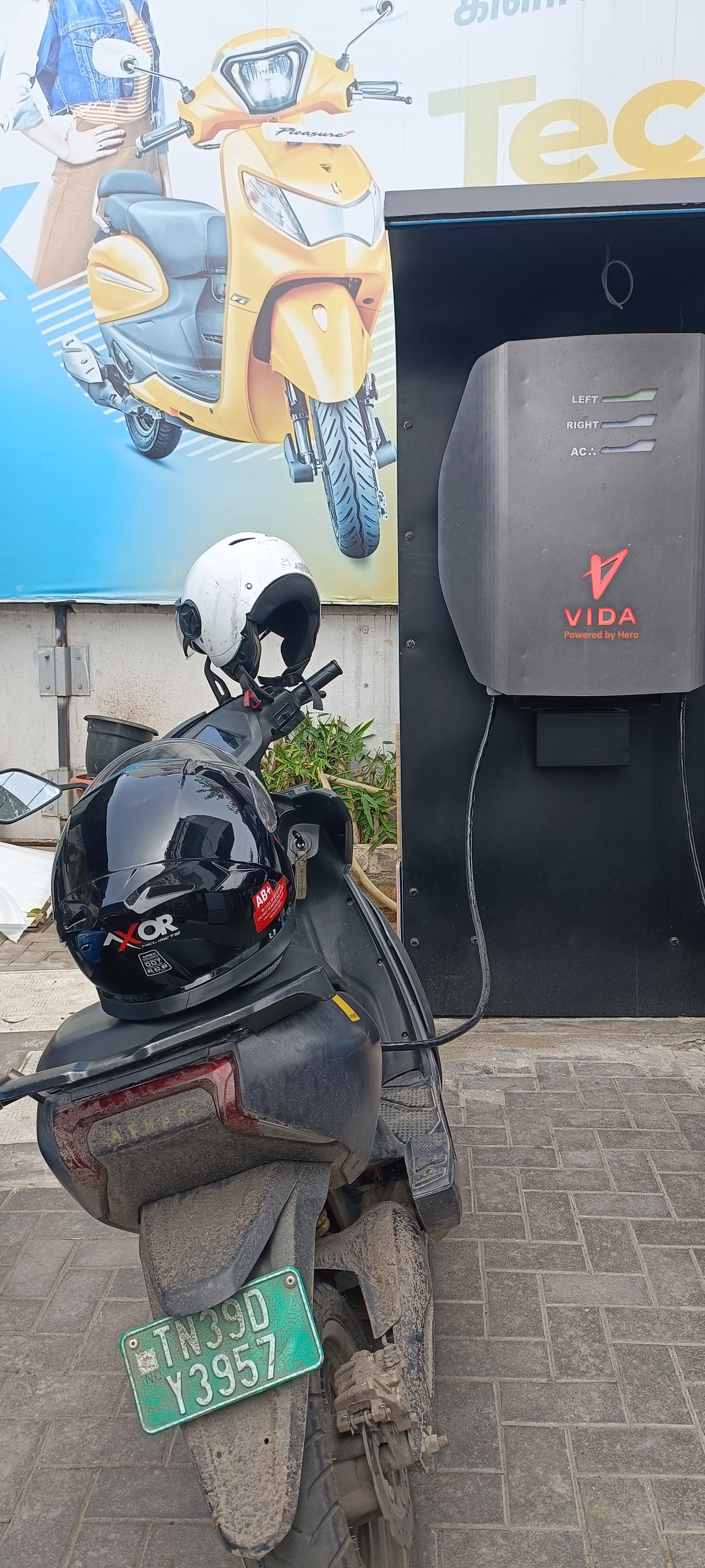

Your Ather needs a wash bro :joy:

Hehe Man, That Picture was Taken on a Rainy Week :face_in_clouds::face_exhaling:
