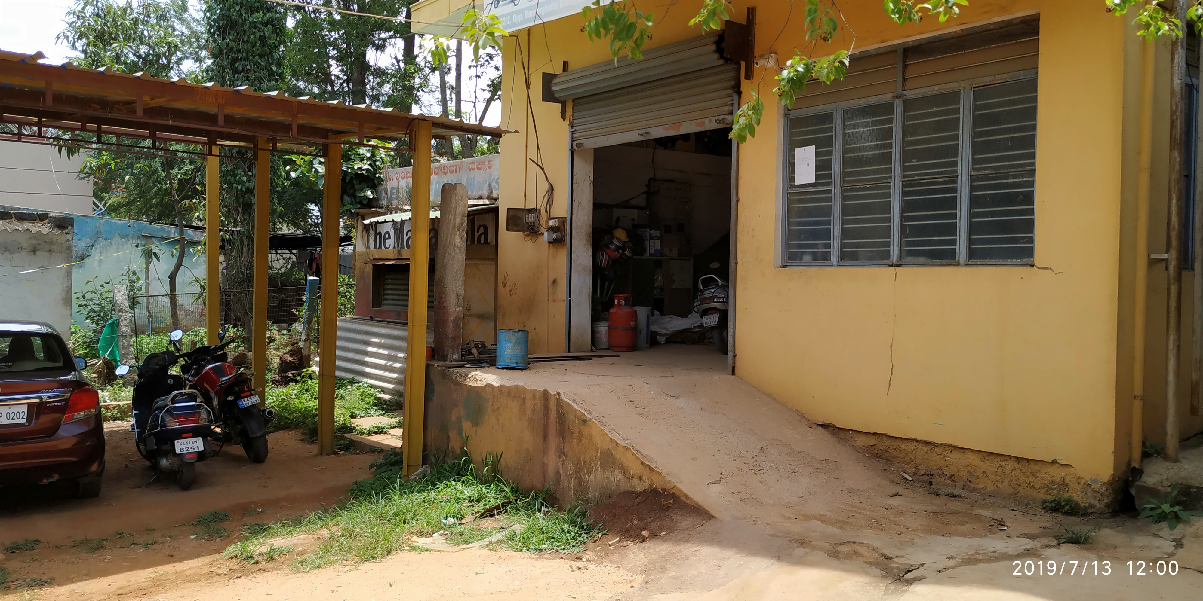

am at this workshop
who modify vehicle for differently abled
bannergatta biological park
querying for one of my colleague

yeah that guy gave me this address
i didnt find anything near my home
he said they are experienced guys so went there to check out
