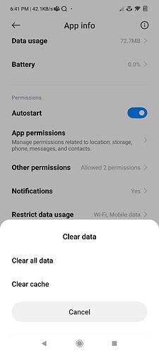

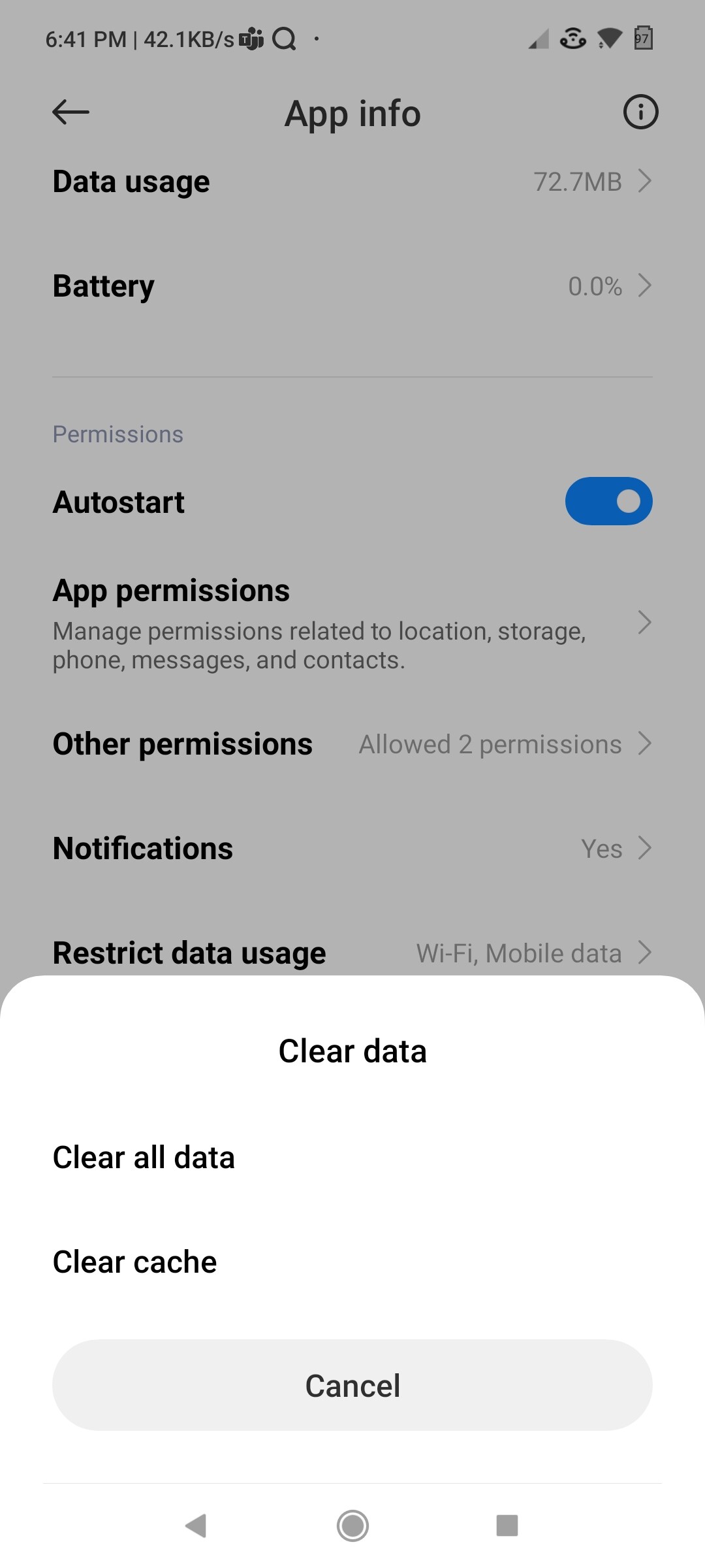

Even After my 4G dongle update, Ather app was not syncing. I uninstalled the app and reinstalled again. Now the Ather app is not opening at all. unable to raise the issue through the app. look like Ather’s hey days are over. Never ever take customer for granted. we , the first gen owners word of mouth was instrumental in Ather’s success. Please dont take us for granted.
Clear cache from the app settings and relaunch
Update: Upon registering my complaint with CC, I got an email from CC asking me to do a LH+RH brake plus start button reset. It worked and its working fine now. Thanks Ather for solving the issue within a few hours.

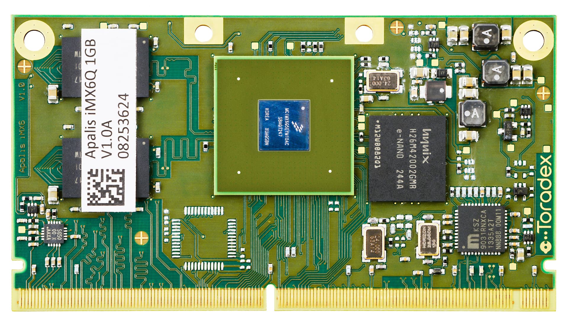

well now we Know The initial models like 450 gen 1 and 1.5 used an Apalis iMX6 board with 1 GB ram
