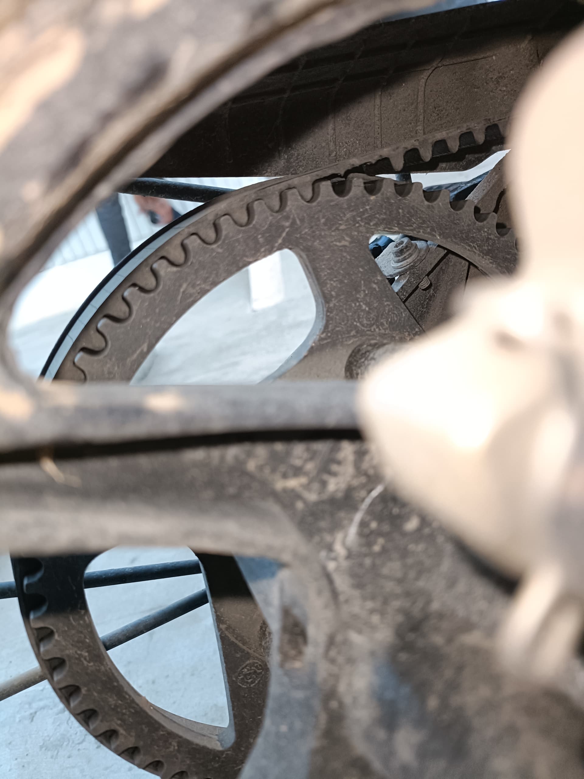

Belt got Cracks

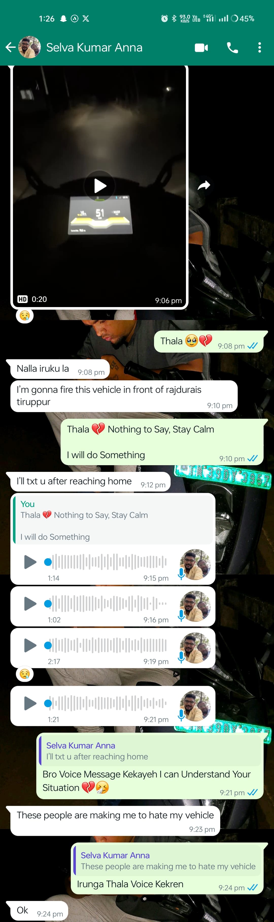

After Starting from SC, My Brother felt something Very Abnormal on the Handling - Right there itself He called Service Advisor (Ajith) And Not Surprisingly No Response from Him - No Call Back Either

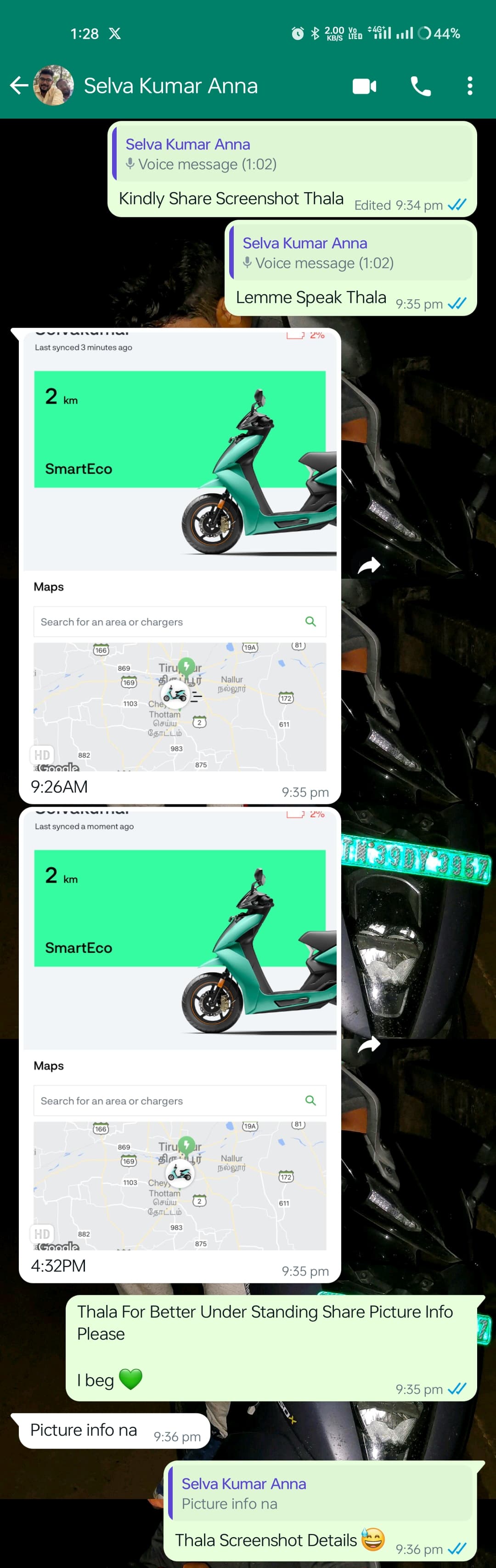

After Reaching Home, Selva called me and I wasn’t available by the Time. So He sent me Few Voice Messages and Video
Vehicle moves like Snake and Quick Cutting Left or Right will End in Fall. I will tell the Issue Later in this Post👍

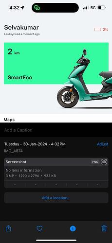

Also He mentioned Not even They charged or Test Drived my Vehicle till Tuesday Evening. How come they will Arrest the Cone Set Issue.
So I asked him for Screenshot (If Any). The Same Customer Shared me.
I made sure to Collect Picture Info’s Too ![]()

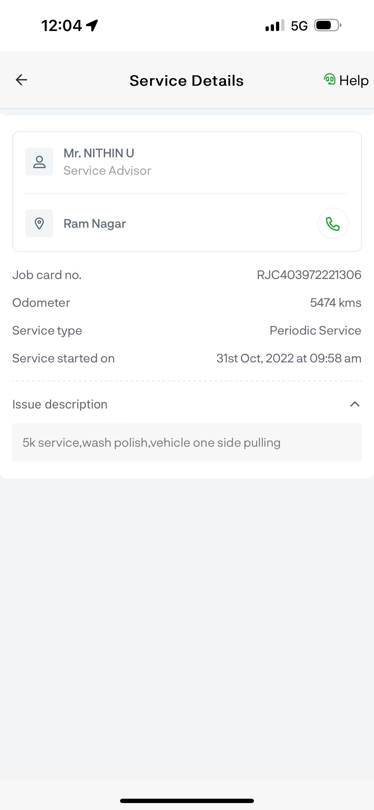

Service 1 :
(Ref : Vehicle One Side Pulling)

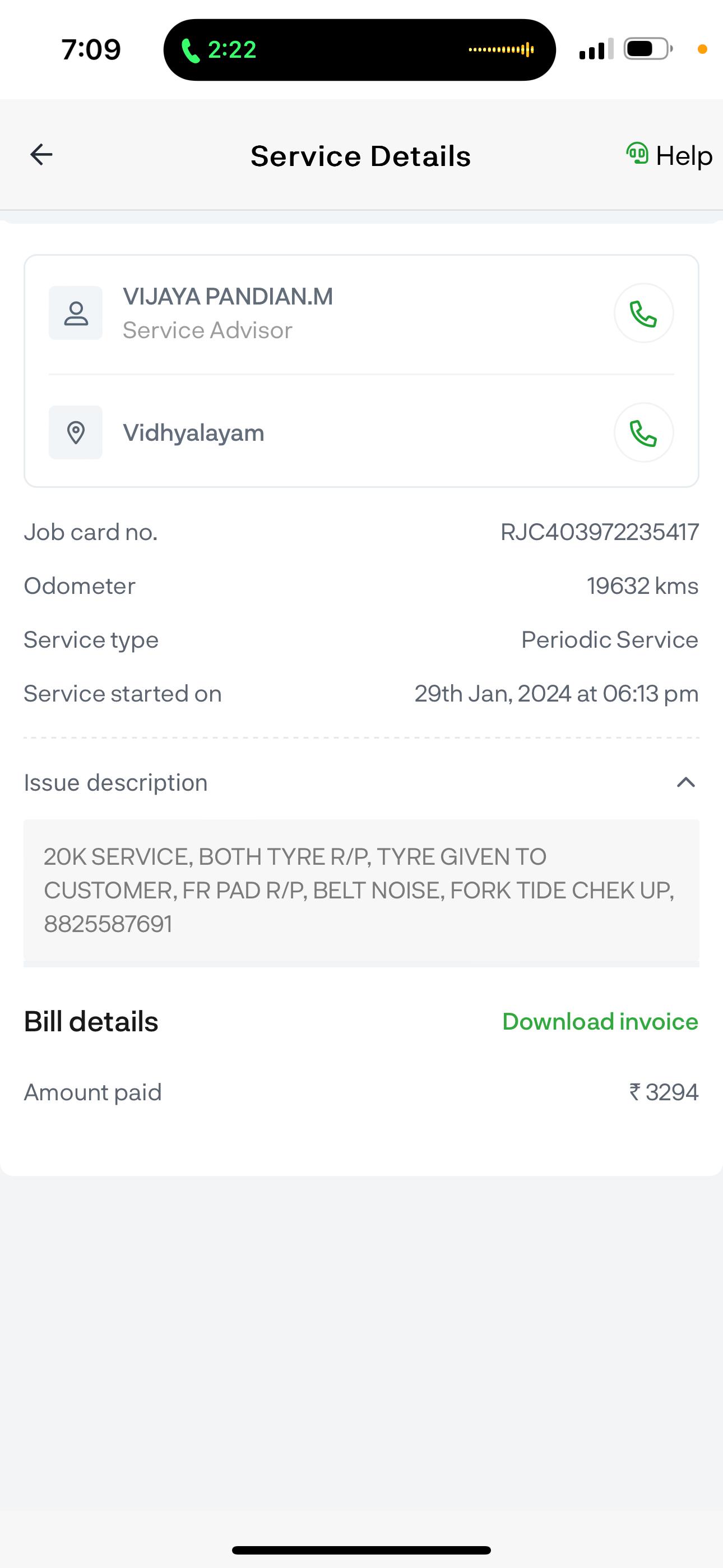

Service 4 : (Current Periodic Service)

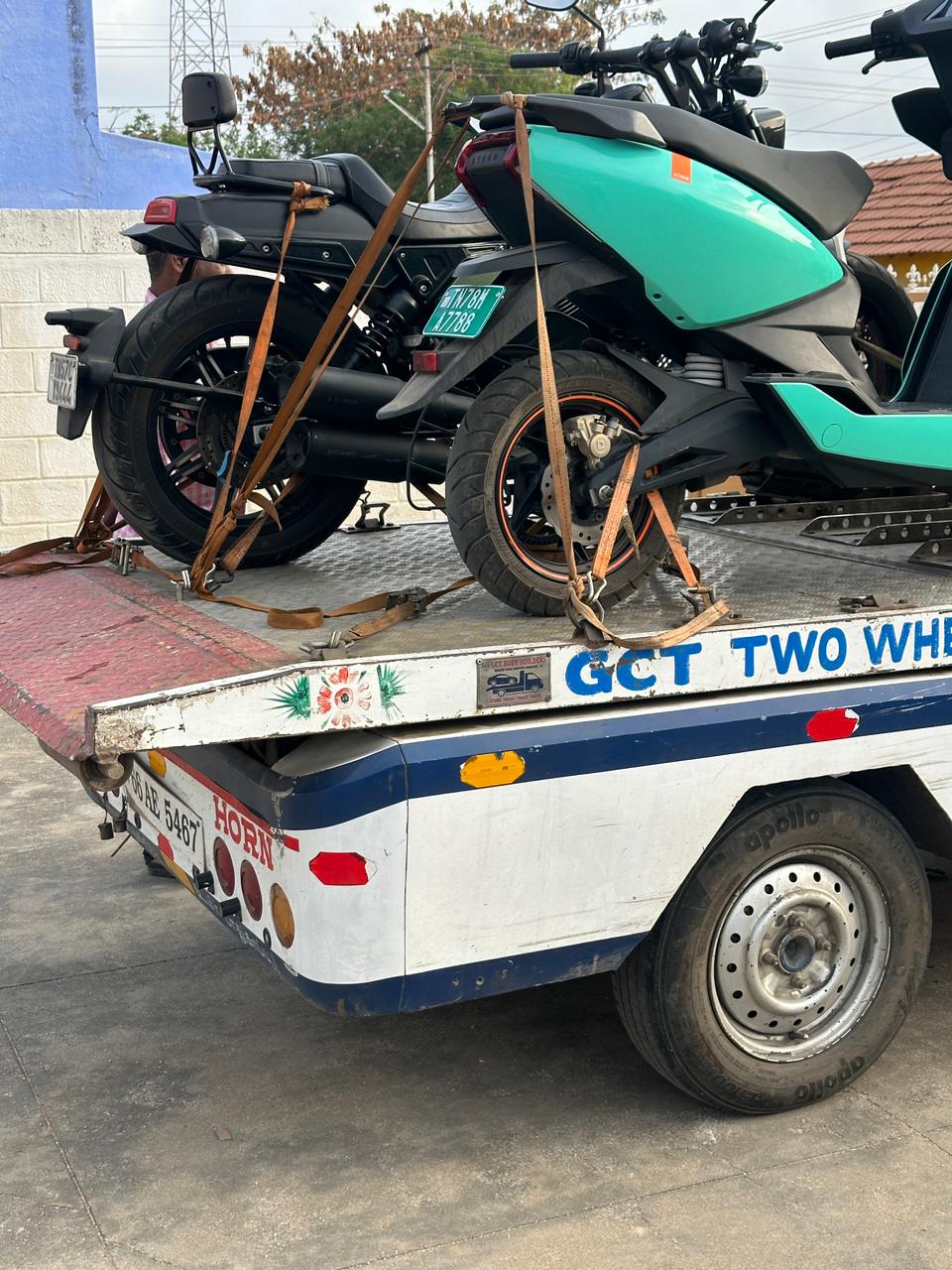

Also I said I dont want to Drop it back in Tirupur SC. So Arrange RSA to Coimbatore Ram Nagar SC (Same Rajdurais RP) and It almost took 2 Days.
Saturday Evening We got Our RSA at Udumalpet, Tirupur
Vehicle Reached Ram Nagar SC by EOD Saturday Feb 03/2024 ![]()

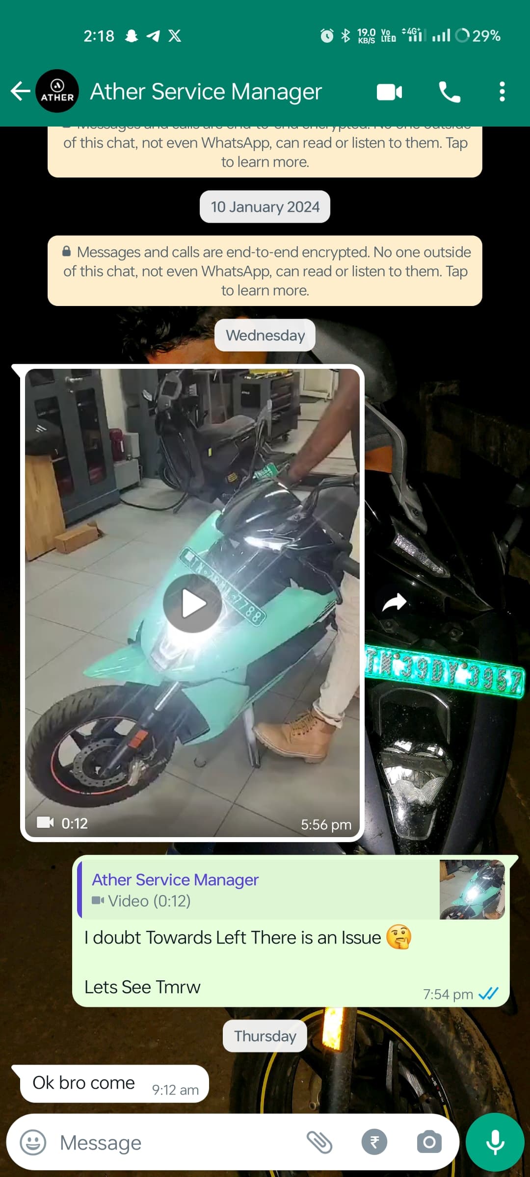

Wednesday Evening They called me and Said Vehicle is Ready but I am not ready to Trust Them - Then Asked for a Video. As Expected Issue wasn’t not Rectified
Video :
Screen Shot :

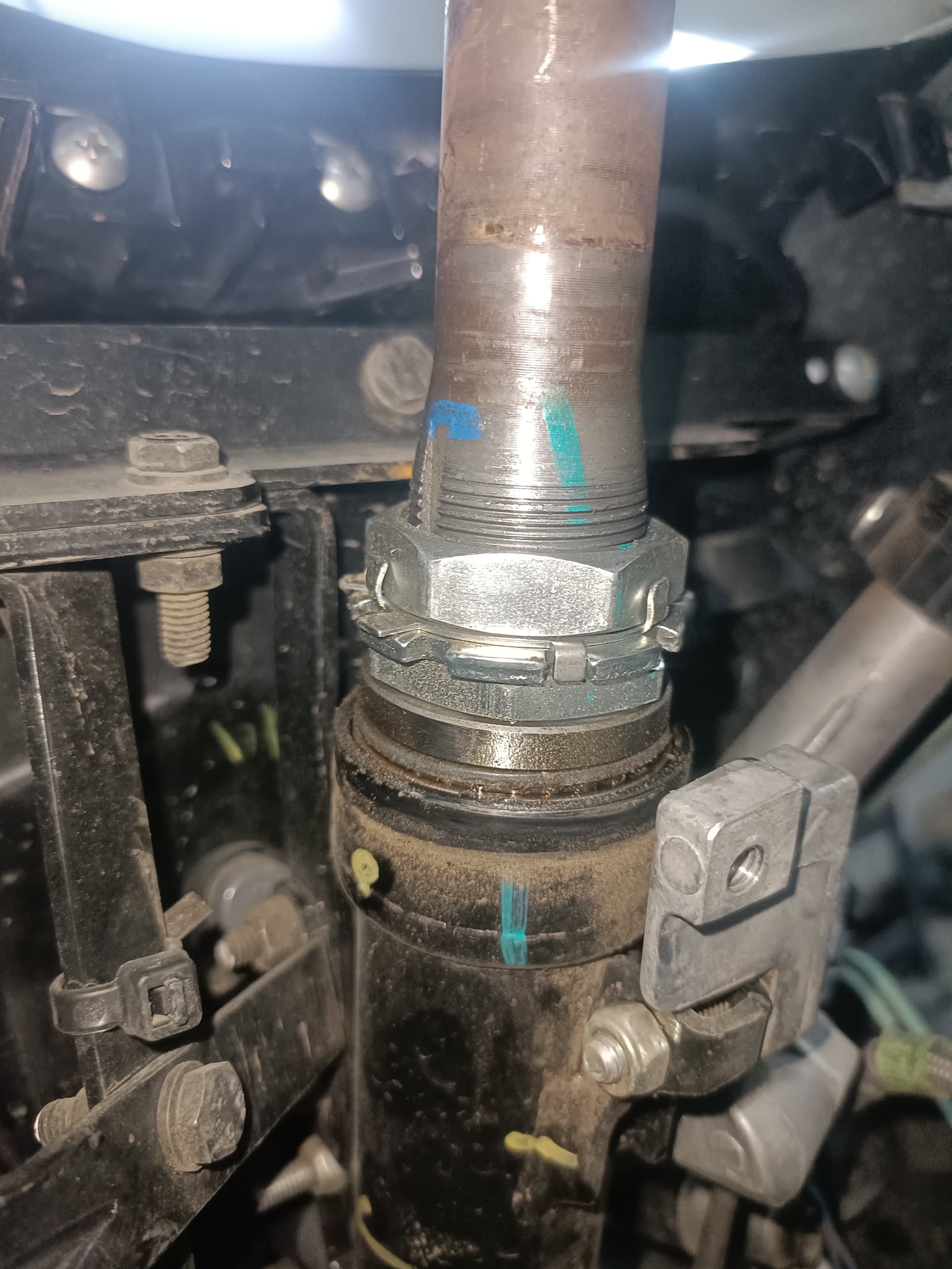

More than Service Issue I see this as Manufacturing Defect in First Place :
As I mentioned Above We have this On this Gen 3 from the Beginning, @withselva7 used to Tell But I negligent his Words saying Maybe Tyre Issue ![]()
Now We changed Front Tyre at 20k (Thats another Topic)

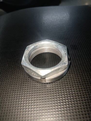

Coming to the Point : It’s Razor Kit Manufacturing Defect
Currently from Gen 3 and Above, Ather Using Different Razor Kit - That is not Sitting Properly on Cone Set and T Joint
Ref : Gen 3 with New Razor Kit
Actually Our Old Razor kit was Good and Capable of Doing its Purpose
Now I will add Old vs New Razor Kits Picture.

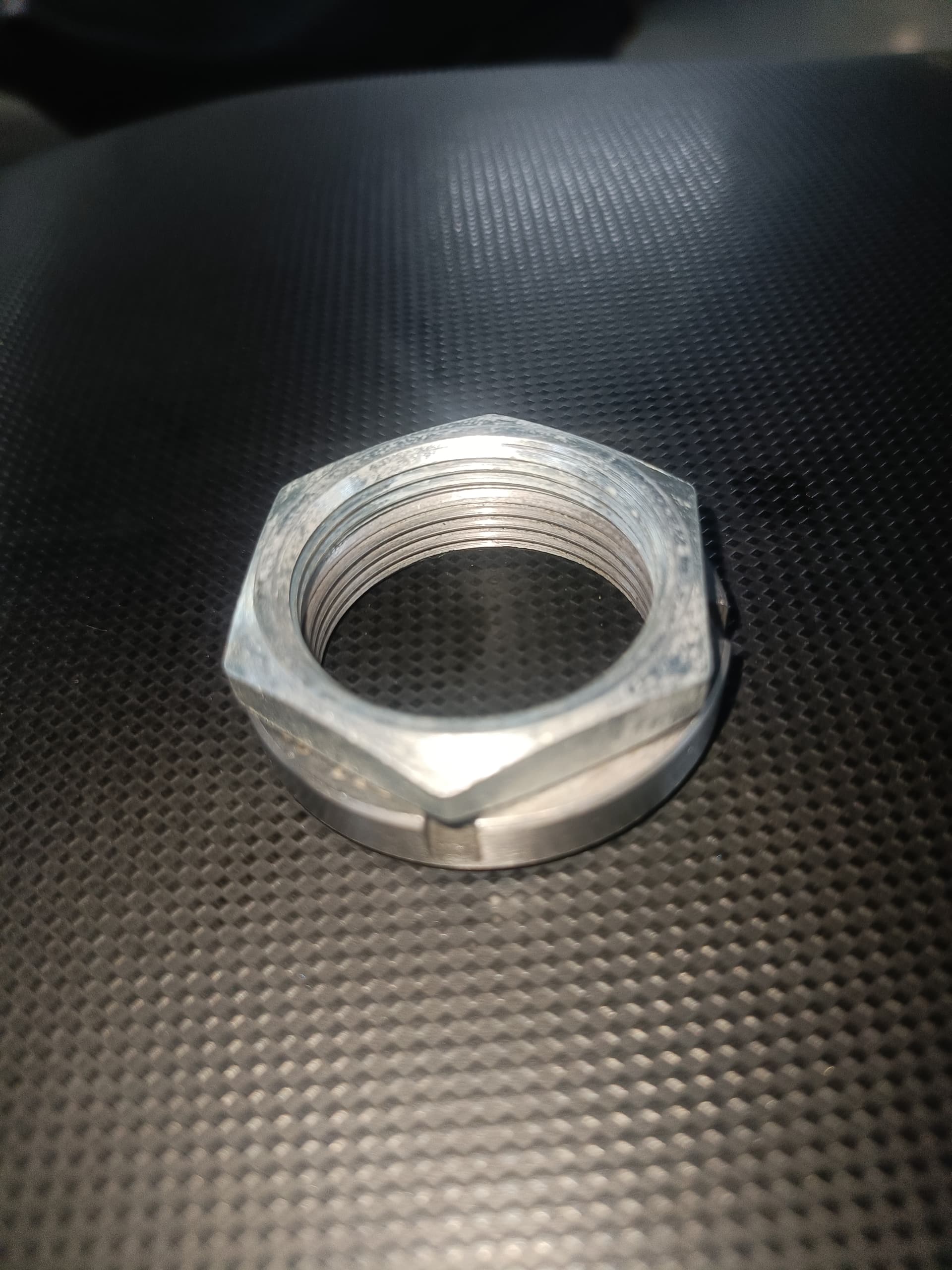

(Old Razor Kit with Retainer Nut)
(New Razor Kit with Retainer Nut on Left Side - Old Razor Kit)
My Question to Team Ather : Old Retainer Nut is Most Reliable But Why this Unwanted Change - That Spoils Both Customer and Company’s Peace of Mind ![]()

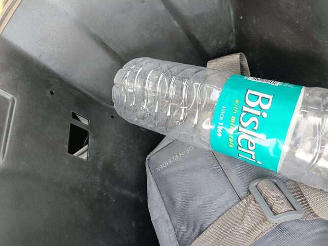

Tirupur Service Center’s Final Inspection After Service is Nightmare to Any Atherites. Because They just dropped the Boot Box with Nuts kept Inside + Boot Inside a Cap will be there for Data Cable ( That Went Missing after Service)
Pictures for Reference below :

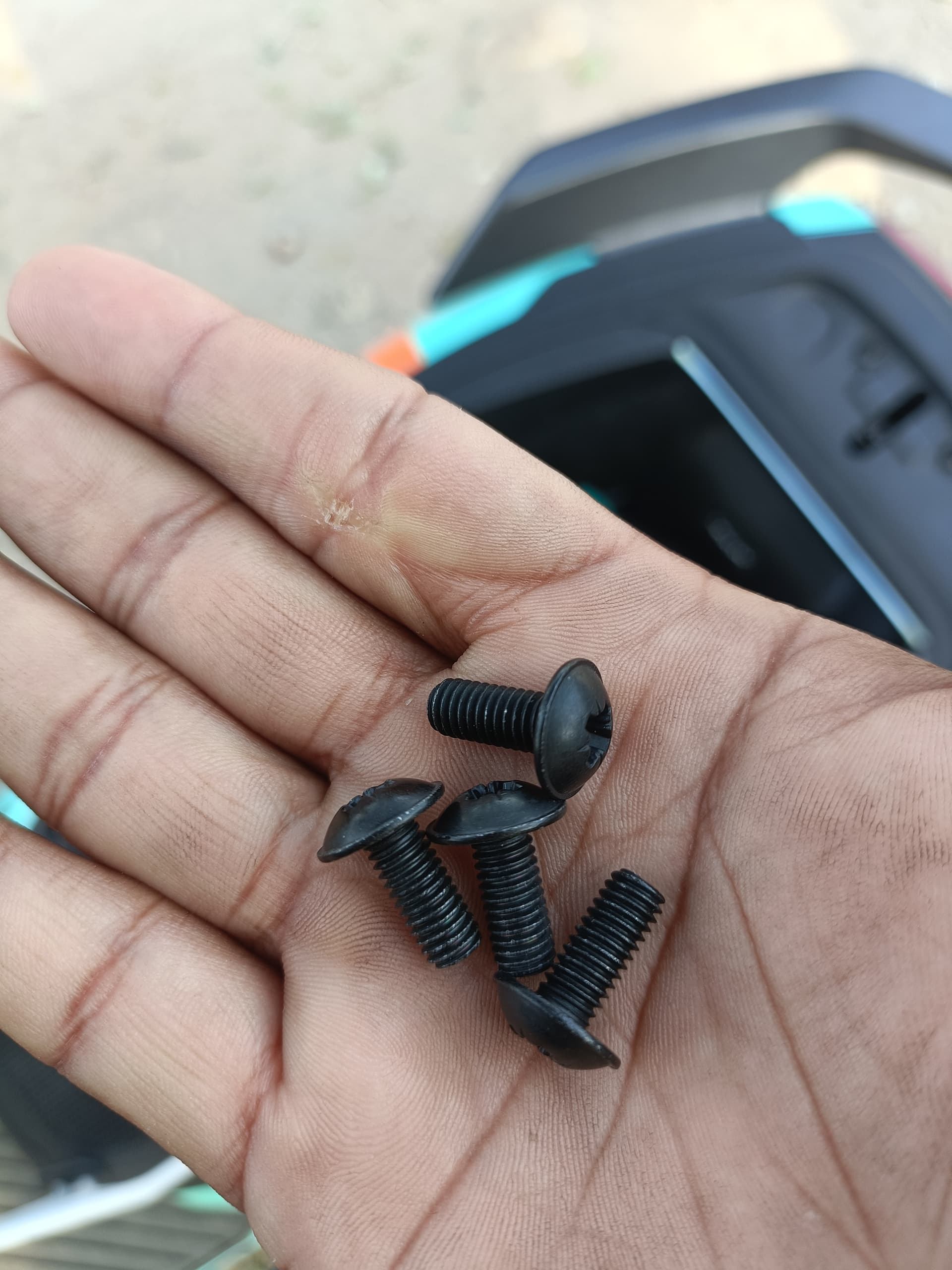

Boot Nuts :
Data Cable Cap :
