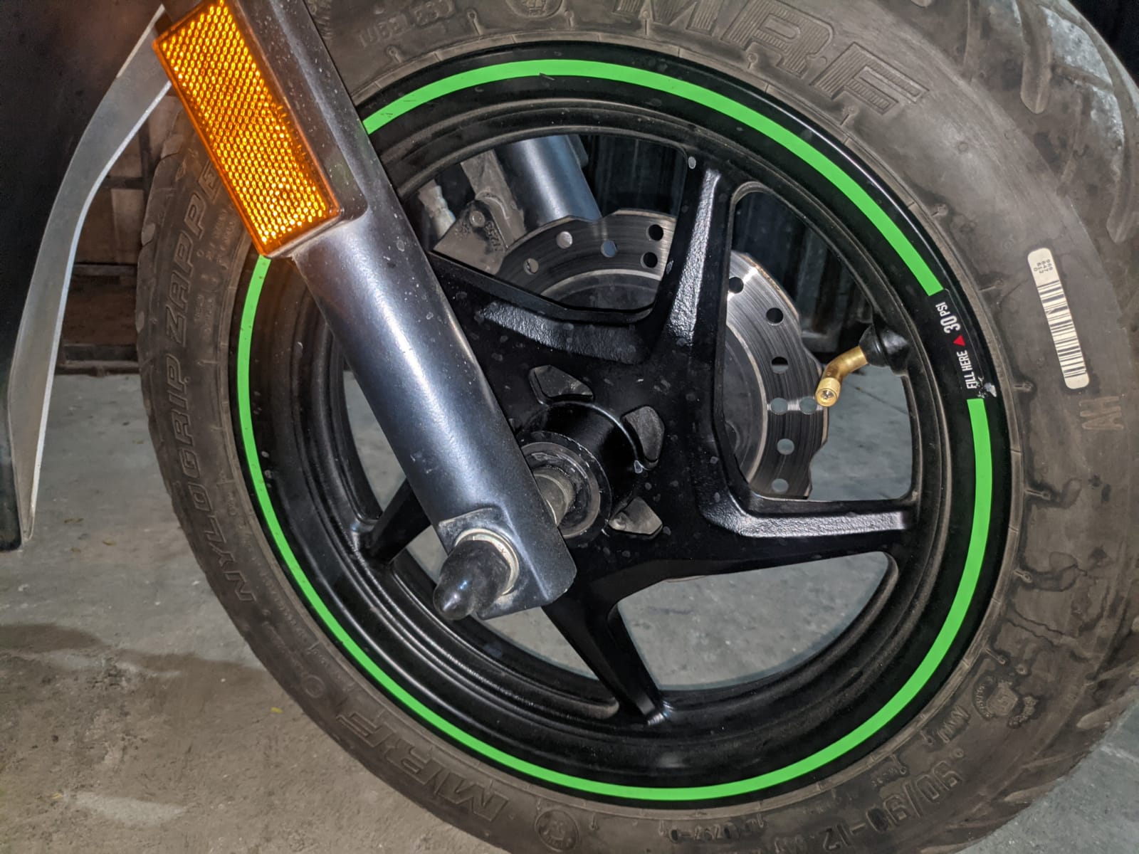

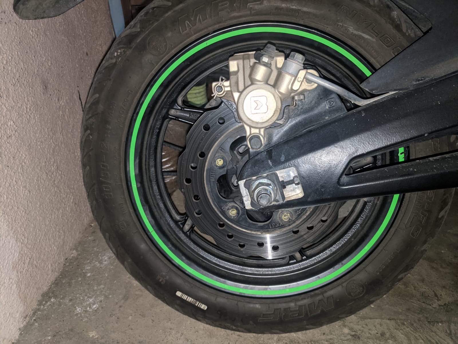

Unfortunately, I was too tired and hungry at that point to notice anything and just wanted to leave and have lunch. It was only after I got home I noticed that my scooter was missing it’s valve caps and the rims were a little beaten up. I didn’t realize I had to give instructions like @Cloudgraphy to the tech to not scratch up my rims :pensive: Looking for some suggestions on how I can correct this. Stickers? (See the torn up portion in the gap on the rear tyre)

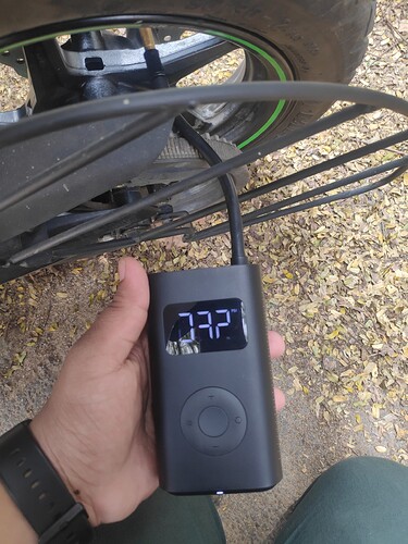

Also, would have liked them to turn the rear wheel’s valve to the other side. The new valve’s are more smug and don’t bend a lot which makes it difficult to fill air using the Mi air compressor.

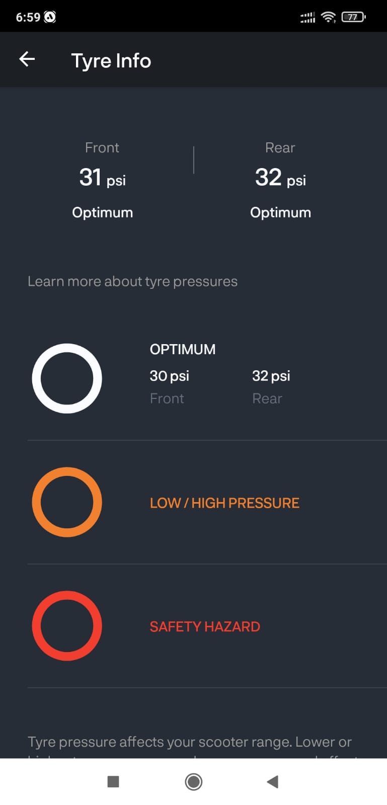

  6. I think the wording on the app can be a bit better. It says “optimum” for both sets of pressures. The ideal ones ( 32R and 30F) and if you have something near to it as well. A little confusing.
There are a few bugs.
This image makes my case. You can see even 0 psi says “optimum”

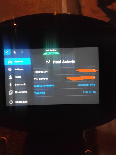

After some more testing, I can say that the TPMS is not very accurate. I took a high speed ride yesterday night and today morning and I got high pressure warnings on my rear tyres.
When I started the ride, it was at optimal levels, by the end, it was high. It happened both times. I suspect heat is the problem. The sensors probably aren’t working well under heat or stress or maybe I got a bad piece. Would love some feedback on this.
In this case the TPMS is likely more correct since it’s an internal device. External device (like the MI here) are generally less accurate than internal ones.
High speed ridings and elevated temps won’t damage the TPMS itself - it’s tested in 50 degrees ambient. This could be a notification error.
In general we have seen a 10 degrees rise leading to a 3-4 psi increase that takes a while to settle back. Tagging @vignesh.reviraj1 who’s worked on the TPMS as the product manager here.
Hi Mani, As Tarun mentioned, the internal TPMS readings are more accurate as they take into account the changes in pressure of air inside the tyre due to temperature, weight, etc more accurately than an external TPMS can.

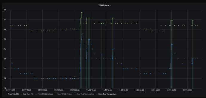

The air inside the tyre heats up during driving and that increases the tyre pressure inside, which is captured by the TPMS. This shows up in our internal test data:
We do not correct for the temperature (it is possible though) as the hazardous conditions for tyres are specified for all conditions of riding, so it is expected behaviour that the PSI readings go up during spirited riding.
Based on the feedback from Beta, we are working on the notification thresholds to avoid nuisance warnings which come even when the tyres are filled to optimum pressures.
That makes sense. It’s been about 30 minutes since my ride and the values have come down about 3 psi since. Was the same yesterday as well. A suggestion would be to block notifications to my phone for increasing tyre pressures during rides. It is highly unlikely (probably impossible) that tyre pressure would increase during a ride, so you could make the argument that that specific notification is false anyway.
Makes sense. Thank you for the explanation and the graphs.

I tried this. The valve was very close to the braking system. We all realised it and got it corrected to the previous position pointing to left towards Saree Gaurd.
