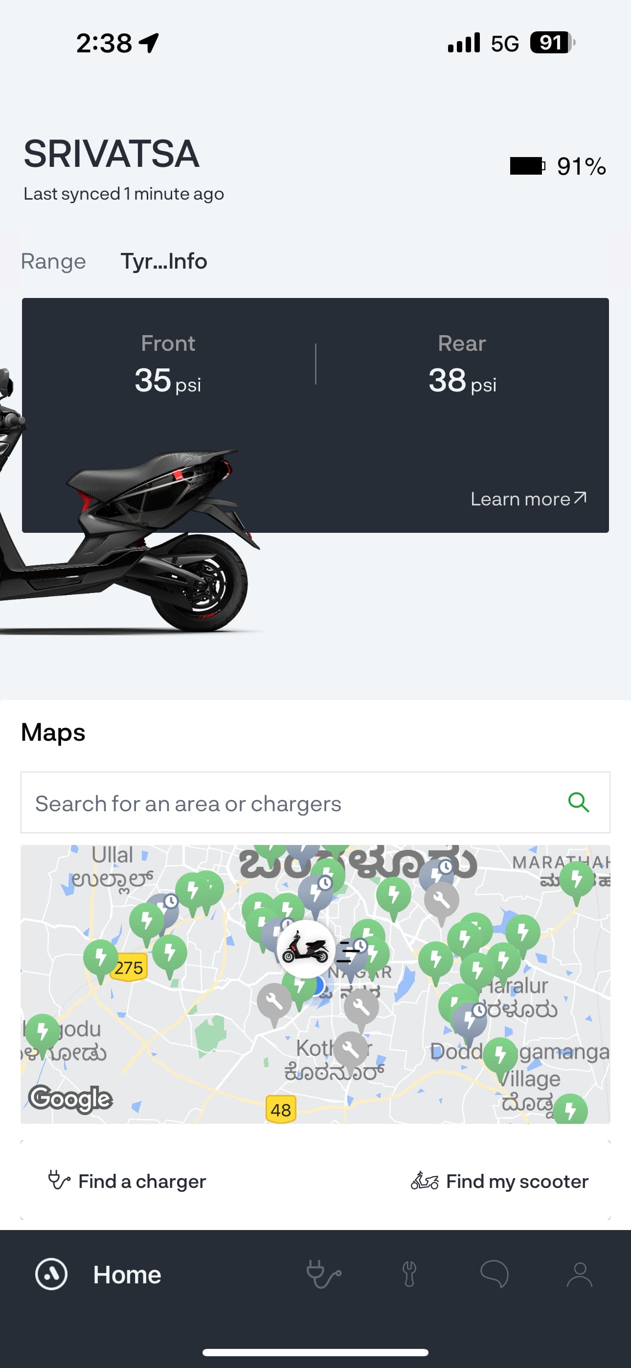

@rohit.dalvi I am still facing this issue, even after updating to AtherStack 10.5.11-202406. Customer Care recommended that my Dashboard Software be manually Reflashed in the Service Center, which was also done on March 2nd. Therefore, I believe the issue lies either with the TPMS hardware itself or a bug not fixed in the latest Atherstack update. Could you please provide a solution to fix the TPMS and ensure it functions properly? Additionally, every time I take my Ather out now, I get a “High tyre pressure in rear tyre” alert and my rear tyre keeps on displaying 36/37/39 psi. When it’s filled to the recommended 32 psi.

Yes, it is… It is hovering around 35~38 PSI… Funny is that the air pressure has not dropped since last 2 months (from the last fill).
