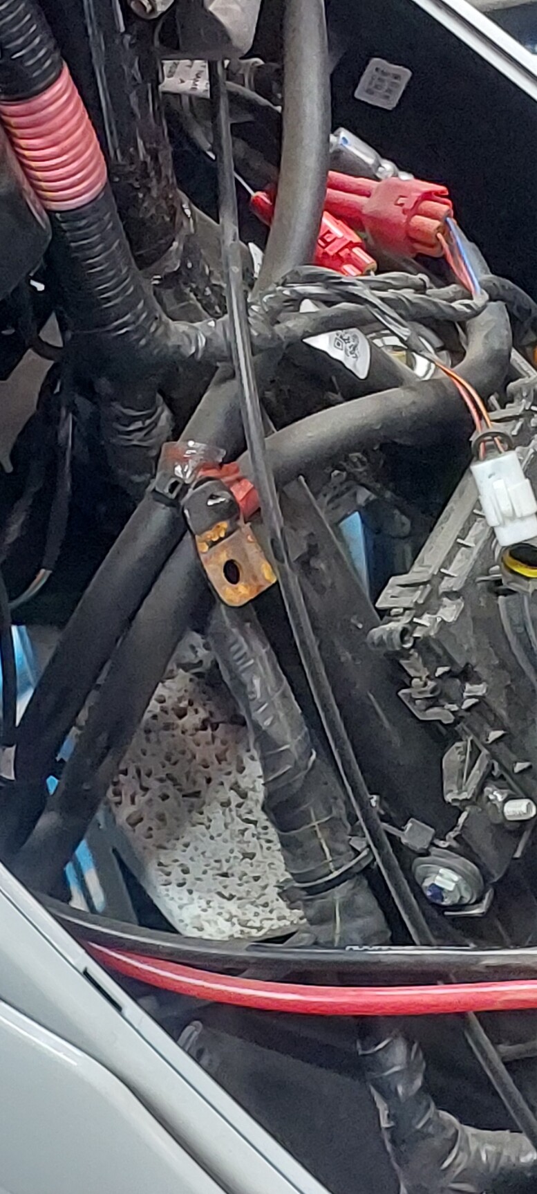

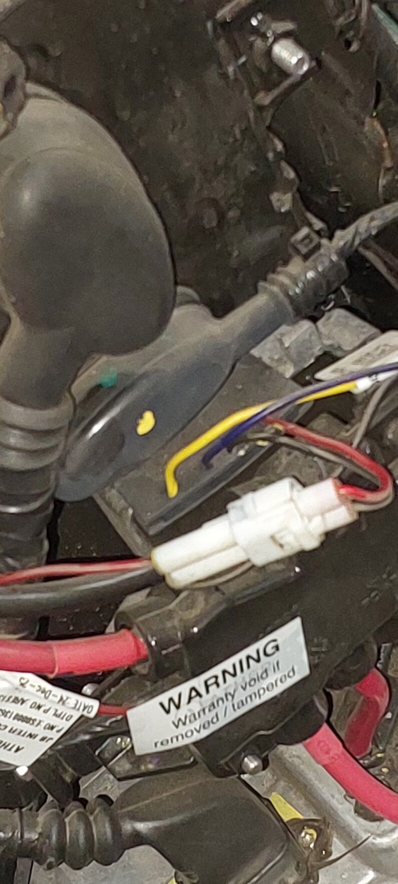

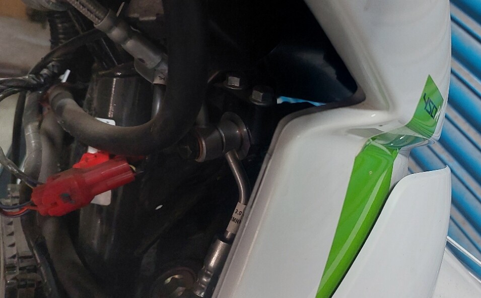

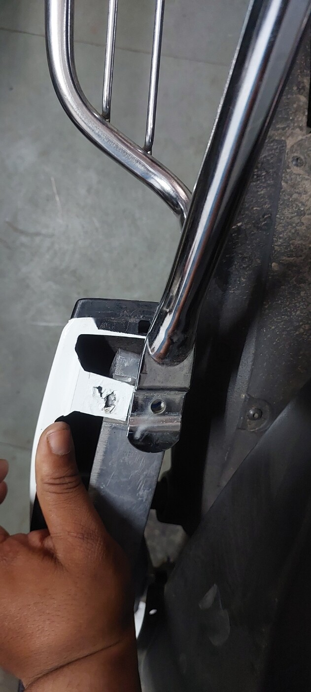

Here are the Pics showing quality control in their factory :smirking_face:
Rust in brand new scooter
unfinished paint work
sticker hanging
New updated 48-12v converter fails the most, as per reddit and whatsapp groups

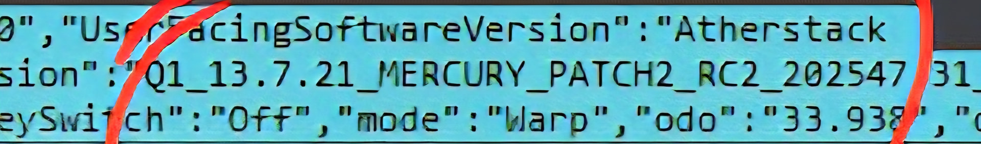

The processor in Ather 450x hasn’t been updated it’s the same snapdragon 212, officially confirmed and I also the same sticker problem,bought on 1week of Feb.
Nope. It has been updated.
The software version is Q1 =qcm2290 if it was sd212 then the software would start with N1
Showroom guys have no idea because Ather has not published the update yet.
