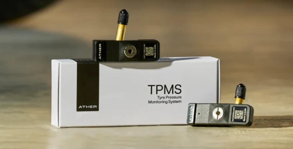

Which Ather Vehicles Support TPMS?
The official word from Ather is straightforward: the TPMS is compatible with Pro pack variants of the Ather 450 series and Rizta. Here’s what that looks like across the current lineup:
Vehicle TPMS Compatible? Notes
Ather 450X (Gen 3+) :white_check_mark: Yes Requires AtherStack Pro for smart features
Ather 450S :cross_mark: No hardware — not supported
Ather 450 Apex :white_check_mark: Yes Fully supported
Ather Rizta Z :white_check_mark: Yes Requires AtherStack Pro for smart features
Ather Rizta S :cross_mark: No hardware — not supported
Ather 450 / 450 Plus (Gen 1) :cross_mark: No Older hardware — not supported
Ather 450 (Gen 2) :white_check_mark: Yes Requires AtherStack Pro for smart features
Ather 450X Series 1 :cross_mark: No Pre-Gen 3 hardware — not supported
Key thing to know: The TPMS hardware (sensors + dashboard display) works on all compatible vehicles above. However, the smart features — app notifications, remote pressure checking, puncture alerts — only activate when you’re on the AtherStack Pro subscription plan.
Where to buy: shop.atherenergy.com/products/ather-tpms — ₹1,799 (installation ₹594 + GST extra at the Service Centre)

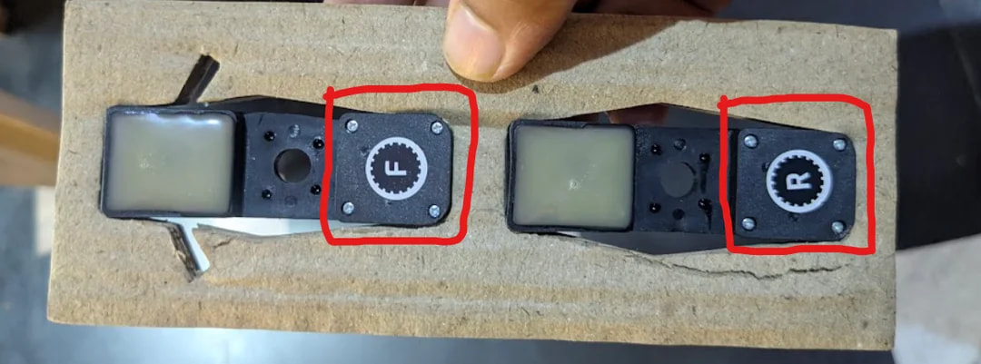

Ather officially lists the TPMS battery as non-replaceable, rated for 3–5 years. That’s fair for warranty purposes. But the TPMS is manufactured by Treel, and as you can see in the photos below, the sensor housing does have a standard coin cell inside — and it can be accessed.

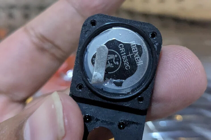

What Battery Does the Ather TPMS Use?
Based on a teardown of the Treel-manufactured unit, the battery is:
:battery:Maxell CR1632C — 3V High-Temperature Lithium Coin Cell
:information_source: The “C” suffix matters — it’s not a standard CR1632. The CR1632C is a high-temperature rated variant designed to handle the heat generated inside a spinning tyre during riding. This is why Treel specifically uses this grade cell.

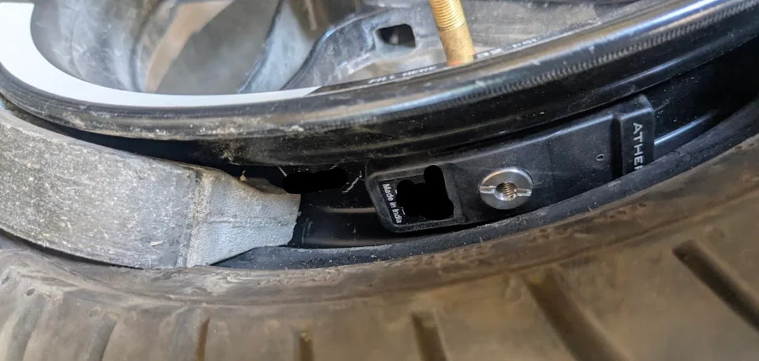

Step 1 — Get the sensor out of the wheel
The TPMS sensor lives inside the wheel rim. You’ll need a tyre shop or the Ather Service Centre to safely demount the tyre first. Do not attempt to force the tyre off the rim at home.

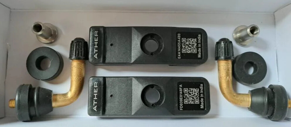

Step 2 — Identify the two sides of the sensor
Once out, you’ll see:

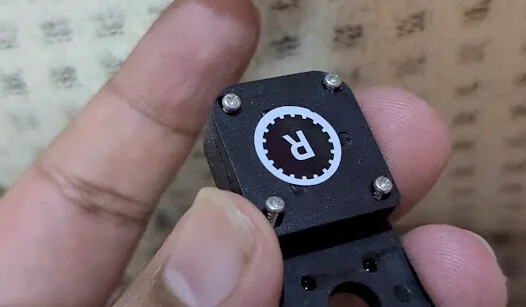

  • Front face (Image 2 above): The black housing with the Treel “R” logo in a white gear circle, held together by four small corner screws.
  • Back face (Image 1 above): The circular battery compartment with the CR1632C cell visible, sitting inside a rubber-sealed housing.
Step 3 — Unscrew the housing
Using your precision screwdriver, remove the small screws from the corners of the sensor body. Keep them somewhere safe — they are very small. The two halves of the housing will separate, exposing the battery.

Step 4 — Remove the old battery
Using tweezers or a non-metallic tool, carefully lift out the old CR1632C. Before removing it, note the orientation — the positive (+) side faces upward in this unit. A quick photo helps.
Step 5 — Insert the new battery
Place the new CR1632C (or CR1632) into the slot with the positive (+) side facing up, matching the original orientation. Press gently until it sits flat.
