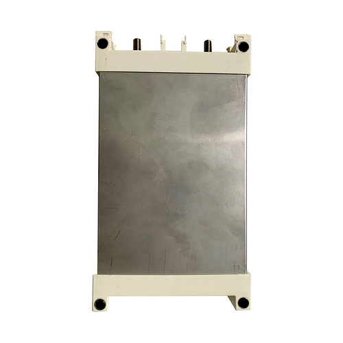

If some unknown Chinese company can build Lithium NCM battery cell with 3.7v 144ah or 530WH capacity at USD150 weighing only 2.8kg, then cells used by Simple Mark 2 from Japan could have exceeded the cell capacity several times. China company link :
Using smaller multiple 18650 or 21700 actually eats up lot of space, especially in two wheelers we have limited space. So it is better to use prismatic cells. Tesla’s Shanghai Giga is using CATL’s LFP prismatic for China build Teslas compared to 21700 usage in US build Tesla.
You can’t say it’s better for certain, because cylindrical cells have better heat dissipation because there is space between the cells. This has lesser chances of over heating in high performance conditions where the cells are under heavy load. Also tesla hasn’t wasted much space at all, they’ve made a very optimal cooling System for the cells in the space between the cells. Also there is one more advantage of using 100s of cells(ather) and 1000s of cells(tesla), that is that each cell is a small percentage of the whole battery. So even if one or two cells go bad, the whole capacity won’t be affected as much and the vehicle can still maintain most of it’s range. But in a prismatic battery each cell is a large portion of the battery, so if a single cell goes bad it will have huge impact on the capacity of the entire battery. Both these reasons will lead to longevity of the battery you can use it for a longer time before you have to replace it. All this comes at a loss of some space and range. Both have some advantages and disadvantages.
Also this battery you mentioned is less than 200 wh/kg and 300 usd per kwh which is heavier and more expensive than tesla current batteries at 250 wh/kg and 130 usd per kwh.
My 2017 build 14s 52v 42ah ~ 2184Wh Li ion pack was using the Japan cells in this link. These cells are 2016 Japan build. https://item.taobao.com/item.htm?spm=a230r.1.14.22.250256fbwmcyZ5&id=521974010818&ns=1&abbucket=16#detail
Battery pack weight came~9kg with dimension 240X160X130mm.
I built the pack for my ebike project. While using 52v 6 Amp charger the pack got full charged less than 4 hours. But I charge only 80% and once in 2 month do full charge.
Since large cells have large surface contacts between conductive surfaces cells don’t get heated up.
We are in 2020 and Japanese would have developed much better cells.
I had an eye on this LG 3.7v 60ah cell. I didn’t try LG as I faced cell bloating once with a LG cells. https://item.taobao.com/item.htm?spm=2013.1.w4004-13473707550.29.1bed27a9pDBoO3&id=606229794771
I will certainly try this big bear 200Ah 3.7v CATL for my future project.
