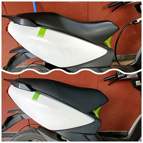

There is a concern about seat design. I really didn’t understand why the seat is tapered from back till front and it has some slope in front starting from halfway from pillion seating. This is causing the rider to slide front while riding on a bumpy road or uneven finished road (I want to be clear when I say bumpy road, it means there is proper tar road, but it is not flat and driving speed is around 50 to 55kmph). Specially the stretch (both sides of the road) from Makri circle to cant. railway station via Jaimahal road.
