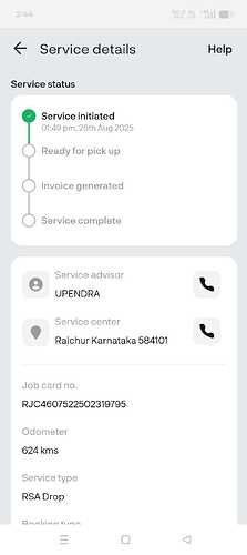

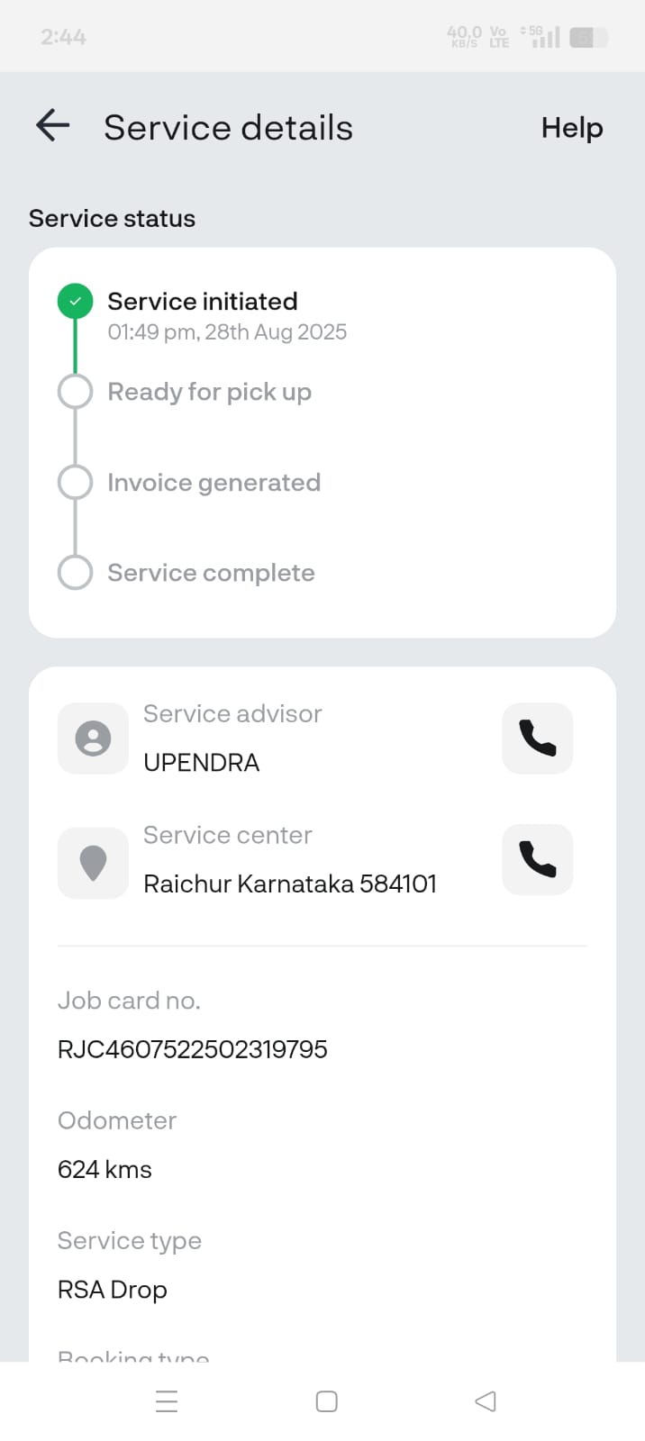

i sent vehicle for service on 28th of august, but still service is ongoing, kindly help me.
