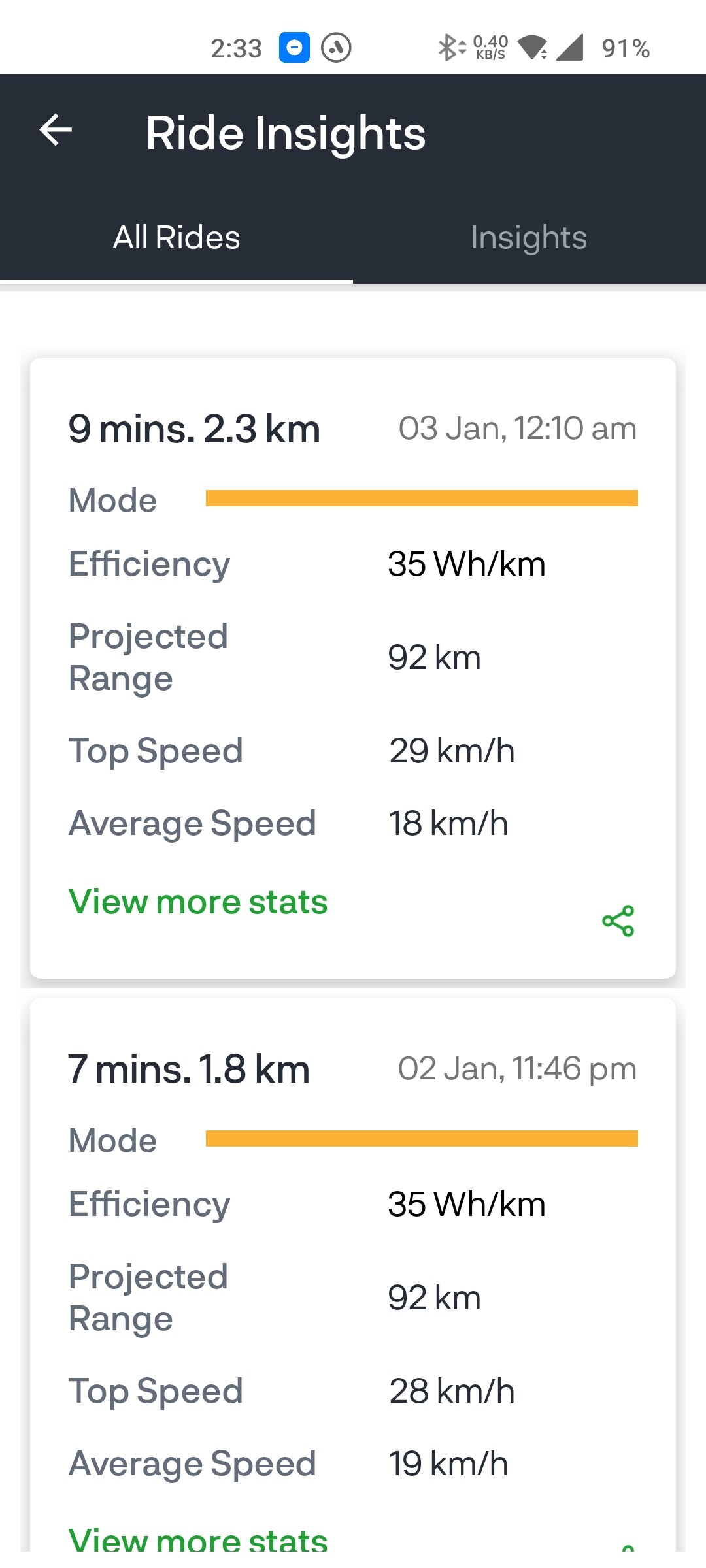

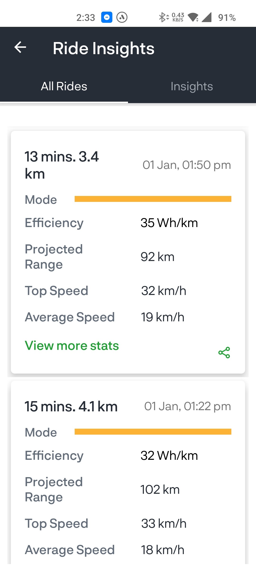

I travelled today morning around 3km with 15avg speed and max speed was 45 and in 3km it went down 5% I don’t have ride insight as phone was switched off :smiling_face_with_tear: I will travel in evening I will show that screenshot

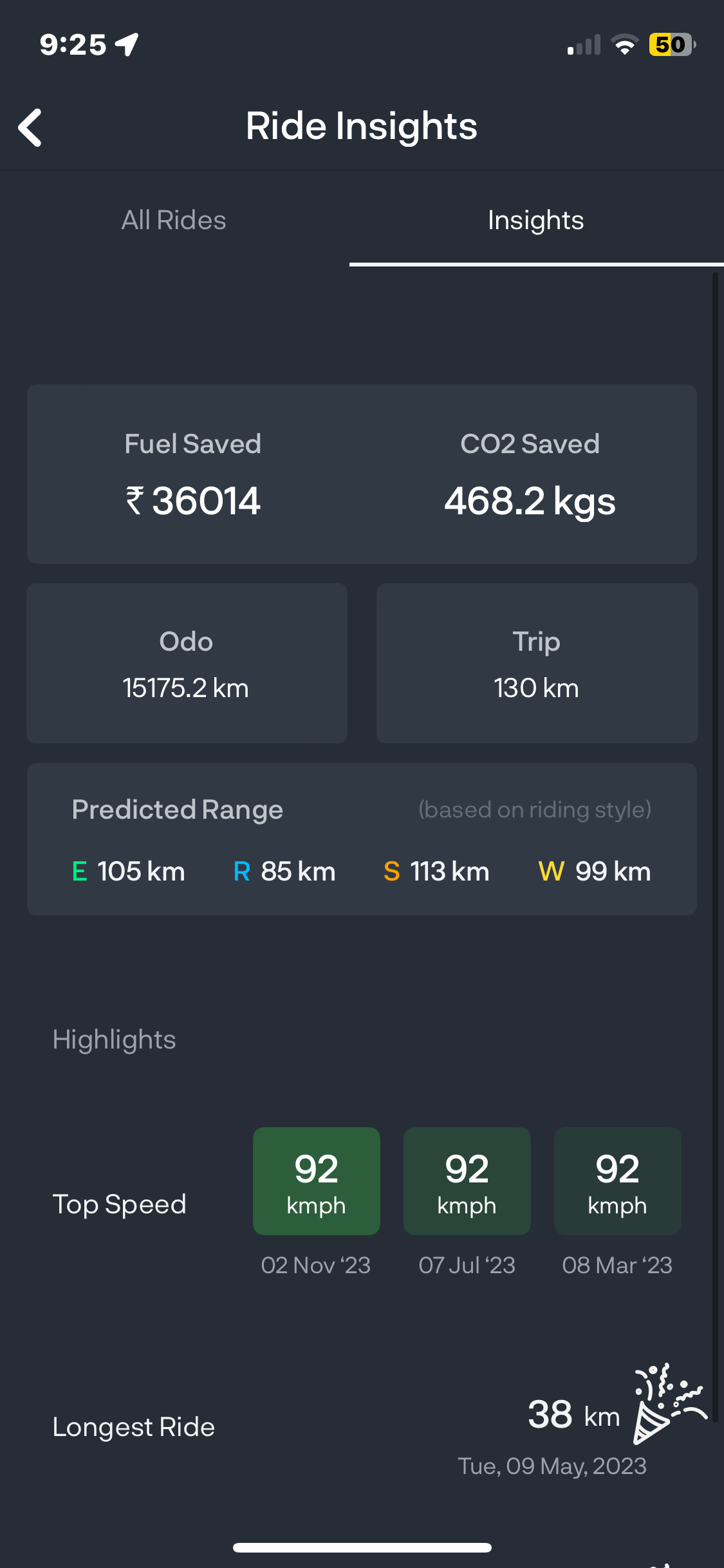

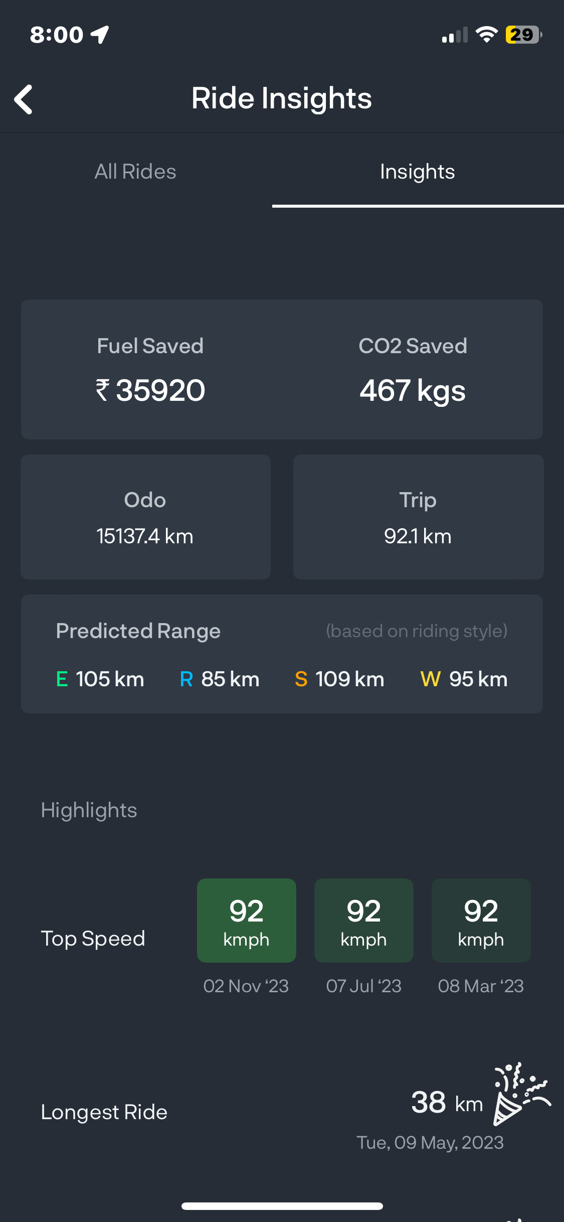

Here you go. Consider last 2 rides as one. And the first one is my return trip.
On the first ride, I took a wrong left turn and wind up 16-17 Km in wrong directions, hence the trip distance is more :sweat_smile:, plus I had to switch modes as the road was very poor and didn’t want warp mode as it gives power surge in every bump.
Second ride was smooth.
Edit: More info, along with helmet and other riding safety gear, the weight would have been 80+Kg and I checked the air in the tyres before riding. I’m not very patient person like many record breakers in the community here, plus it was 180Km ride so kept my speed between 55-70kph.

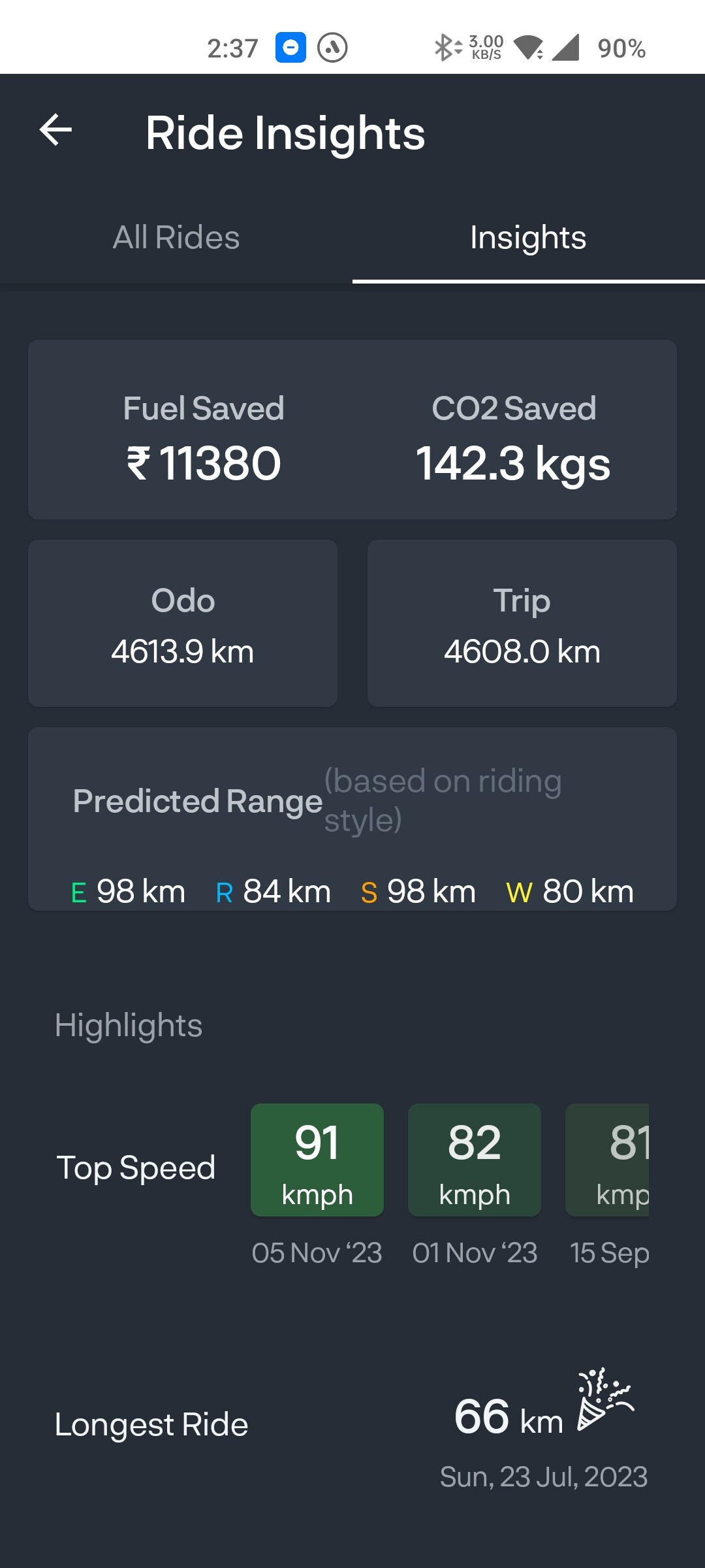

My projected range eco mode vs sports mode :joy::joy:

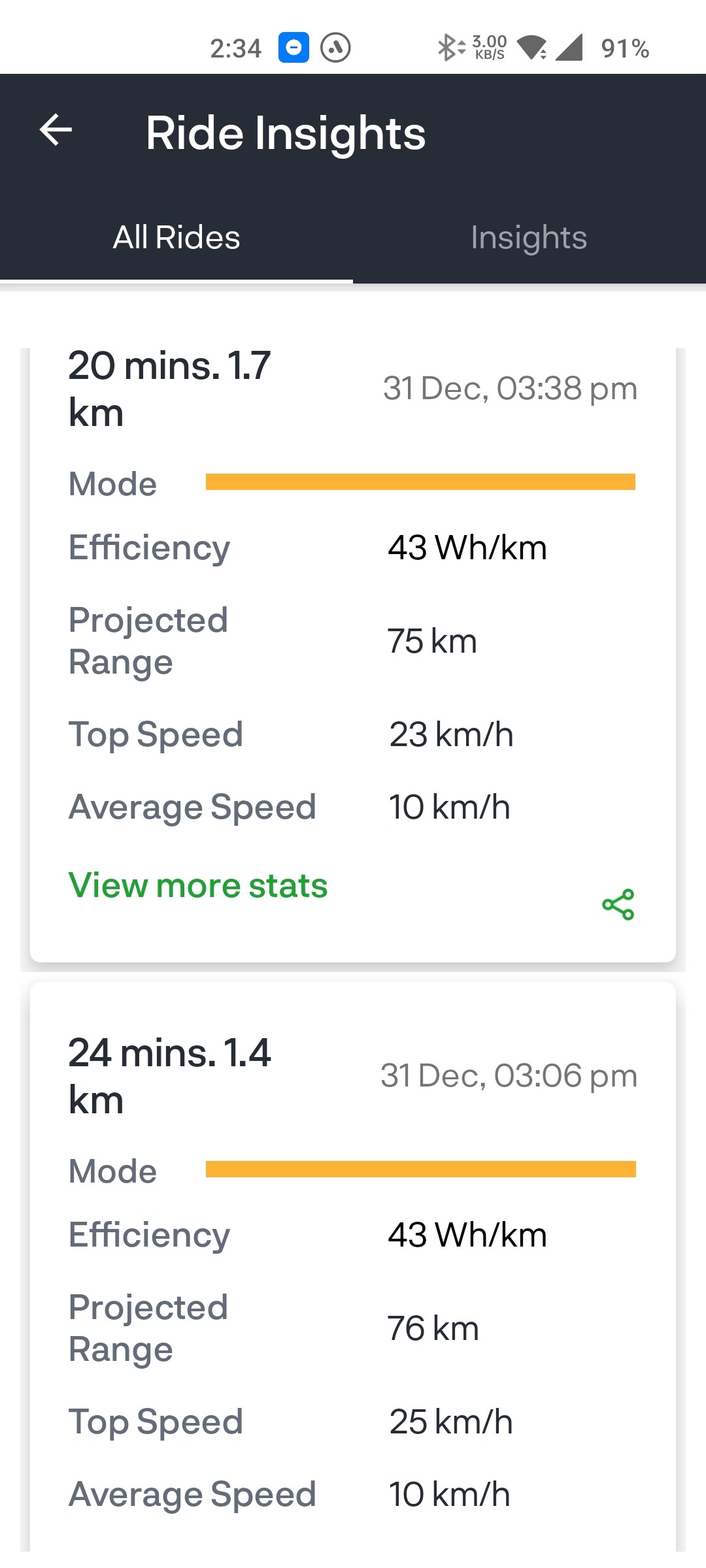

Something’s definitely wrong with my Ather. Even when driving at ridiculously slow speed, getting such a high power consumption.
Just 6 months old.
Get it checked at service center. This doesn’t look normal :sweat_smile:.
If they don’t find any issue they might ask you to leave the scooter with them for range test and other stuff which might take 2-4 days. Just FYI.
