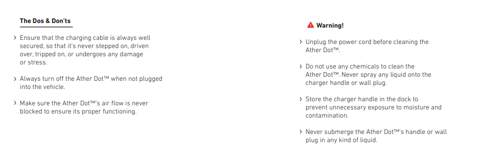

Does it mean that the DOT is atleast IPX3 class rated?

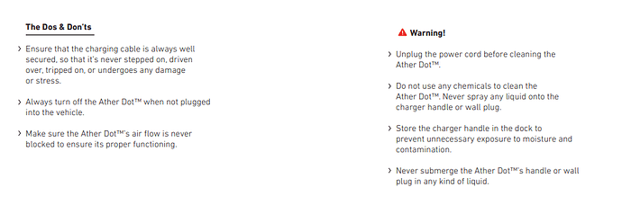

Regards to the chargers, there is no IP rating mentioned . Just that the home charger has an additional cover, it will have higher resistance than the portable charger
So it means that the customer is technically carrying a DOT charger (without the outer casing).

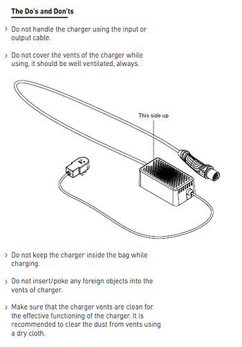

Hi all, I recently purchased 450x, just had a clarification regarding portable charger.
Due to the theft scare i have this idea of charging my vehicle using portable charger by keeping it under the seat storage.
I tried this and i was able to just keep portable charger inside and both plugs and charging socket outside with seat locked.
Just want to know how safe it is to do this? Will this have an effect on the battery as its near the storage or the vehicle itself?
Appreciate your suggestions

My advice is never to keep the Charger in the boot space while charging, there is enough heat generated in the charger which if not vented may lead to component failure / short circuit over time.
Of course it’s not good. the same is mentioned in the Dot’s user manual
In the user manual of the portable charger, the ventilation part of it is stressed a bit more
