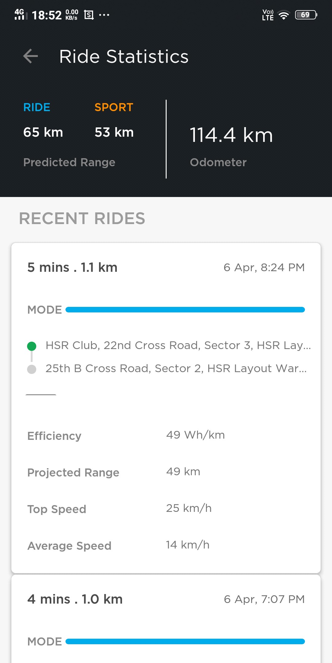

Same observation here too, from 6th Apr, Range and Ride Statistics have remain static.

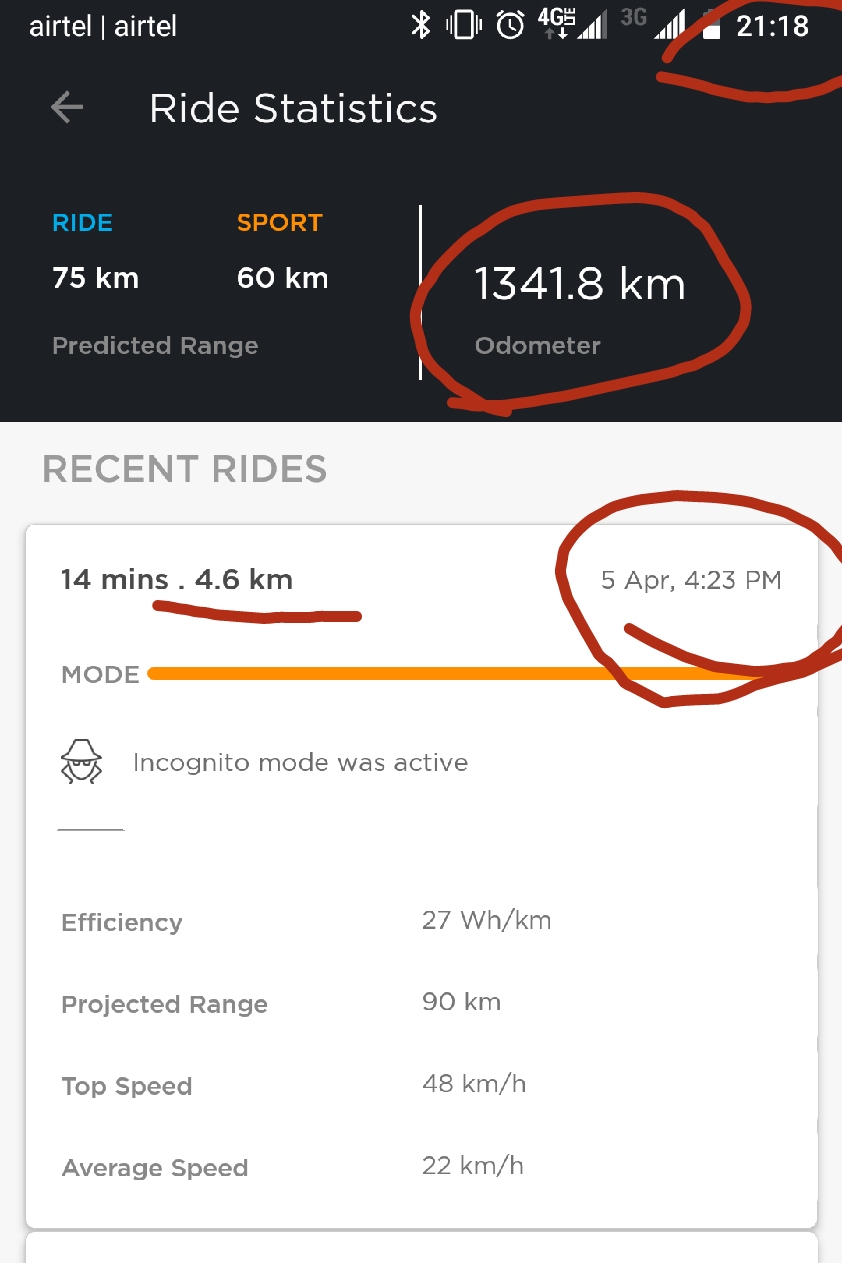

  3. what is the app for now? Only for checking charge? The navigation stutters, no forum, no offline map to finding charging points. The trip history function is dysfunctional. Bizarrely, the Odo reading syncs instantly; but individual trips seem to have their own agenda and timing.
    Just demonstrate what most here already know-
    Here are 2 pics taken at 9:18pm
A) Console shows the latest trip completed at 9:18pm, 4.1km, Odometer is at 1341.8km.
B) App only shows the trip taken 4:23pm, 4.6km, but magically Odometer reading is latest at 1341.8km.
How can syncing Odometer reading have next to no lag, but everything else either lags, or in case you shut the bike down as one would do overnight, never happen??
@Ather.Team @Shreyas will do well to give us a timeline (even if a slightly pessimistic one) on when these issues will be fixed. Please commit.

I am also facing similar issue. My last recorded trip was on April 6.
What the! You actually got the smart card?
Yes!!! KA03 reg
With this issue what I’ve observed is that whenever I’m using Mobile data the ride statistics don’t get updated. Only the Odometer gets updated. But the moment my phone gets connected to WIFI at home I get the data dumped to the phone.
I know this makes no technical sense but this is what I’ve observed in my case.
Today, for the first time, my morning ride to office did not show up. All the other rides are there including evening drive back home!
@karthikr1995 may have to do with internet speed. My odo gets updated, but the ride listing takes its own sweet time. I notice the delay in other apps like Twitter and Instagram too.
After 6th April, with a gap of 3 days my last leg of journey is now updated !
