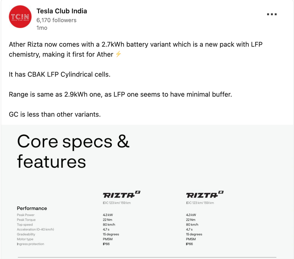

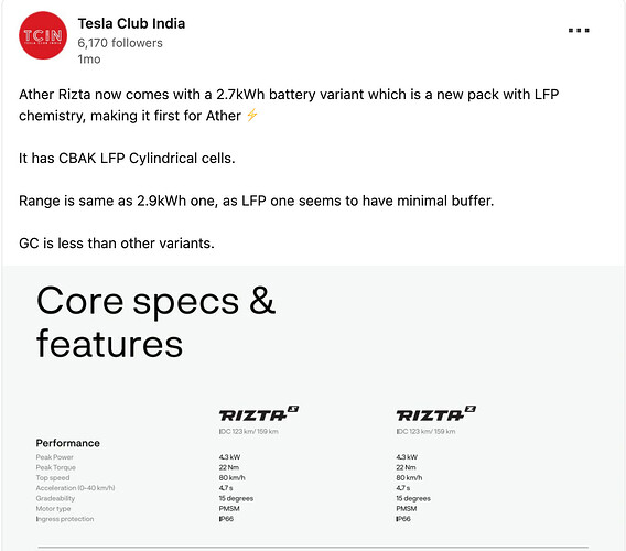

New LFP battery pack on Ather Rizta 2.7
Why is this still held being a secret ? Customers are furious thinking they got the inferior when in reality they got the much better model.
The marketing team missed an opportunity to make this a key product highlight.

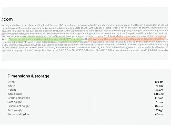

NMC Rizta - 119 KGS. — 2.9 kwh
LFP Rizta - 125 kgs——2.7 kwh
LFP batteries less power to weight ratio than NMC batteries. Because of that weight increase instead of lower capacity
They also reduced ground clearance by 1.5 cm in 2.7 kwh variant.
Even though it’s had less ground clearance ,it doesn’t scrap on speed breaker ( even when carring load75 kg ) .

LFP has no buffer so technically LFP 2.7 will get more range than 2.9 NMC, but the higher weight probably balances it out.
