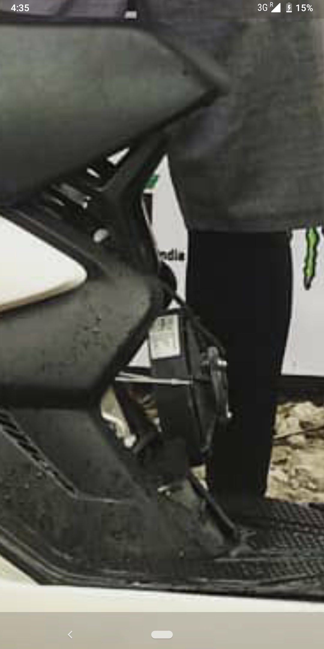

hello @Ather.Team what is this modification for ?
what is this meant for
Seems like a bigger fan for cooling the motor. It’s a Race tuned 450X so I think the motor heats up faster and needs faster cooling as well
so, do u think the output from motor will be 5kw constant
if that is the case even i want to know how to do that for weekend fun
