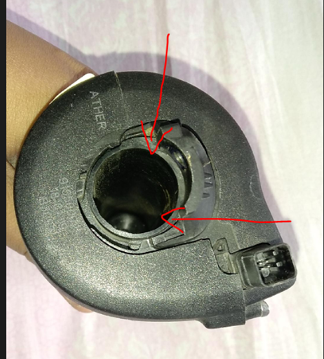

Here are the steps to do it without sending it to the service center as onsite tech did not know how to do it .
1-Remove the 6 screws holding the front touch panel and switch housing.
2-Then remove the screw as below
3- Remove the throttle connector cable (gently pull it out holding the connector firmly without holding the wire)
4-Blow air using a air pump that is used to fill air to cycle or bike tyres or by using a vacuum cleaner and gently wipe with a dry waste cloth and inspect for any visible dust particles in the areas as below. ![3|250x500]
5- Check the throttle to see if there is any squeaking noise , it should not have any , if you still hear some noise repeat steps 4 and 5.
6- Put back the throttle assembly on to the handle bar and put back the cable connector and then the screw.
7- Reinstall the dashboard and put back the 6 screws.
Throttle service done.
