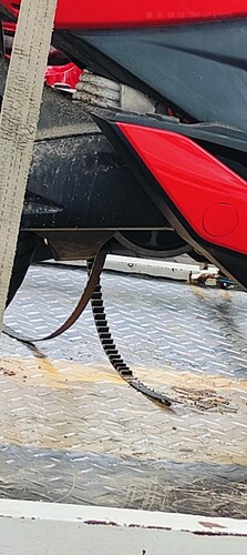

Model : 450x ODo : 8000kms Daily usage : 20 - 25 kms
Issue : Suddenly Belt is wearout & cutted while Driving

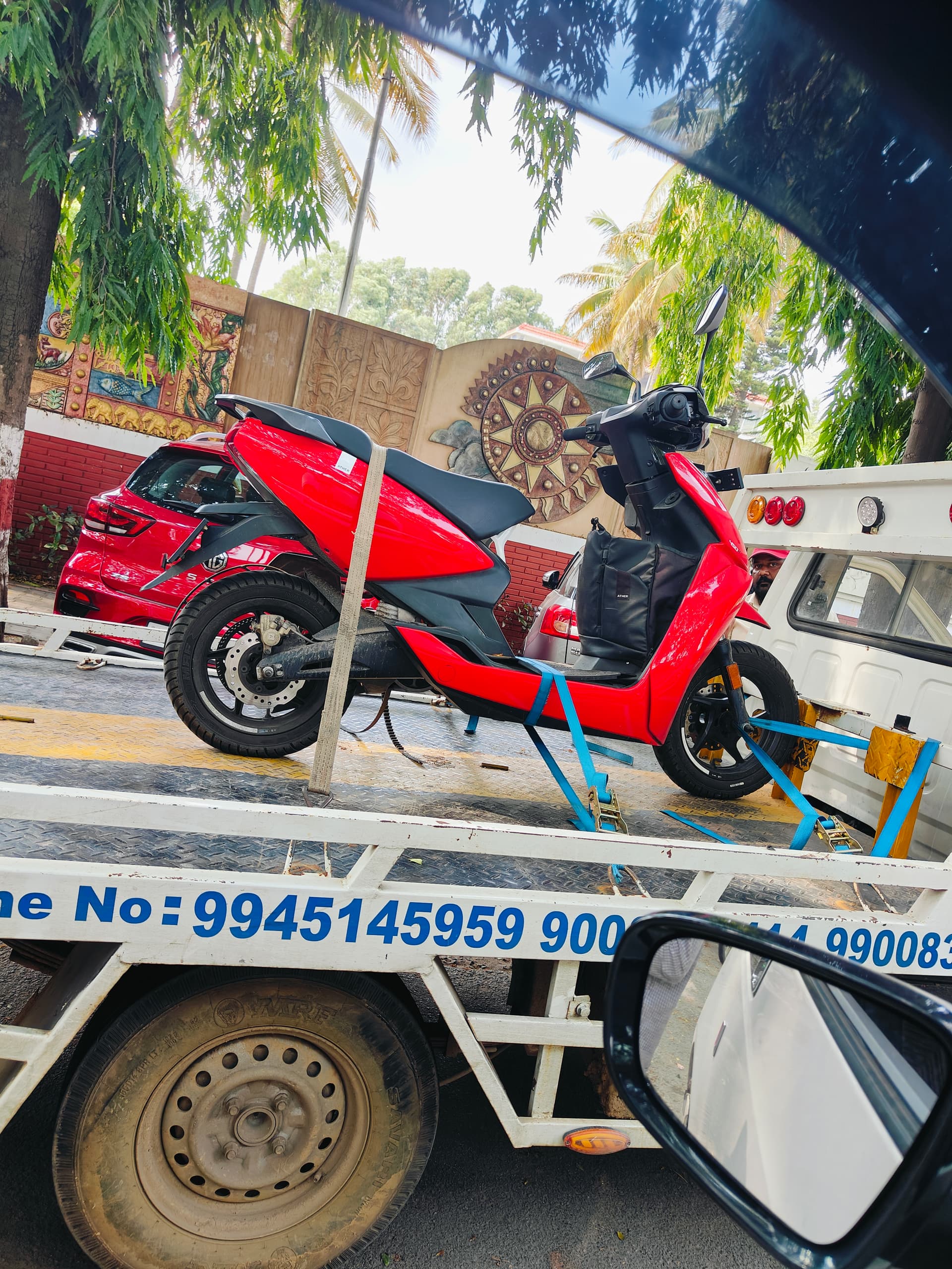

Scooter Suddenly Stoped while coming to office and safely parked to Road side ( it’s a luck there is no much vehicles on the road @ 6:40am )

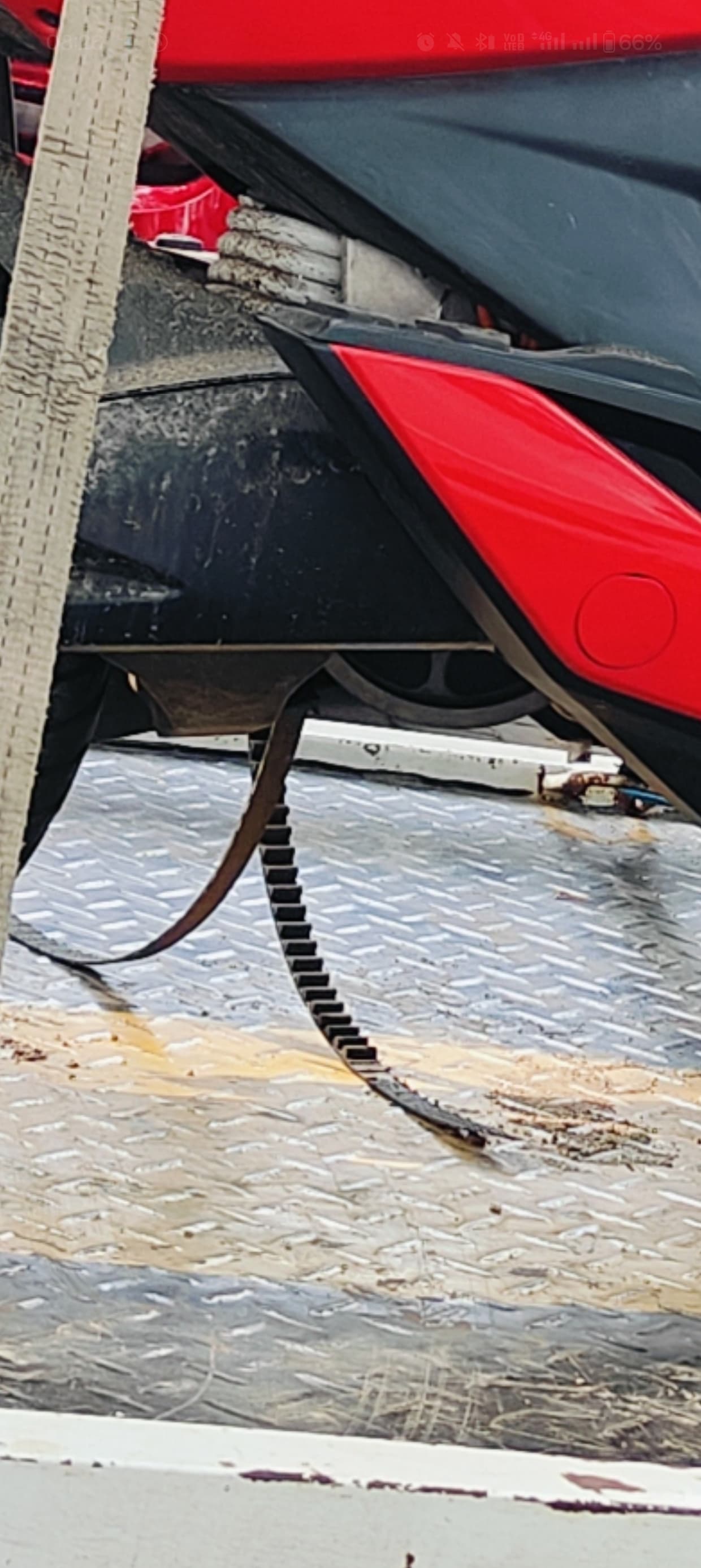

Observed : Acceleration is working Motor is running But wheel not moved At last found Belt is ware out & cutted
Action Taken : Called RSA & Scooter pickuped in 2 hrs .
Waiting for Technical / Service Team Reply
You will get Your Belt replaced under warranty. Since the Stock Belts has 20,000 KMs Warranty and After Sale Purchase of Belt has 10k KMs Warranty.

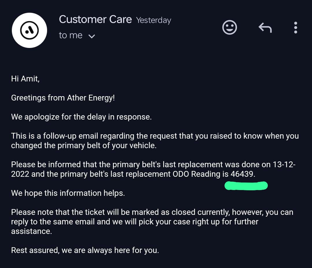

46,439 KMs Changed my Primary Belt :sweat_smile:
And It still Runs at 87,866 KMs :stuck_out_tongue_winking_eye:

46.4k to 57.4k KMs I used Sport as Primary. Then I changed my Battery and Started using Warp as Primary
This is My Second Primary Belt :2nd_place_medal:
Stock was lasted till 46,439
