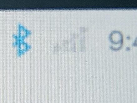

My scooter is on charging but it’s still not syncing with the app:
probably glitch in that screen only. In my case the dashboard shows correct range.
I also noticed that after update the network signal is gone. No network in the scooter anymore. even restarted the scooter but no luck.
Are facing the same issue?
No I am not facing that Issue. I saw all network bars on screen.
They really messed up the scooters with the buggy update. I hope there won’t be any issue with my commute tomorrow.
Are you sure? I can see there is no network at all in the charging photo you shared.
I didn’t paid attention to network when I clicked that photo but I restarted my scooter after that and I saw full network. But that could be for few seconds maybe. Because App is not syncing with the scooter so It could be because of the no network.

Hey, I was wrong! There is no network in the scooter:
