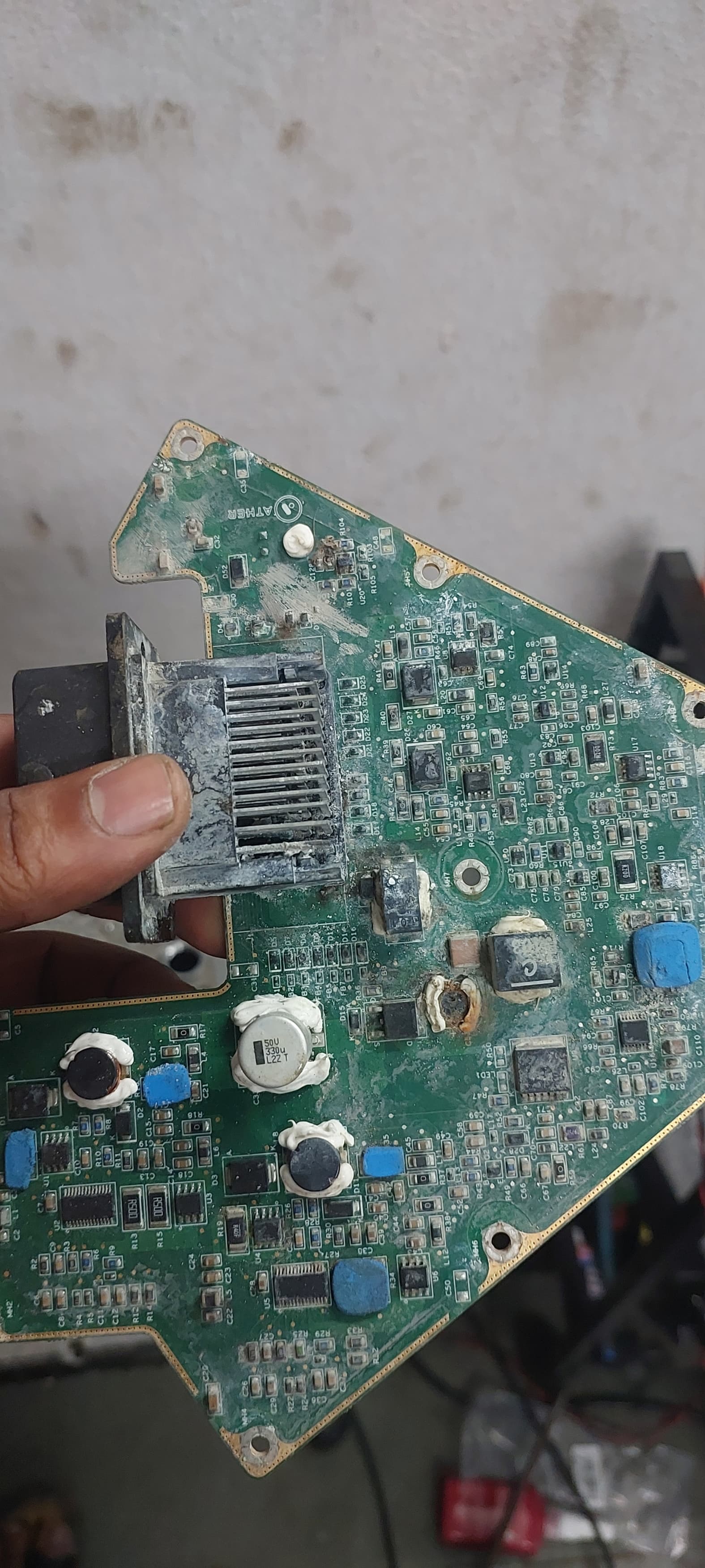

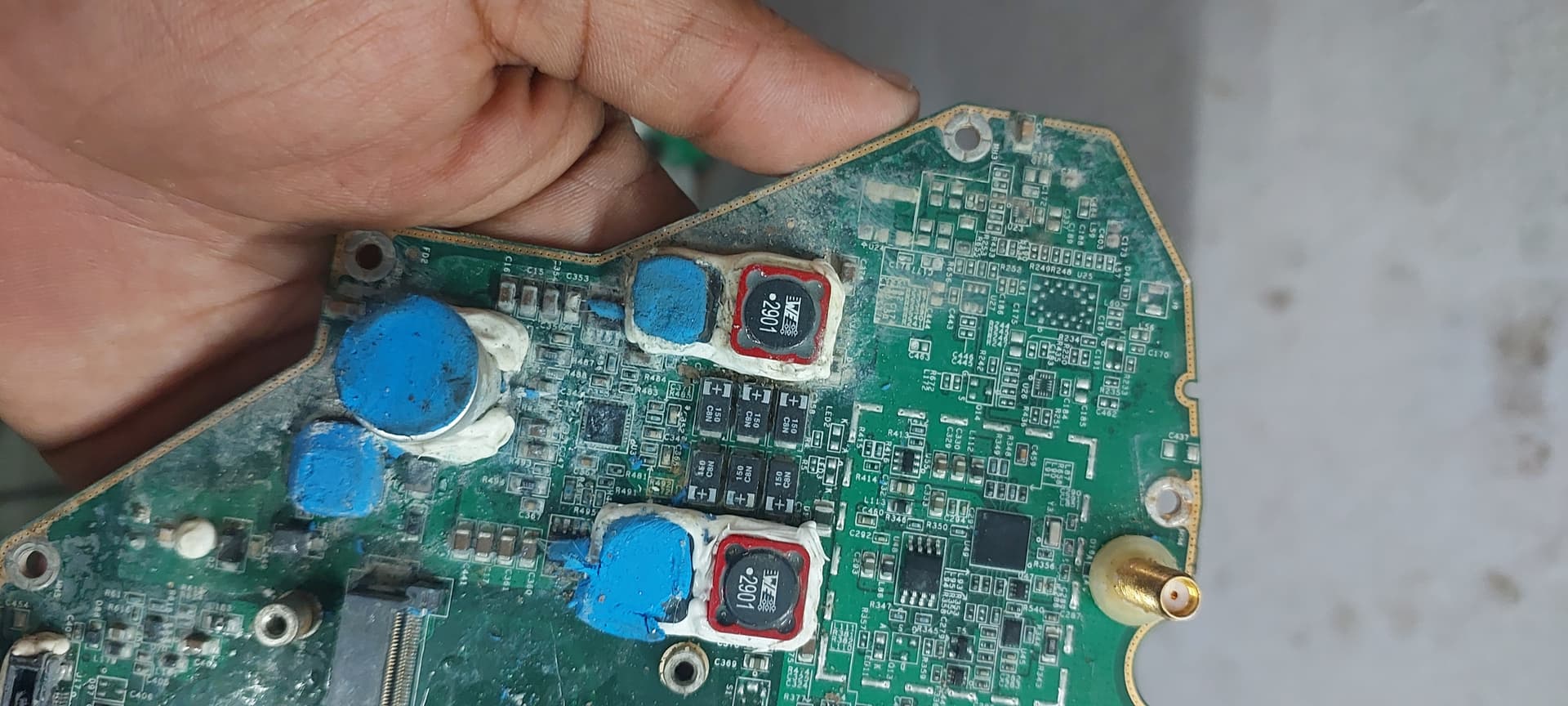

Here is the rest of the boards

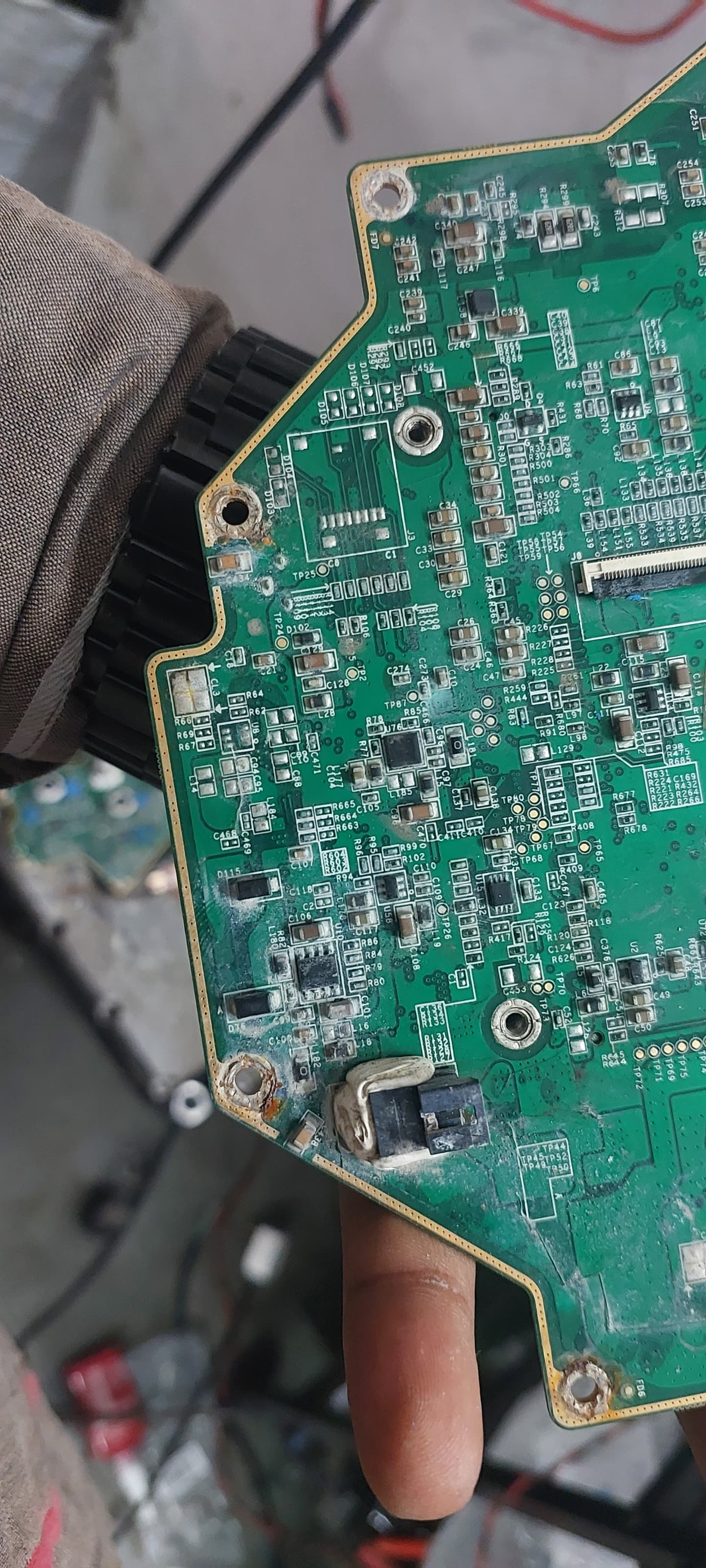

Main BCM motherboard and it’s Daughter board.
Front
Back

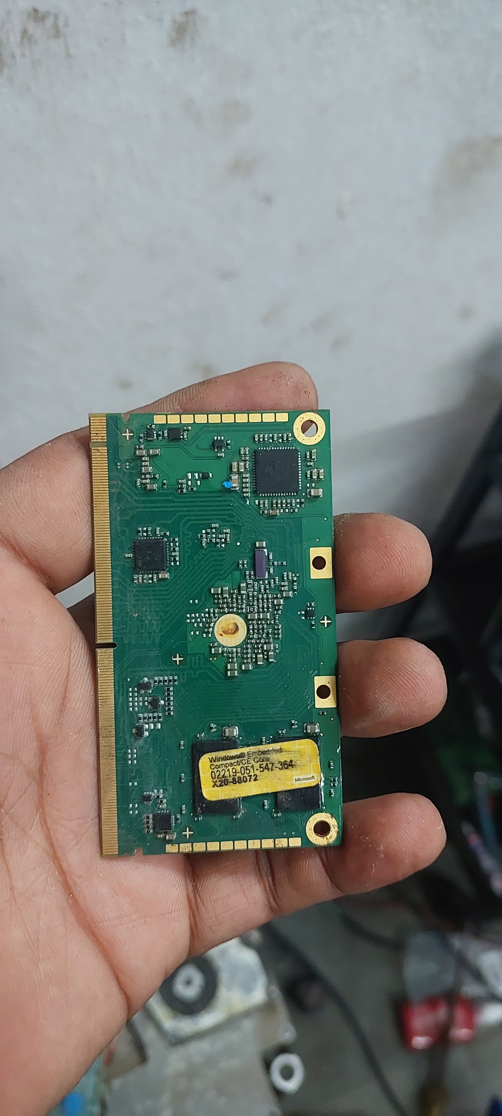

Daughterboard
SOC
Apart from SOC and BMS, every single board has mineral deposits. Looks like need an investment in buying an Industrial grade Ultrasonic Cleaner.

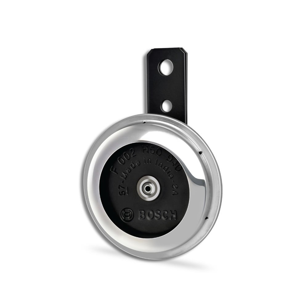

Can we for horn which comes with gen1/1.5 in gen2/gen4 are wiring harness or couplers changed? That horn is amazing.
All standard horns have universal connectors (spade female 6.3mm), but in Ather, there is a current limit. you can go for Bosch sharp tone, this horn is under the limit.
for some time I installed a Geniune Pulsar original horns in my Ather 450
What’s the difference between Bosch and Ather gen1 stock horn?
absolutely no idea, but I’m loving this horn. it’s appropriately punchy for pedestrian and to alerts other vehicle.
