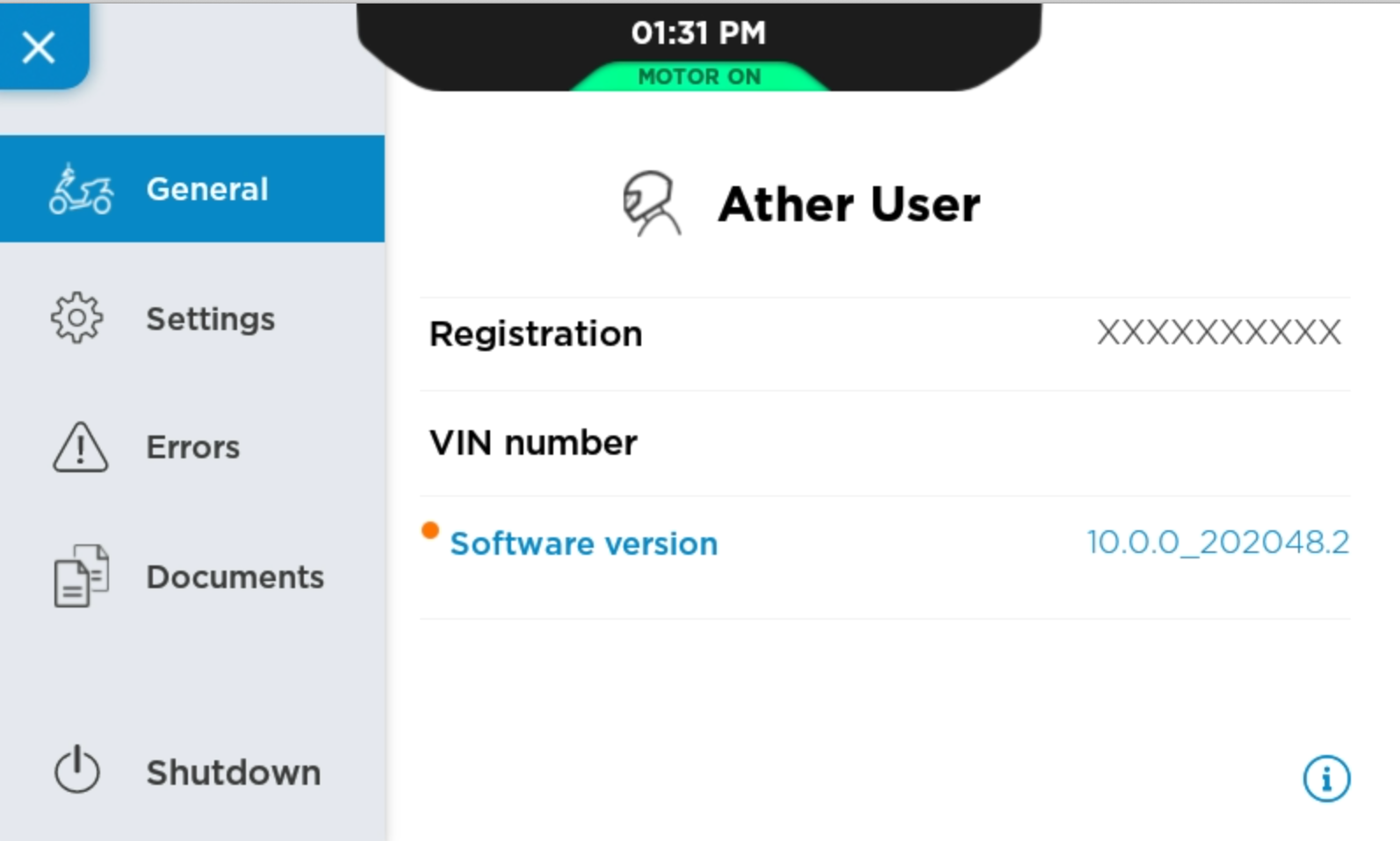

How to check if the OTA has been downloaded on your scooter?
  • Tap on the Menu icon on the top left of the home screen.
  • Go to ‘General’, the current Software Version will be displayed here.
An orange dot appears on ‘General’ whenever an update has been downloaded and is available for installation.

  • Tap on ‘Software Version’ in the ‘General’ tab.
  • You have two options to install the update — to install it right then or schedule it for later. The default scheduled time is 3 AM.
  • Tap on ‘3 am’ to pick a convenient time for installation or tap on ‘Update Now’ button. In case, no time has been scheduled, the installation will happen by default at 3:00 am, if the charger is plugged in.

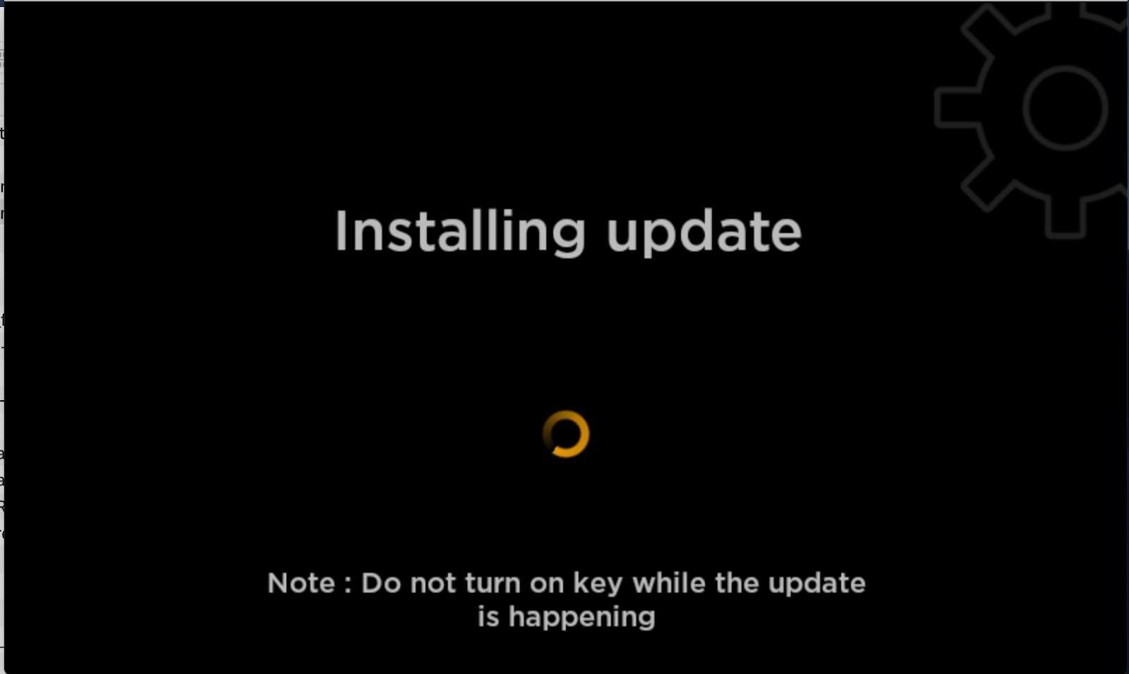

After installation
  • Turn the key ON once the installation progress bar fills up completely on the installation screen.
  • Depending on the nature of the update, sometimes you might see a screen that says ‘Completing’.
  • Once the installation has been completed, tap anywhere to dismiss.
