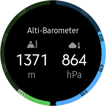

I stay at Shillong [1371m], whereas the dealer from which I purchased by scooty is at Guwahati (Assam)[25m]. I wish I could show you the exact figure :grin: Screen_20221118_172154

You didn’t get the point here. I edited the typographical mistake, not even the whole characters, you can get the logs from the Ather if you want buddy. I mentioned two cities and you can get their approximate sea level heights by any means you know of. I had also shown my approximate locational height from Gear S3 watch. Hope you are satisfied. My ponit here is driving down to the workshop/showroom is not a problem but driving up to my place of living is an issue. I took the delivery of the bike by going to showroom which is 100km away by road. I reached home at 4:25am after charging the scooty at two different locations. There is no grid charger in between you should understand first before writing. There is NO joke to what I wrote.
Hope you can see the screenshot I uploaded and understand the reading loud and clear.
Ya. Absolutely. The screenshot was loud and clear. The typed or typo part was soft and blurry :smile:
