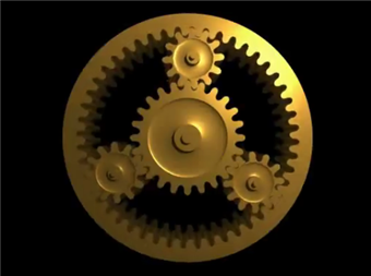

If I am right, the torque/speed ratio can be adjusted with current/voltage to a good extent. If it was the AC motor (like in Tesla car and with the inventor) AC frequency gives a better control. I think the gear system in most e-drives is as below.
internal-gear-and-planetary-gear-set
There are also CVT variants of this and don’t need a clutch because there is no constantly running ICE engine. In general like told above, only special applications require mechanical gearing. E-rickshaws being one because they use state of the art tech from history books that make them really affordable in the first place.
