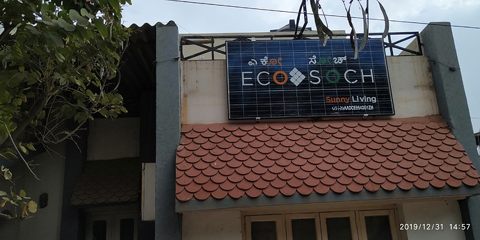

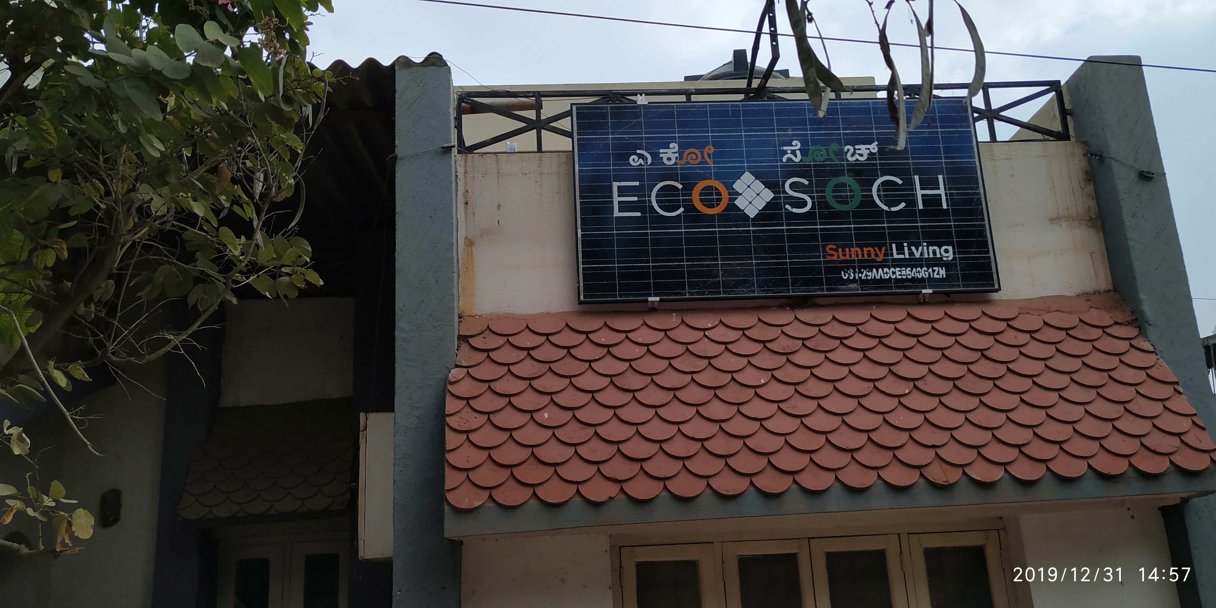

for people who are still looking for options in solar
have been there
good team and lots of experience, exp in on grid, off grid and hybrid installations
