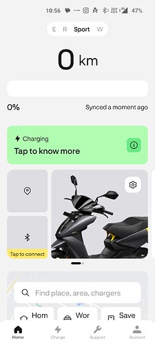

Do you want to say that after coming back, you first took a screenshot in sport mode at 70% and then in ride mode at 78%?:blush:
The range is not in percentage. The battery SoC is.
Don’t compare range as the mode turned into ride due to restart.
