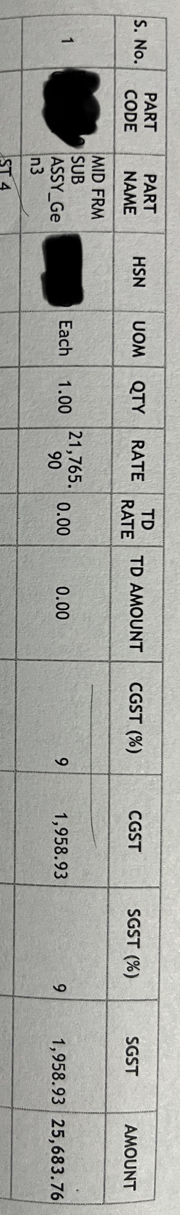

Hi what would be the replacement cost of Ather motors and average time frame of replacement?
The replacement cost is officially unavailable and you can always shoot a mail to info@atherenergy.com for any doubts or visit your nearest showroom.
Once i heard that the motor costs same as the battery pack. Maybe around 45000-50000.
I was told that the Motor comes with a frame + Pulley + primary belt
Just some lies to bill the customer more money
This was told by the service manager. They are planning to change my Motor Under warranty.
