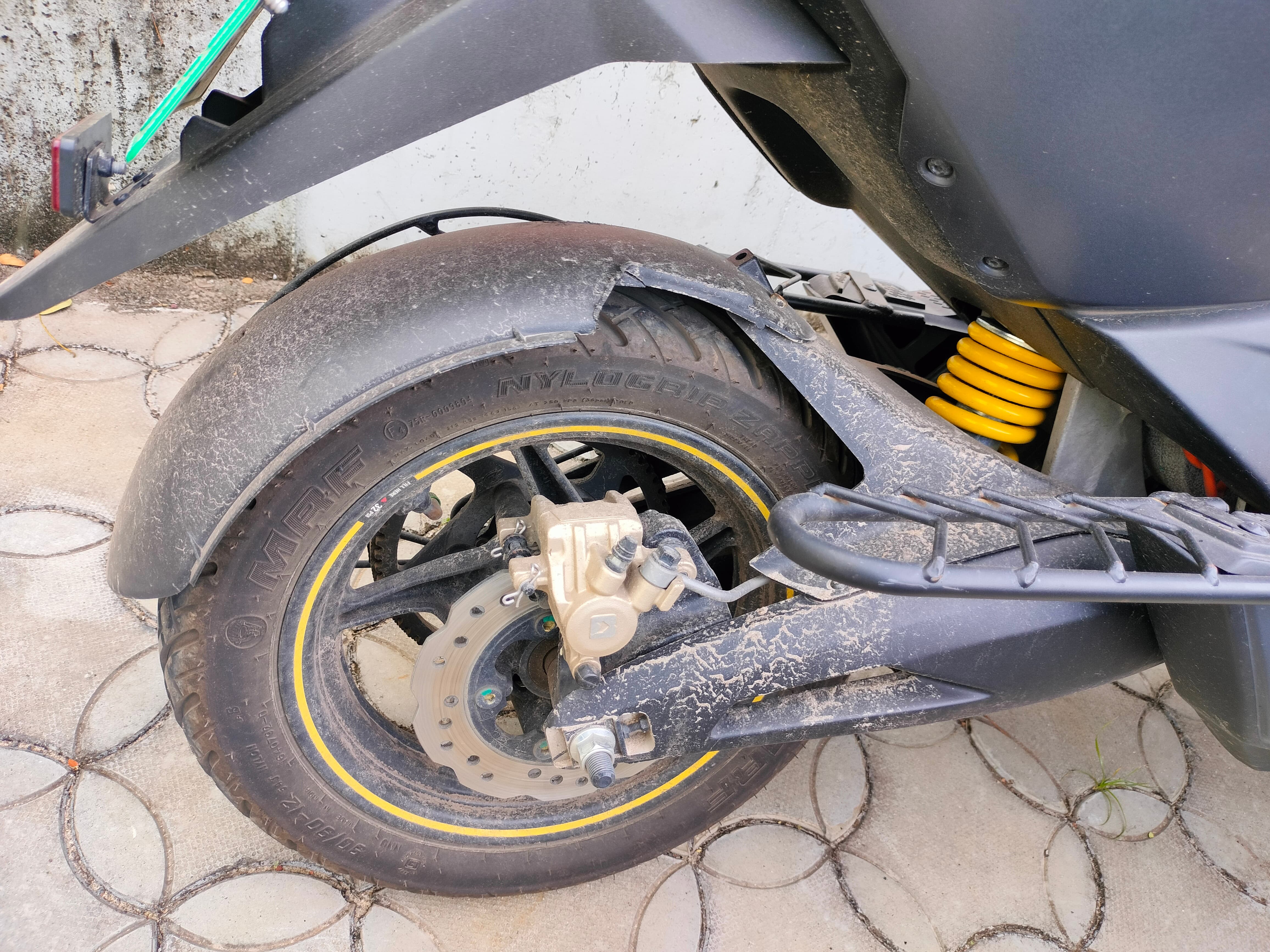

@someshau You can use Jupiter/Ntorq inner hugger to resolve mud issue in Ather EV.
Better one is Jupiter hugger.
Screw it on existing mudgaurd and give a support at tail end (on left side) to Saree Guard with a clamp & screw. So that its easy to remove whenever required.
Hugger may come around ₹.199/-. & expense to fix will cost arou d ₹.200/- to ₹.300/-.
Overall cost ₹.500/- max.
This is what i had done on my Ather EV.
Can you share some pics
Marked points where screwing done. Sorry that its dusty​:stuck_out_tongue_winking_eye: not washed vehicle recently​:pray::stuck_out_tongue_winking_eye:
Hope this is ok
Close up view of screw portion given below.

Problem completely resolved after this mod or does it only reduce the amount of dirt splashed on the pillion?
It resolve major issues such as mud splashing to pillion rider, mud splashing to Mono Suspension, & below seat areas. 99% issue get ride off. Side portions will be like same (i mean the both sides of rear wheel areas)

I have purchase rear mudguard from a guy for Rs. 1200/- plus courier charges, he lives in Ernakulam and can arrange delivery to anywhere in India. The new one has replaced the old one and has covered the wheel completely and is easy to fix. No additional nut fixing required. Just remove the old one and put the new one on.
This one done by @jineesh.m.m
