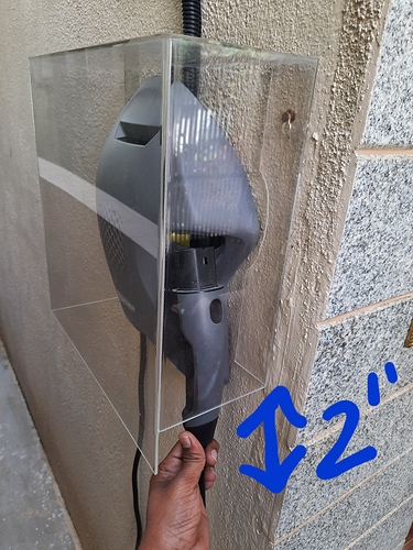

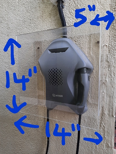

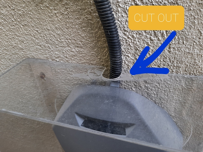

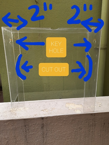

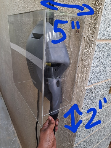

I have attached few pics of the Dot Acrylic box with dimensions.
hope this will help future DOT owners if they require one.
you can get the Dot Acrylic box made at BVK Iyenger road, there are many manufactures who can customize it in short period of time.
