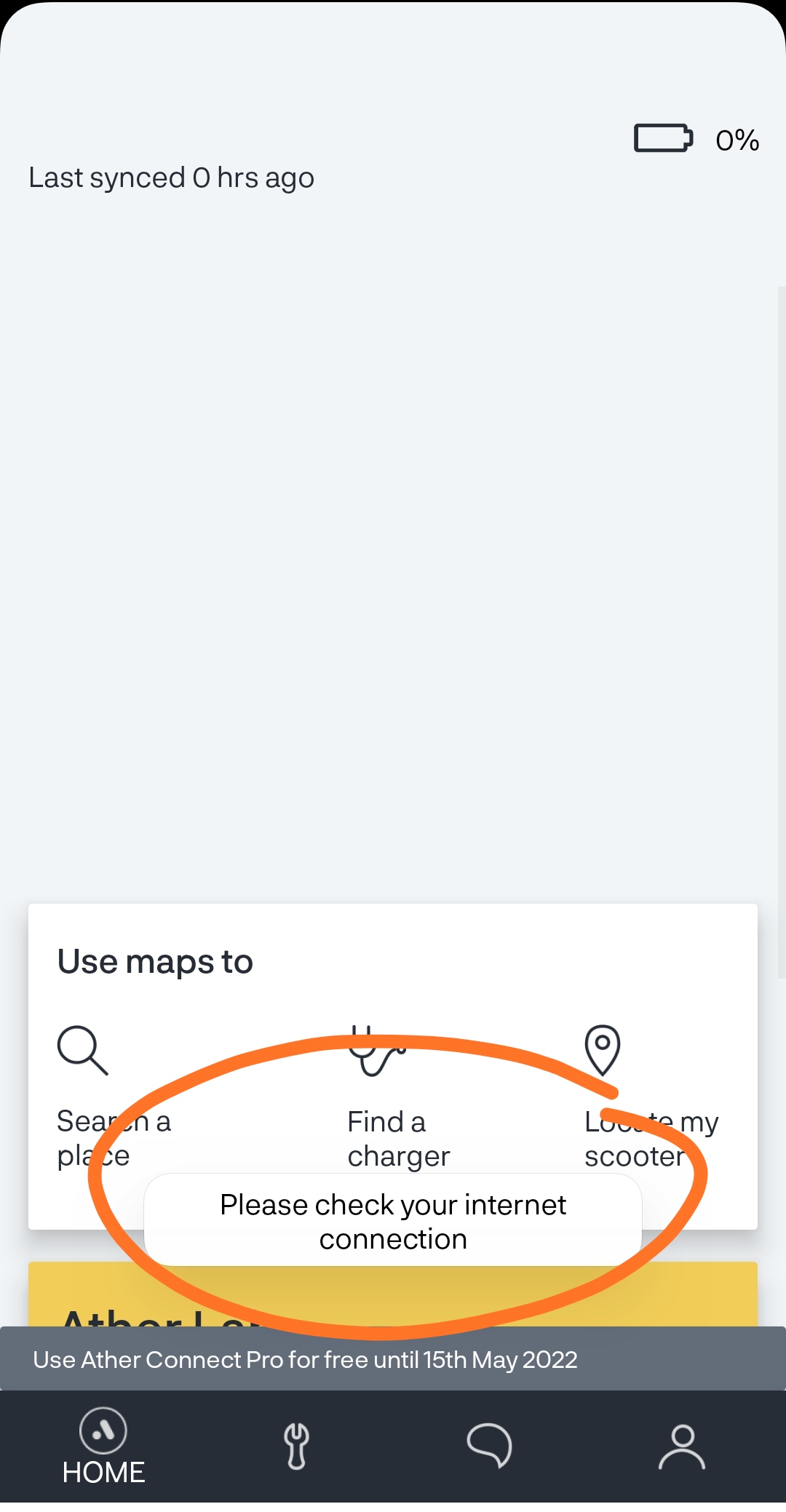

Ather app doesn't work on VPN
I have an always-on VPN configured on my phone. Ideally, I’d want all of the traffic to be routed through the VPN. But Ather app somehow doesn’t play well with VPN. It just says " Please check your Internet connection" when every other app on my oh one can connect to the internet.
Can someone take a look and resolve this? Right now I’ve to allow an exception for the Ather app which completely defeats the purpose of having a VPN in the first place.

Same issue here (on Android app). I have uninstalled the app for now.
Thanks, @DurgaSwaroop for creating the post. I had planned to debug the issue earlier but didn’t do it.
I debugged it now and I guess I found the issue. Ather Android app uses a function called isNetworkConnected() in com.athermobileapp.utills.NetworkHelper class. This boolean function likely tells if there’s a network connection or not.
For Android versions M and above (SDK_INT >=23), the function checks if the active network capability has transport of TRANSPORT_CELLULAR, TRANSPORT_WIFI and TRANSPORT_ETHERNET. But it doesn’t check for TRANSPORT_VPN. This is why when Ather app fails to connect to the internet (when VPN is enabled).

Awesome. It would’ve taken me quite a while to debug this. Good that you’ve already done it. Let’s hope they will update it soon.
@abhishek.balaji, Is this something you can get prioritized? It would help a lot of users that have “Always On VPNs”.
I see that the latest android app works with the VPN on. Can you confirm this @DurgaSwaroop ?
No, it still doesn’t work for me. I’ve v5.3.2 of the app, released on March 16th.
I still get the “Please check your internet connection” error.
