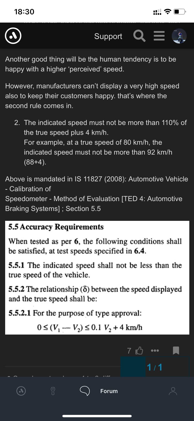

Hate to be the here. But you are actually doing 80 KMPH and not more than that. Or letβs says maybe a couple KMs above. How I wish we had triple digits on our Speedos
According to regulations, the displayed speed of the vehicle can never be lower than the actual(true) speed the vehicle. However to account for inaccuracies in measurement, variance in tyre pressure, tyre tread, etc, a safety factor is introduced. While our ideal top speed is 80kmph, the displayed speed at the same time would be around 87-88kmph.
Hitting a speed even higher than that can be attributed to tailwind, lighter rider weight and a downward slope on the road.
The regulations have set β¦

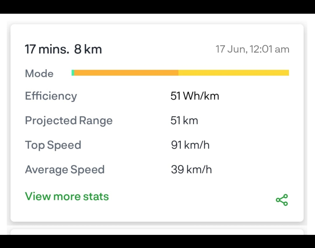

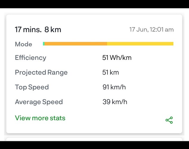

As a 400 cc petrol engine to 450x electric motor.
I can assure Ather is way more powerful.
Here is the proof
