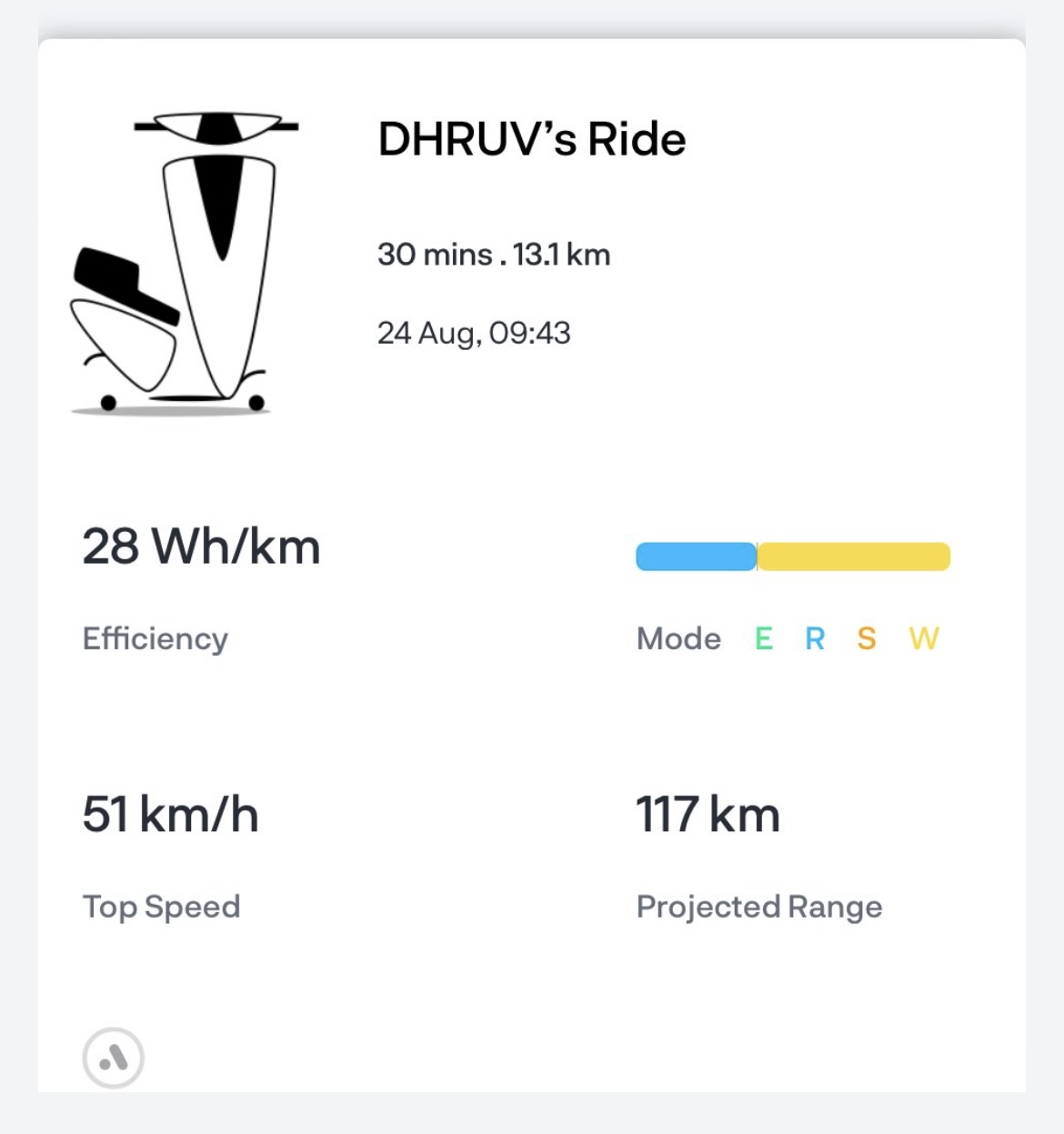

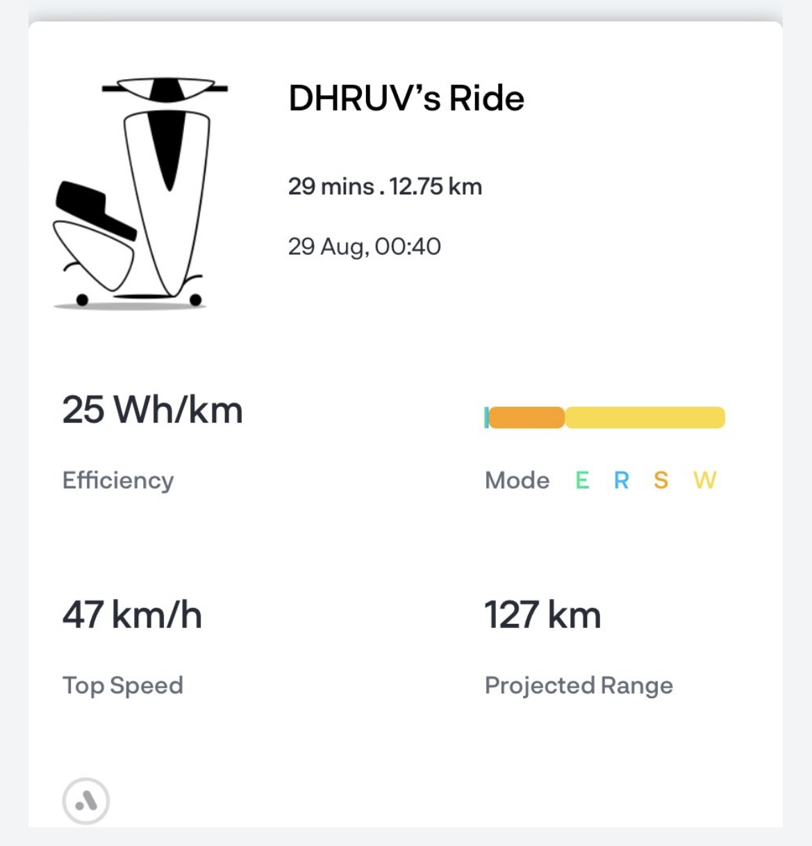

And yes I remember right now that the ride screenshot taken from the original one of mine shared over here and which you cropped and share was a ride with my wife and 2yrs old kids towards somewhere.

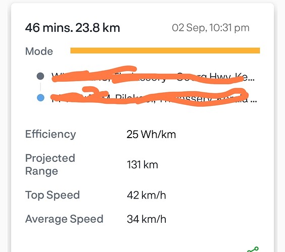

The ride log I shared, was one of my rides from last night. Not sure what you mean?
Oh Sorry then I thought it to be mine ride log…

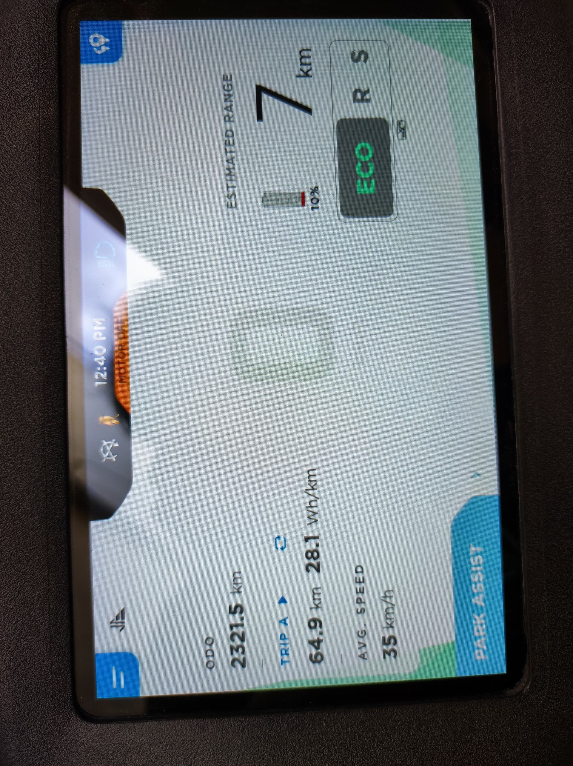

Today I had driven the vehicle from 100% , it’s 2 hrs continuous journey.
Dashboard showing 28.1 Wh/Km, which means 2200/28.1 = 78 Kms But I m getting only 72 Kms range
Why ???

No, he rode it full 100% to 0% but could only cover 72km. Avg efficiency was 28Wh/km. So he should have been able to ride 78km since it is Gen 2 450+ with 2200Wh capacity. Issue is with the mismatch between energy used and battery capacity reduced.

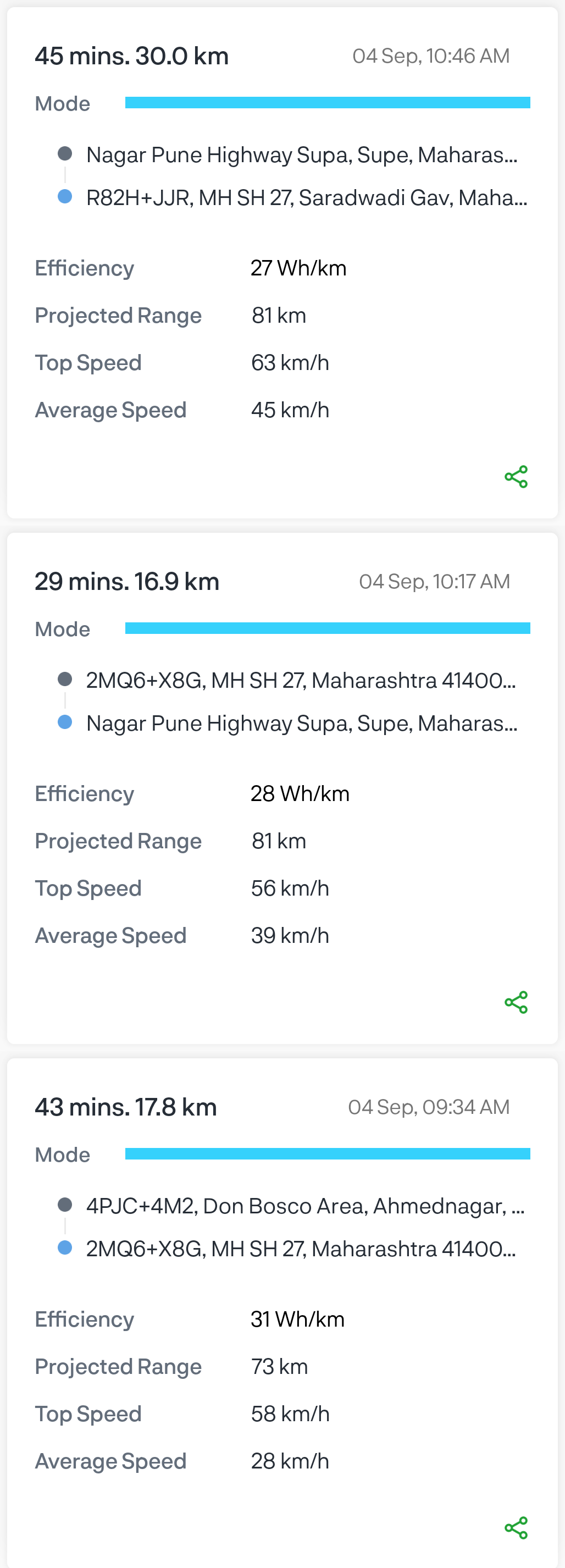

I drove on the same route in Ride + Warp Mode (twice) & Sports + Warp Mode. Warp was used on highway speeds maintaining speeds of around 45-46 kmph. These are the results of driving with good control over throttle & braking. I achieved the best efficiency with S+W combo & much easier to achieve better efficiency.
Ride + Warp Mode:
Ride 1: (10% drain)
Ride 2: (11% drain
Sports + Warp Mode: (9% drain)
