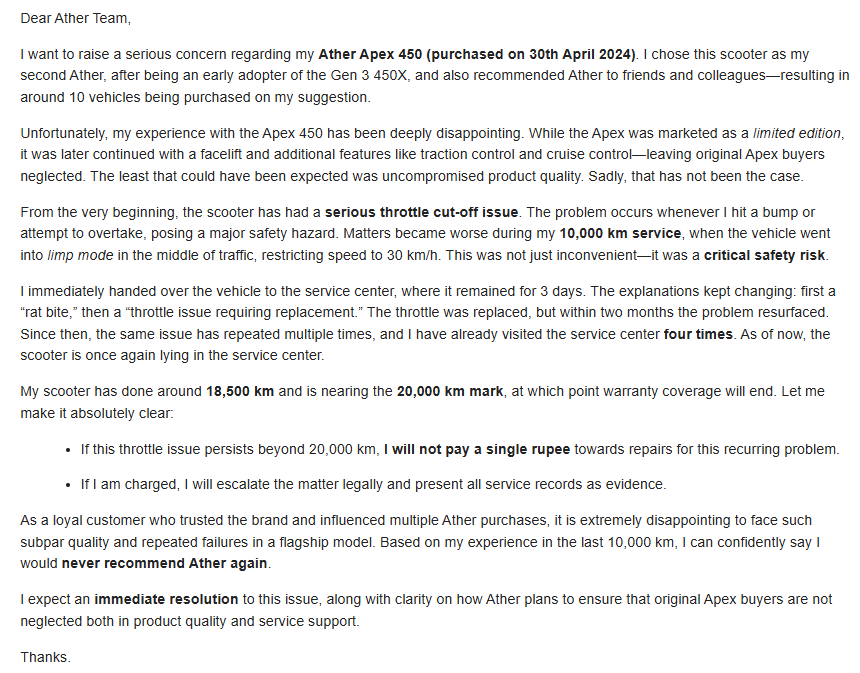

I am facing the same issue mine is 20 km driven vehicle 450 x but service center change throttle assembly and Ather drive controller sub assembly. I had given 3 times but issue exists again and again.
Ather should acknowledge that there is an issue with their new throttle equipped with magic twist. Mine was also replaced at 8k kms, although the SC did not charge any amount.
Atleast acknowledge the issue so that users aren’t confused when their scooter has erratic behaviour.

Emailed to customer care and posted in twitter, now posting here. Went for throttle issue 4 times , now its 5th time. Still they are researching my vehicle. Request everyone to raise this throttle cut off issue in public forums, its really a safty hazzard. @tarun
