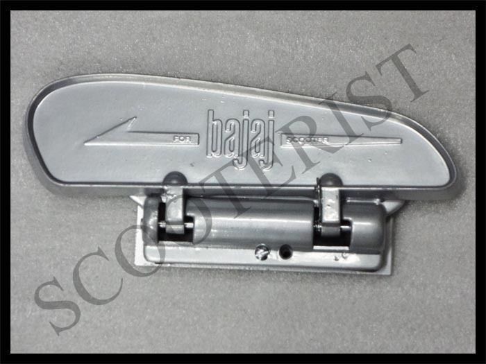

for a sidestep, you can look for the one fromold Bajaj Chetak, which had a good decent foldable sidestep. this can be adapted to your current models.
