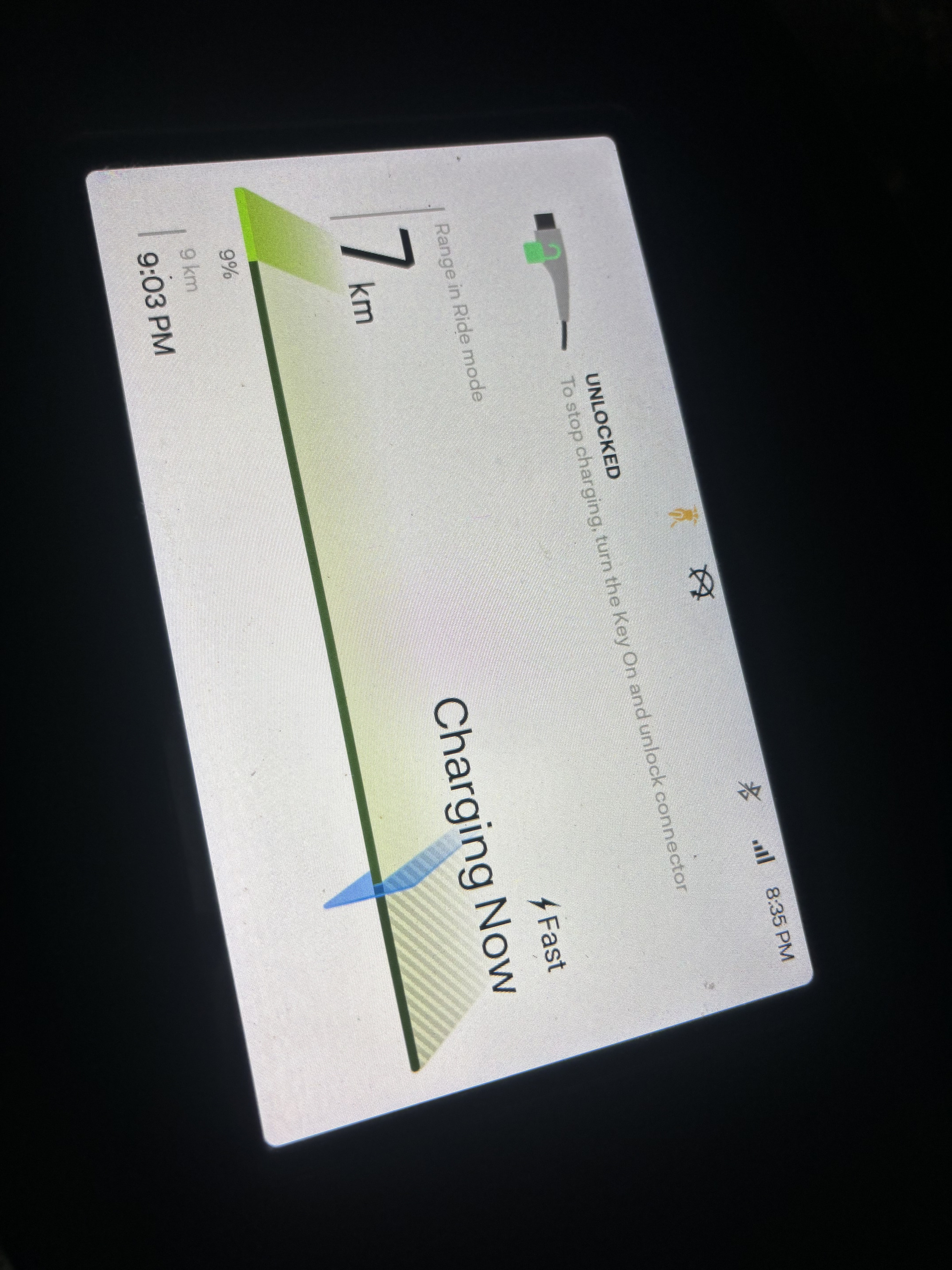

Charger is not locking every time i put my Ather for charging it always shows Unlocked Processing: image.jpg…
You need to really push the charger in the socket till you hear a click sound. That confirms that the charger is locked. Try restarting if its still not happening
I too faced it, you need to push the charger inside so it locks properly until you hear a sound.
