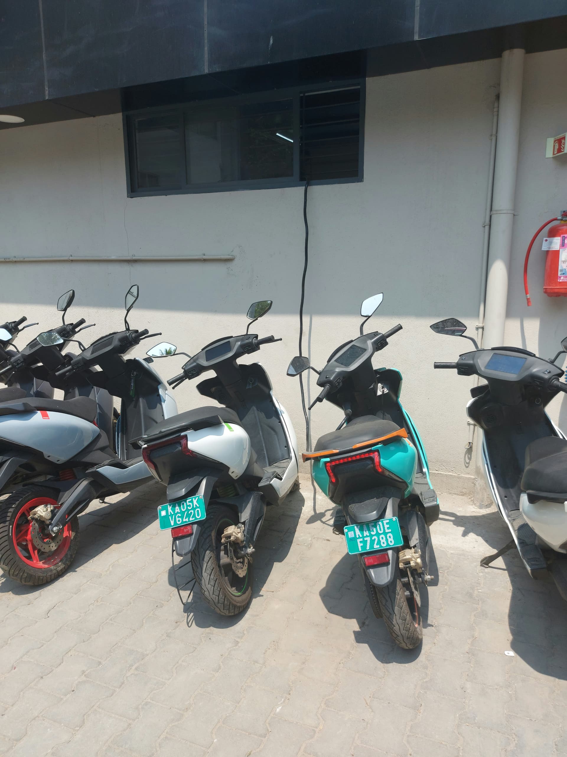

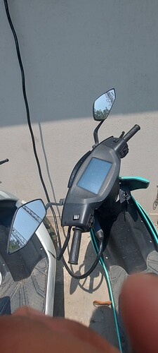

When the scooter is charging in the service center it doesnt need to be turned off, it charges in key on position. It should be in warp mode and the kill switch should be engaged thats it, it will be charging at high speed

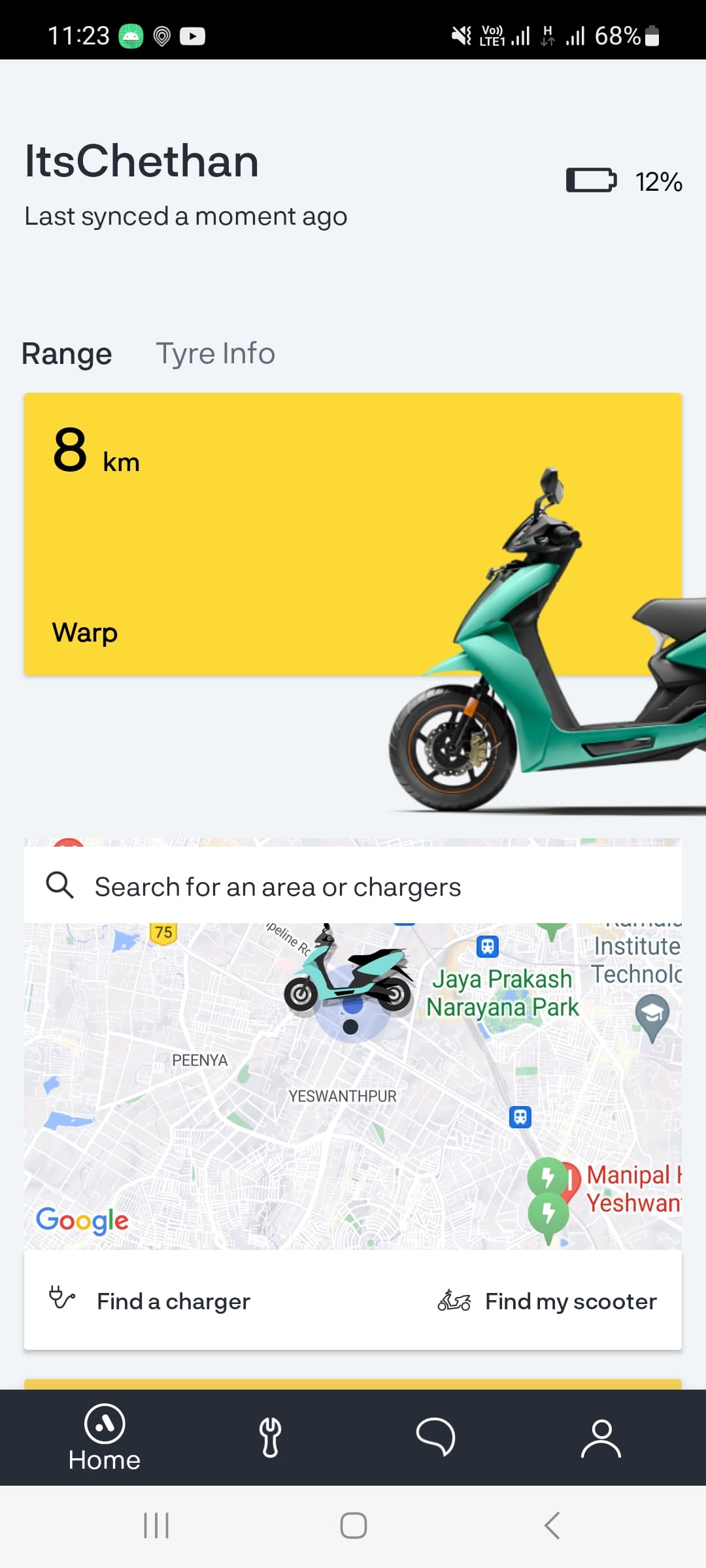

In app also it doesn’t show charging
What type of charging is this :woozy_face:
:flushed::flushed::flushed: new discovery! or maybe a special charger?
here in Okhla, Delhi they simply use your portable charger lol
open board of fast charger, just like mine, it will not turn on the screen nor the app will show the scooter is charging. All service centres charge the scooter this way only.
