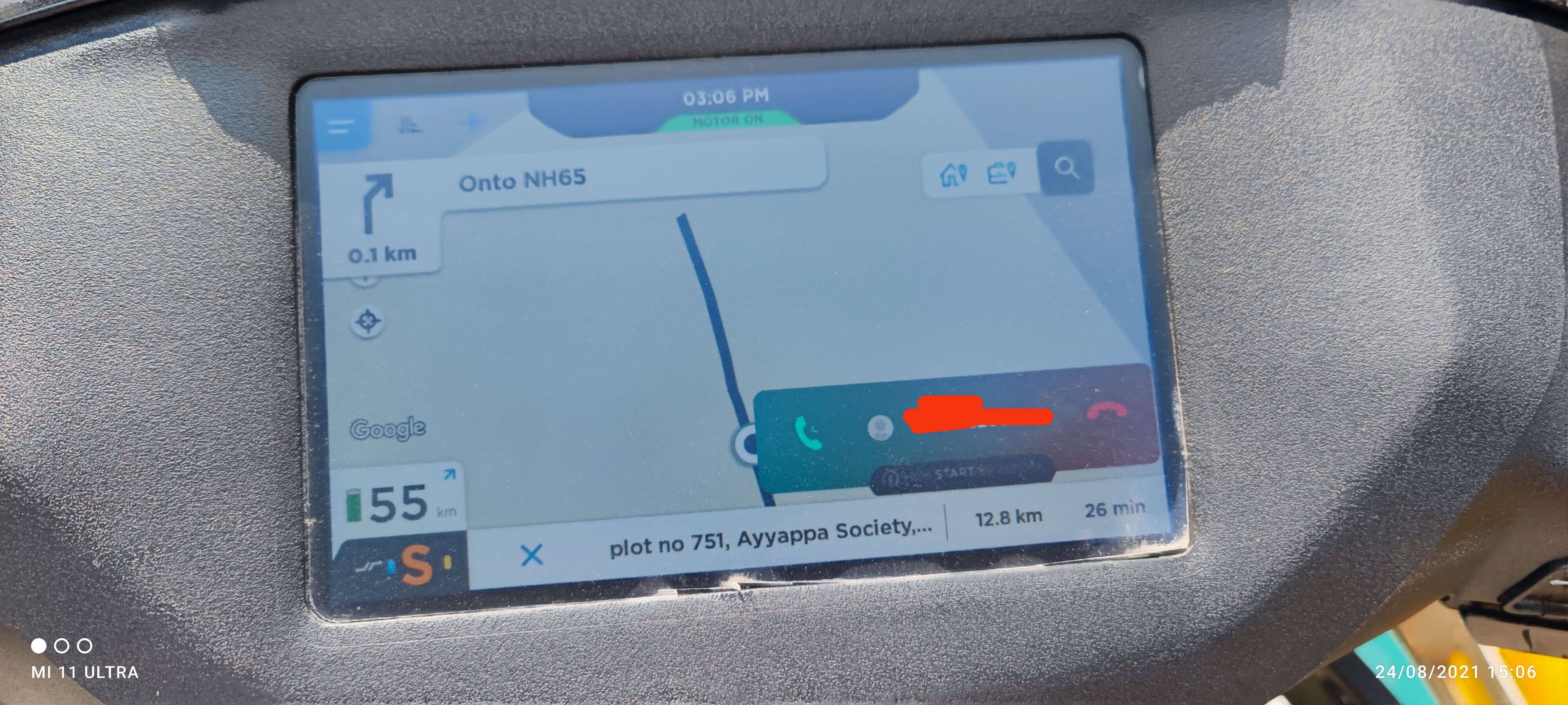

Still, Bluetooth is having so many issues. Calls card not visible during receiving calls and unable to answer calls. Initially the call card came for 1st time, after that it never appeared when calls are coming. Have to close ather app disconnect the phone and connect back again.
For one time, even after ending the call the call card shows as it is on the dashboard. Need to stop the bike, disconnect the bike and reconnect it again in order to make the stuck call card disappear.
