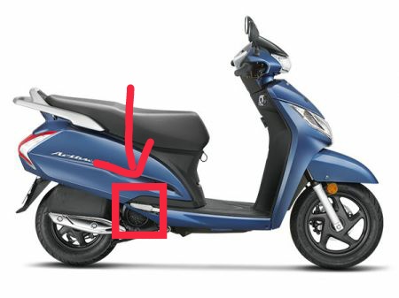

please ride an Activa with left foot down in traffic for some time in Chennai’s scorching heat.
Only possible if a bracket is created to mount on those proprietary fan mounting holes
Correct me if I’m wrong. I believe there’s no cooling fan in activa towards left . The only one I know is at the right .
that’s the Pull fan which pulls cold air from the right and forces it out from left, blowing extremely hot air
There’s no space to mount a shaft driven fan on the pulley end, and the other end is completely closed off.
