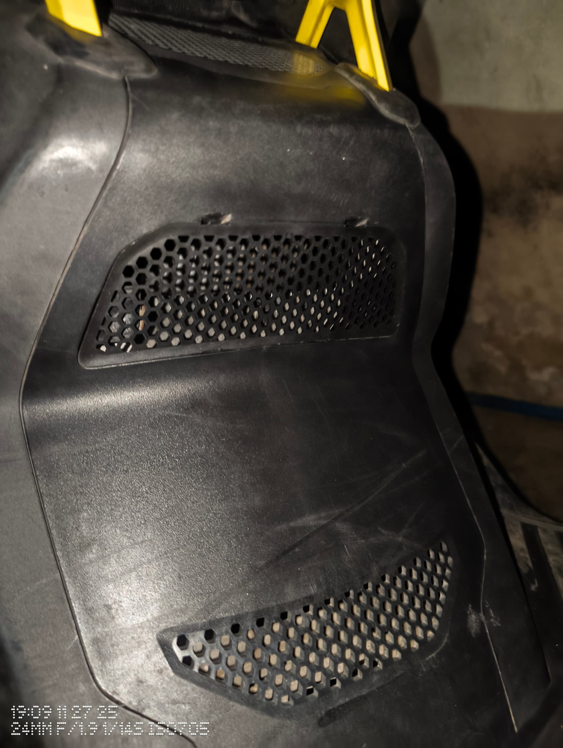

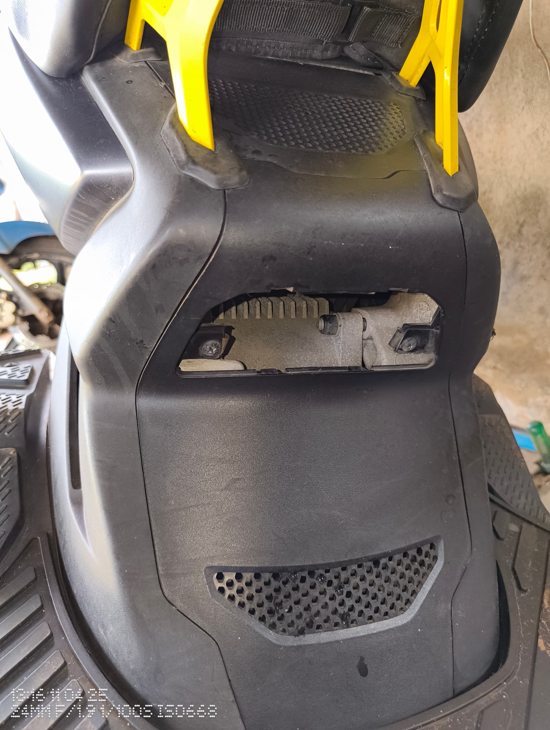

The small removable plastic trim near the footboard, close to the motor, went missing on my Ather 450X when my odometer was at 15,000 km. Now it’s at 18,700 km, and ever since that trim went missing, I haven’t seen the “Auto Hold Disabled” icon on the dashboard.
I think that plastic trim with the honeycomb vent was restricting airflow and causing the motor to overheat. You guys can try this out once — remove that trim and go for a short ride to see if there’s any difference.
I know removing it might let some debris or small stones hit the motor, but I thought about how bikes like the Splendor have their engines exposed near the front wheel — and it seems fine. So, I’ve been riding without it and enjoying the ride ever since!

Small update! I reinstalled this trim piece during my recent visit to the service center, and I can clearly notice the difference. The auto-hold disabled icon now appears occasionally during aggressive riding, which was not happening when this trim piece was not there..!
Interesting, which Gen?
Gen 4 2.9kw battery varient
Yeh that true , I have kept a fan there Which helps more
Hey man , could uh drop a pic of it.
