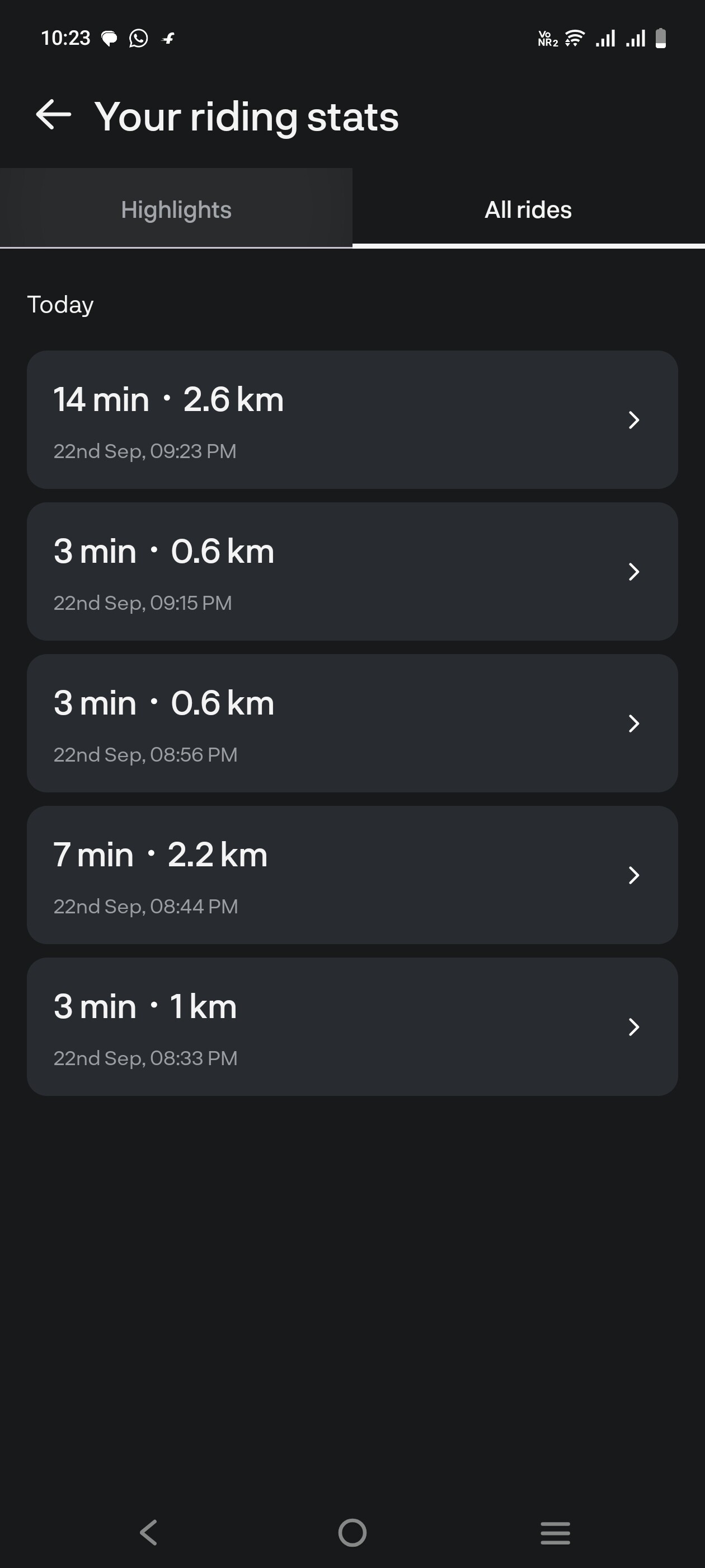

Many Bugs faces after atherstack 7 update in rizta
  1. Can’t Connect Bluetooth, it’s keeping showing connecting. Further multi paring phones addition in new dashboard not working properly.
  2. Sometimes location of scooter on dashboard and app stop changing even if it is moving or parked at different locations, it keep showing same location.
  3. Not showing rides stats properly ie showing map rides history
  4. Not Receiving Calls on dashboard.
  5. Optimize Charging option not showing in app and dashboard Above problems not solving even from resetting. Please check

Issues Faced After Atherstack 7 Update in Rizta:
  1. Bluetooth Connectivity Issues: Unable to connect to Bluetooth — it keeps showing “Connecting…” without establishing a stable connection. A restart is required every time to connect a Bluetooth device.
  2. Location Not Updating: The scooter’s location on both the dashboard and the app sometimes stops updating. Even when the scooter is moving or parked at a different location, it continues to show the same (old) location.
  3. Ride Stats Display Issue: Ride statistics are not displayed correctly — the map and related data are either missing or inaccurate.
