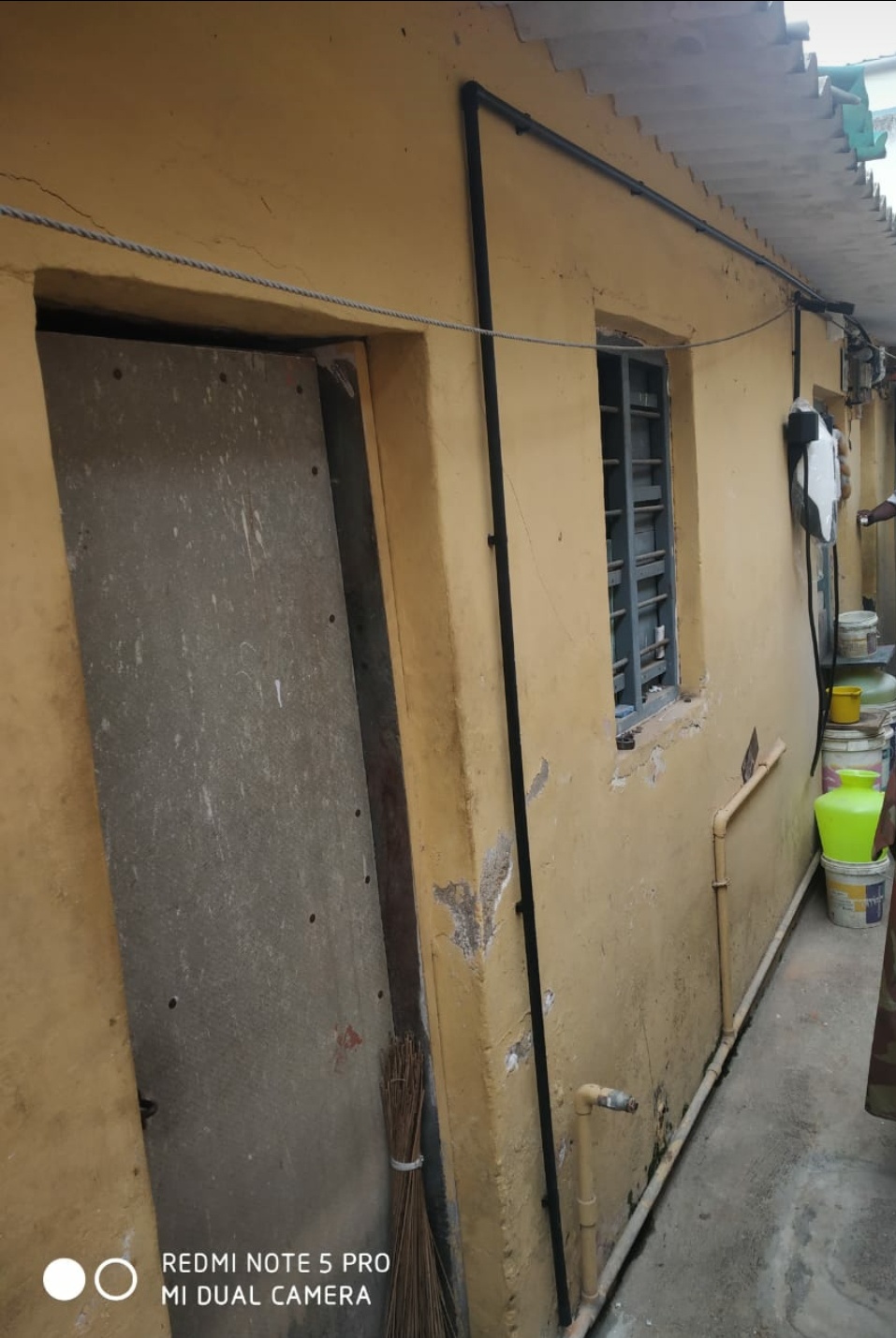

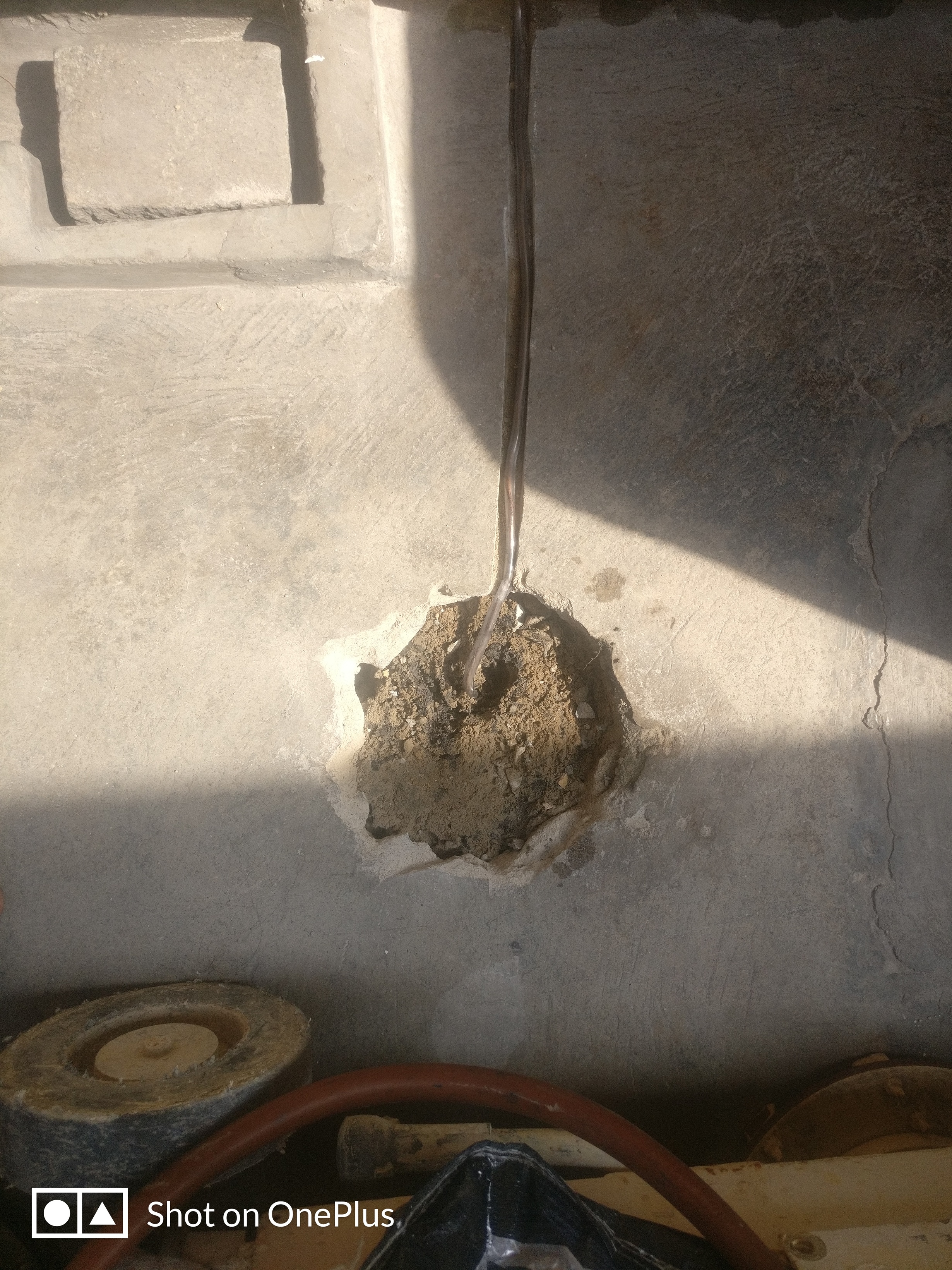

*** 2nd appointment day - Earthing work and electrical wire left photo’s :slight_smile:**
  • Earthing Point :
Electrically Wire directly mounted to the wall without fibre protect [Un-Safe]

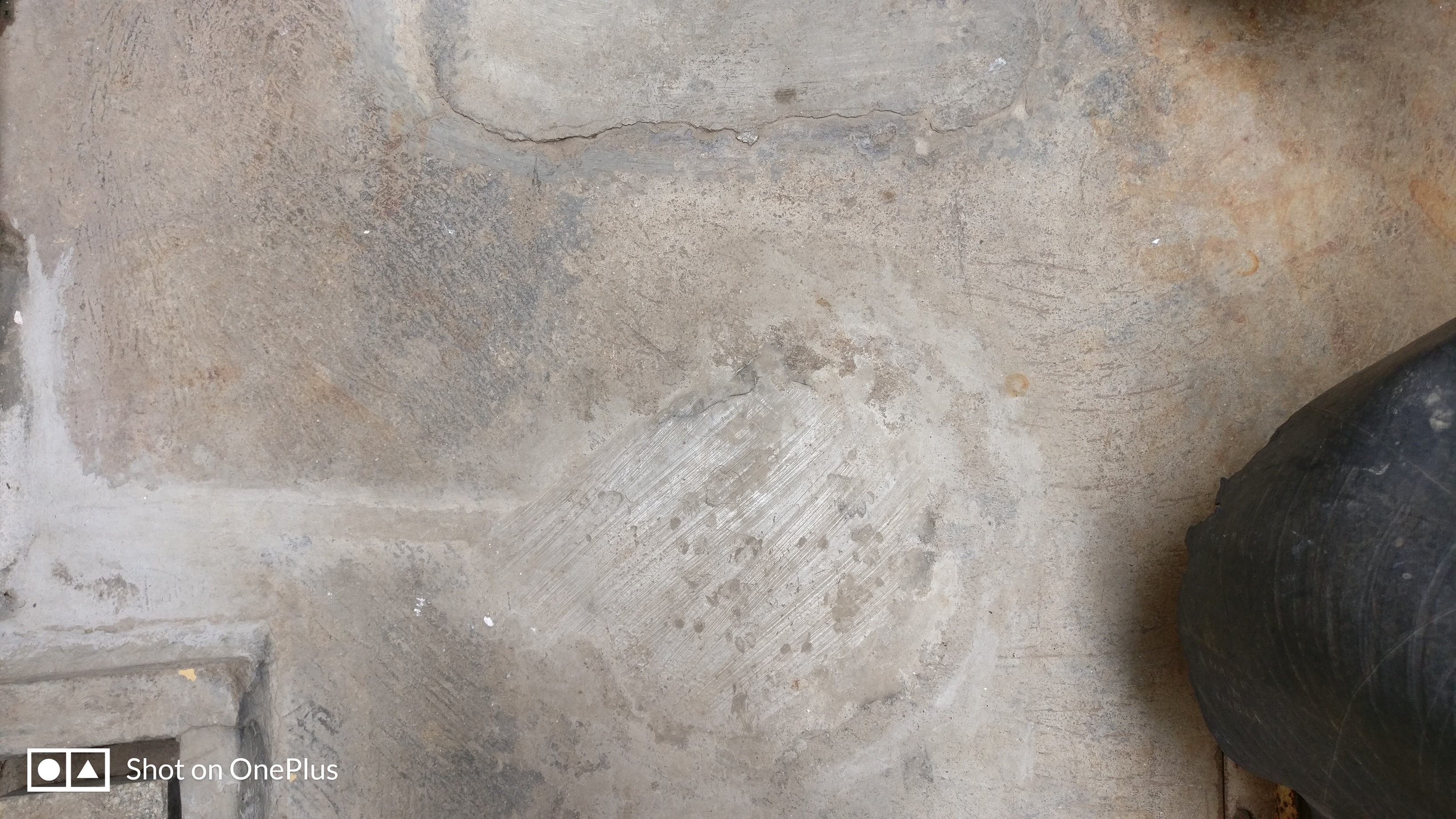

Meanwhile, I personally arranged someone who can help me to close earth digged point [3 points | 2 - Failed and 1 - Passed ] closed by aligning earthing wire with cement. Hurry up was due to the reason earthing chemical used to washed way by rain.

  • 3 Earthing digged points closed with cements.

I cannot believe, by next day 24th June 2019 at 11AM i got call from Ather, confirmed they will be reaching my home by 13:00 to finish remaining work [electrical wire inline with fibre protect] and completed work by 13:30 by Ather charging point installation team person - [Mr - Lokesh] @lokesh.mydream Thanks again.
