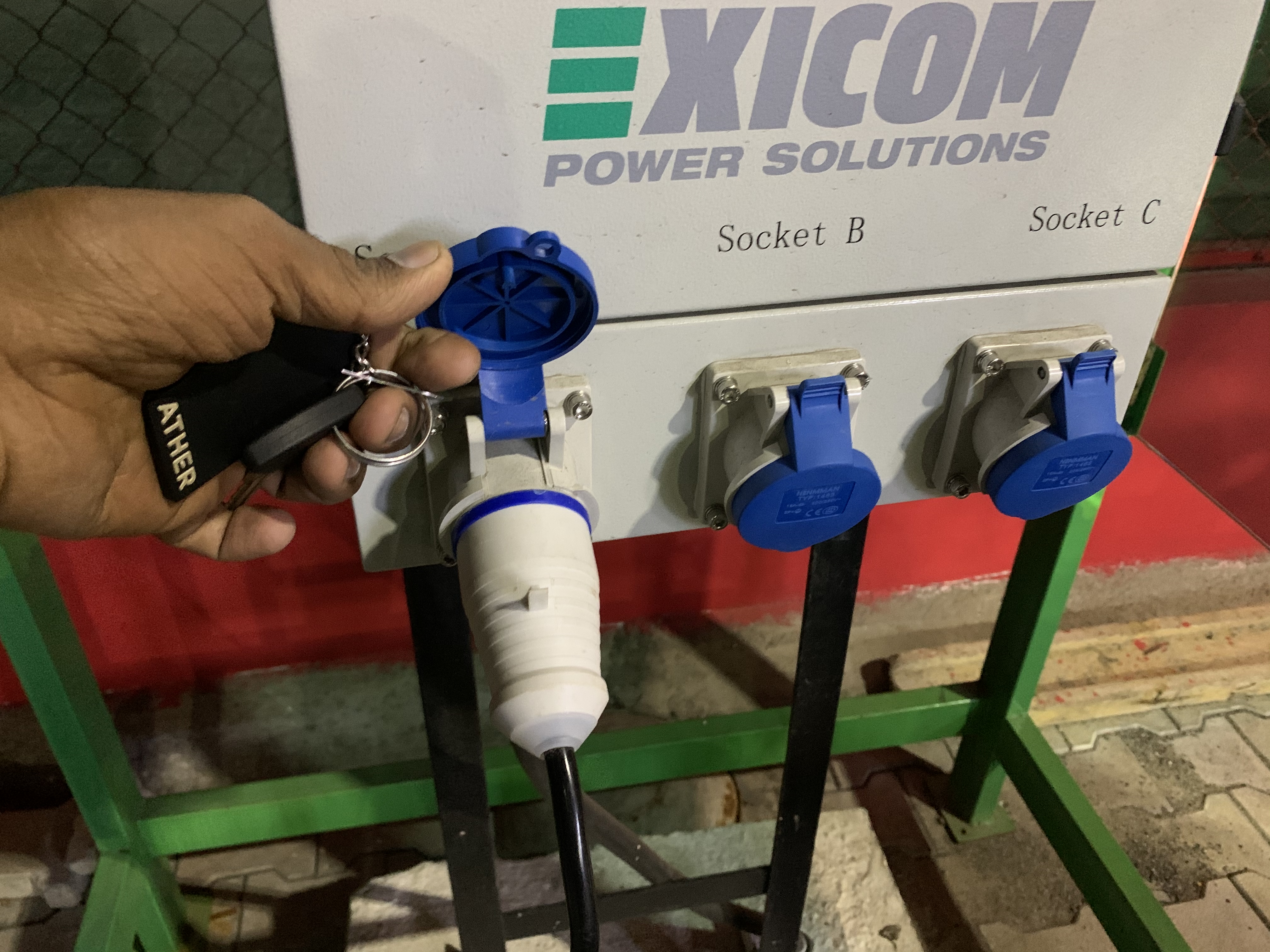

Are there any plans to make the portable chargers complaint to Bharat AC 001 wall sockets or is there an adapter that can be made available for both the type 1(aka 450 V1.0) and type 2 (aka 450 V1.1) portable chargers that Ather has been selling .
As this is a govt standardization that was live in 2017 ,we do not see any time line mentioned by your team where a existing infra mandate is being integrated by Ather proactively.
(https://dhi.nic.in/writereaddata/UploadFile/Standardization%20of%20protocol.pdf) .

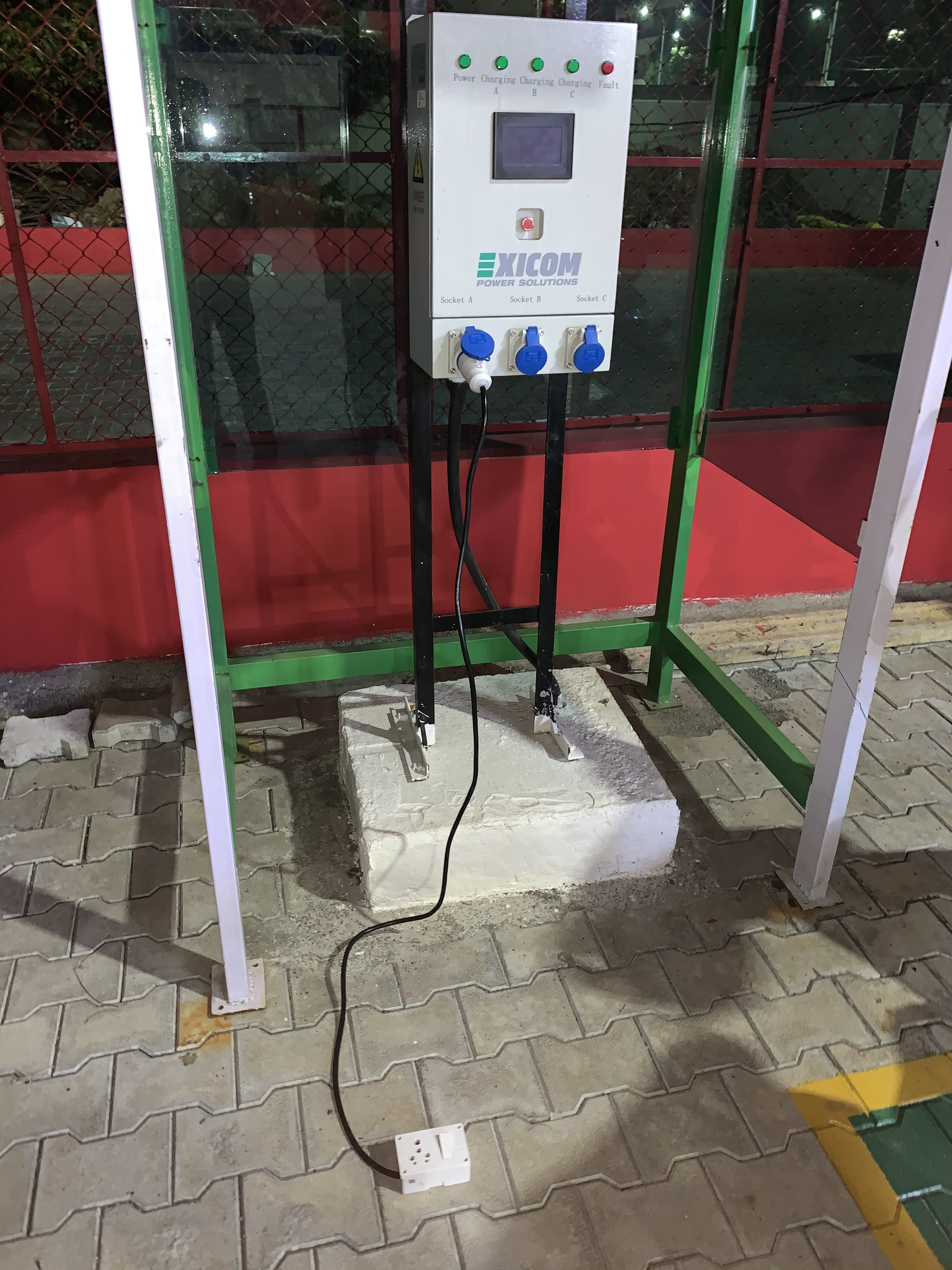

I need a solution as this will be the chargers that are being installed by Offices and business establishments to enable EV to charge on there premise.
Attached is the one installed in my office.
Will there be a compliment charger that will work on these ports by default/ via adapter or do we need to build a Jugad adapter.
These are industrial AC sockets, and you can get an adapter which converts these industrial sockets to regular 5/16A sockets and your Ather portable charger will work.
There are no plans to currently replace the 5/16A plugs with these on the portable chargers.
You try this setup and use your portable charger !

You’re more likely to find a 5A/15A socket in places to charge. We will definitely keep a look out for the adoption of the Bharat standards and consider changes later on.
5A/15A sockets will not be metered and allowed for public use. Then how is to one get permission to use a public 5A/15A when in travel where as i assume that charging station with market standard sockets will act like petol pumps for electric vehicles, but we users of Ather will not be able to utilise that facilty
@abhishek.balaji do let the design team know that there are no reliable adapters for industrial socket to 15A. They can design an accessory which can solve all problems.
it is hazardous
