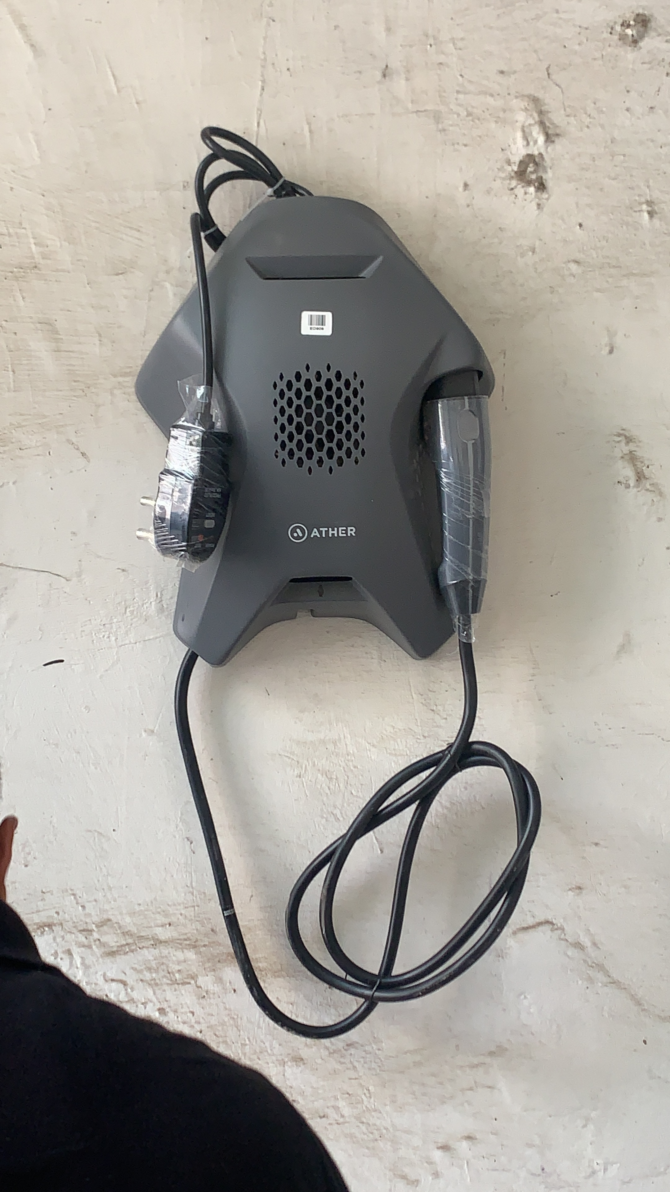

Very easy, just open the dot and connect the wire. And then close the dot and then read my above articke

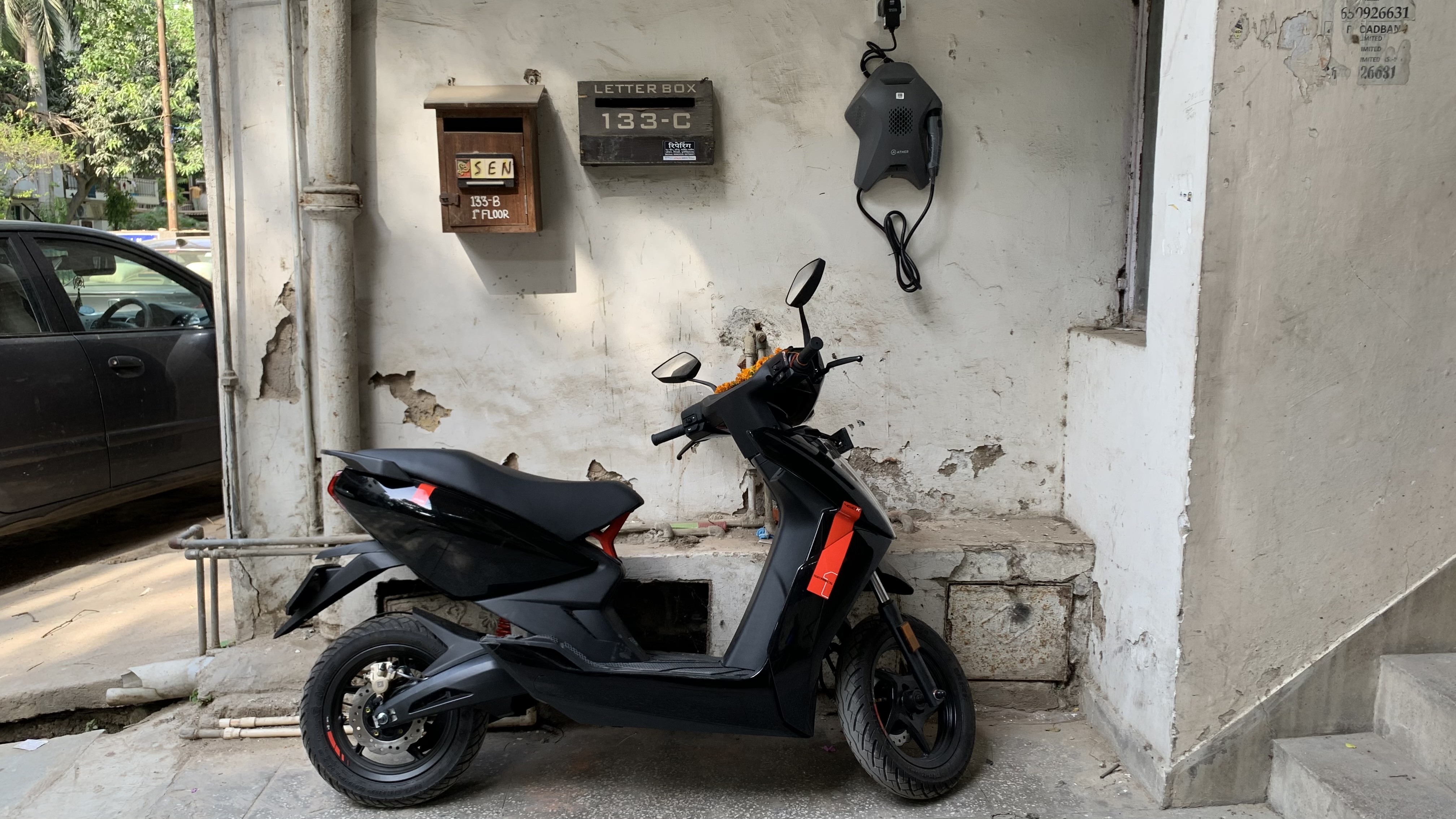

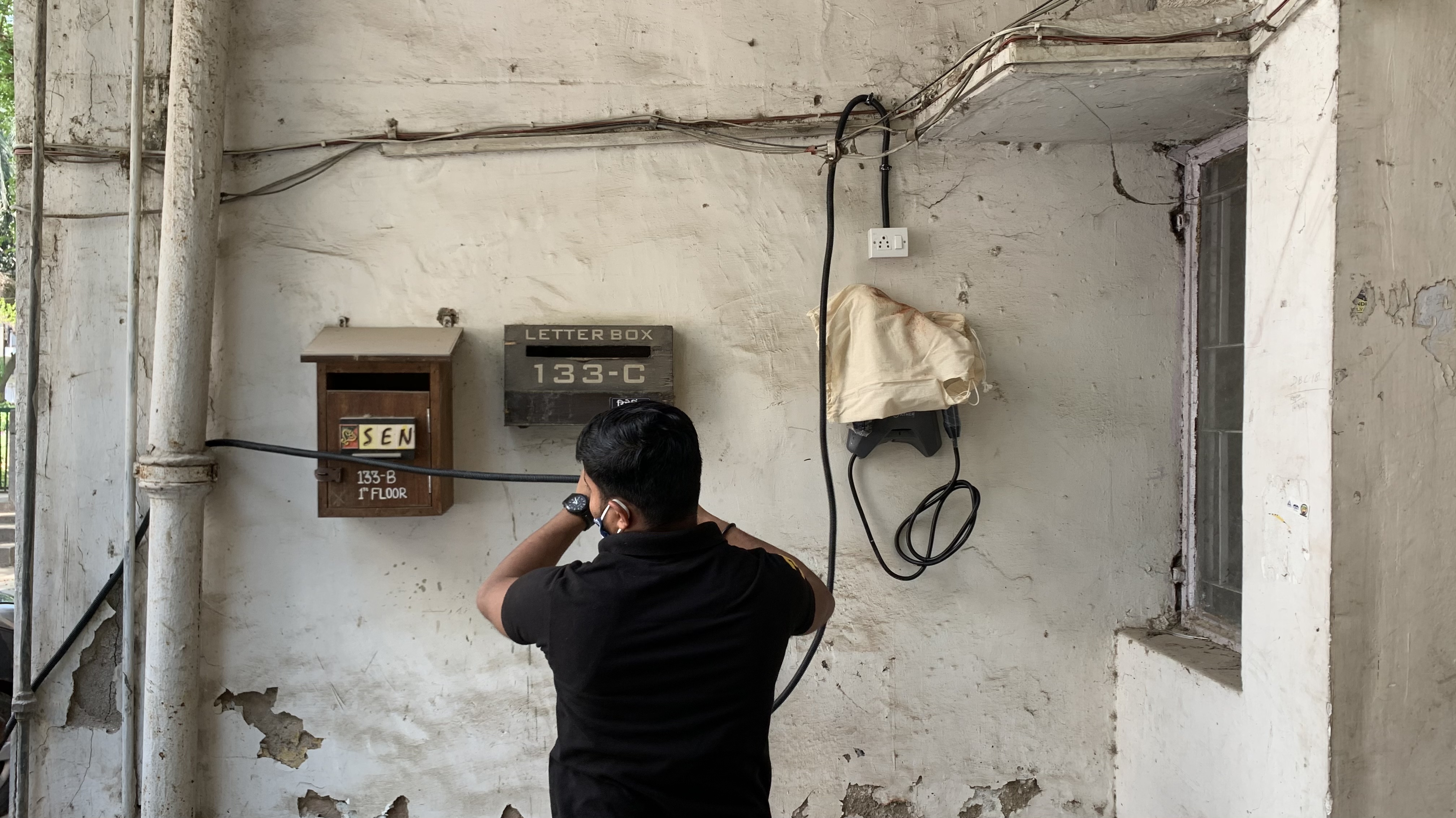

The Ather guys in Delhi did a great job. Paid for extra 2 meter cable and it was all done. Clean job. Got a box made for the Ather Dot for protection against theft or tampering.

In my case the portable wasn’t available. I stay on the 3rd and the 4th floor and i dont find any issues it being under my house. Its placed right next to where my 450x is parked. I feel dot is more convenient as it’s fixed to the wall perfectly by the Ather technicians. Saves the time and effort of plugging n unplugging it everytime. Got a box made with lock to to give it that extra protection. Dont save 2k as these guys know their job well. Clean and professional work. Better to be safe than sorry later. You can keep monitoring the charging from the app and it cuts off automatically once charged completely.
