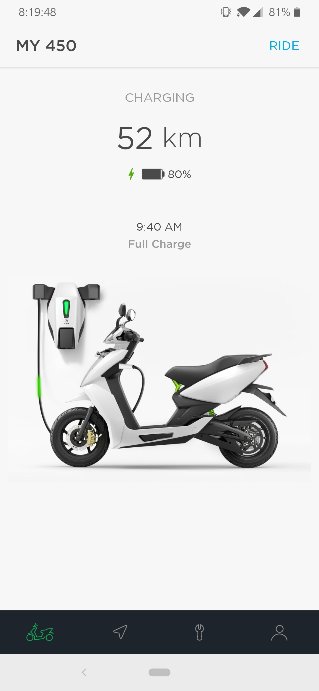

I was out of station for some days and in 25 days I saw a drop of 16% of charge and in a matter of 20 mins back to 80%
Did you shut it down or just locked it ? 16% in 25 days is great actually
I had shut it down !

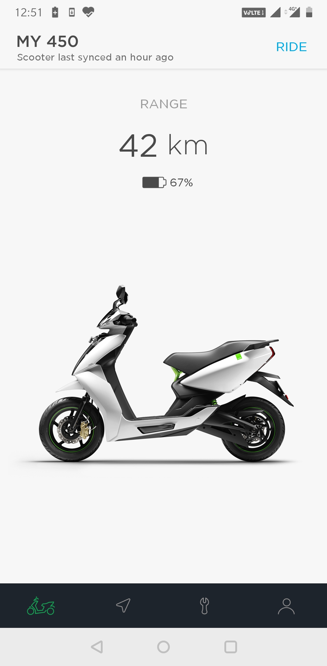

My experience on idle discharge is much worse than what is reported here. My scooter is just a month old. I don’t use my scooter everyday. But from 16 June to todau which is 19 my scooter has lost hatge from 44kms to 27kms. Does the new OTA update fix this. Any suggestions as to how to reduce this.
Hey @arun06, welcome to the community :wave:
This is normal behaviour and you can read about why this happens in our FAQs:
