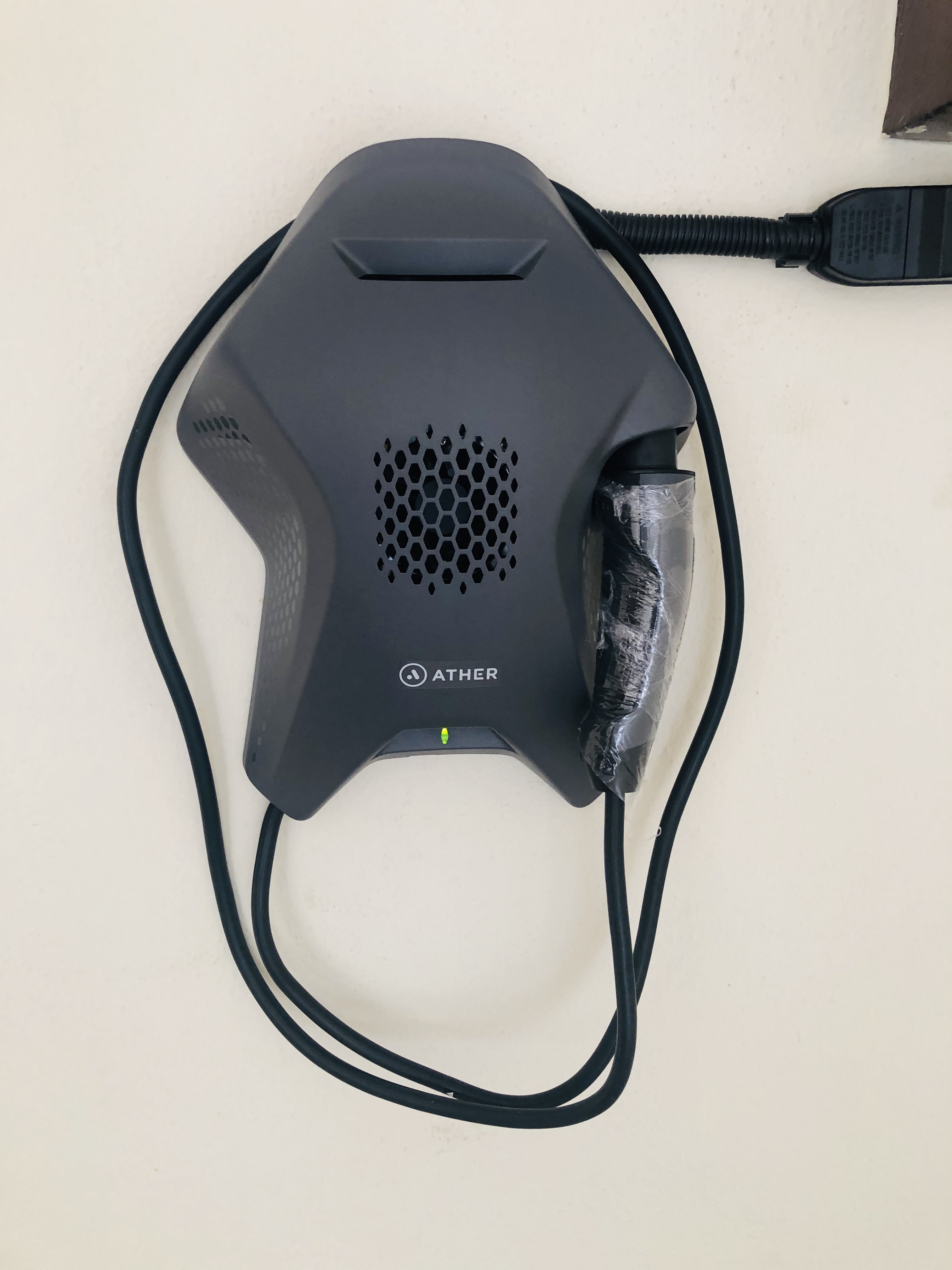

How to fix earthing as the reading is overall high even though earthing is done at our residence. Experts can please help whether the MCB will handle the earthing issue or should we dig again ?
Srivatsa, did you check this thread?
I went through this thread. Couple of issues, charger light is green and I am waiting for my vehicle to be delivered. As per the technician who installed he says vehicle may not be charged due to variation in earthing. But when I checked with my landlord he is clear that earthing process was done 2-3 years back and may not be feasible for digging right now. So need clarity on this
