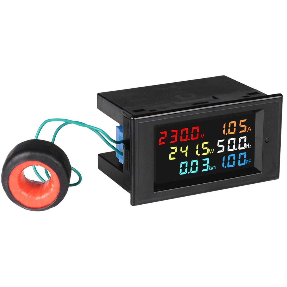

Guys… whatever charger DOT or Portable… I am amazed by quality of Ather Charger… Today 1st time I used it with an electronic device ( meter - which shows multiple factors like current, voltage, wattage and kWh and efficiency in real time) where I was indeed zapped to see the PF factor (efficiency) of 0.99 which is alltime high I have ever seen… My brother have ampere EV and its portable charger give PF factor of 0.76…

Did you use this one?
I have this too the reading in this compared to a calibrated fluke meter is way off.
This is the almost similar one which I am using… As per my testing its values are almost same with my fluke DMM
