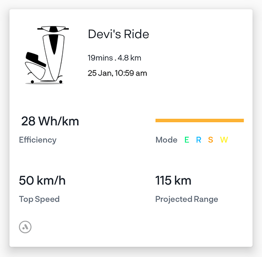

Most users wanted to see how much charge % spent for each ride, which is not available either in the app or in the vehicle.
There is a simple way to compute.
Travel distance / Projected Range * 100
Charge used for the above ride was 4.17%
It’s just one line to add in the ride statistics. Ather can consider adding it, as it will be very useful when we take the same route multiple times & will know how much charge will be consumed approximately.
That won’t be much of a help ig on the long run. Just the efficiency explains the rest of the stuff. Like the battery used for this ride is (4.8km * 28Wh/km) = 134.4 Wh. Which divided by the total usable capacity like 3240 Wh and multiplied by 100 would give around 4.15%
