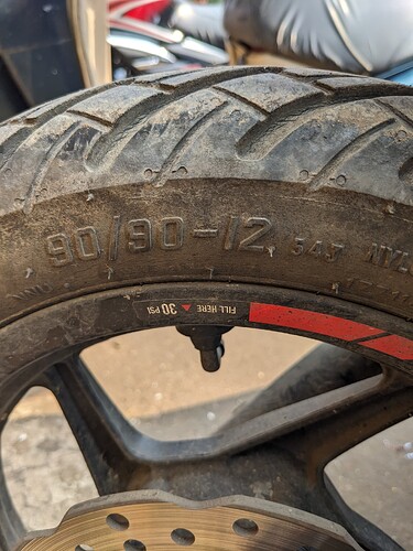

How to evaluate whether tyre needs to be replaced or not, if it’s not worn out? Front tyre, 30k ridden, 4 years aged, tread and grip is good because it’s in the front since beginning and not rotated. AFAIK, it should be replaced after 5-6 years regardless of the wear because the rubber compound gets hard.
This is how it looks, these minor cracks just on the outer layer are normal as per the internet.
@Omkar_Bochgire @chef.arun7 Guys, I want your advice not likes.:upside_down_face:
Dammm u don’t ride much I guess
Bro Imo 30k KMs or 3 Yrs is the the Life Time for Tyres
Whenever I read a Post, I just like it to ensure :smiling_face: And I thought to reply later and forgot lol :joy::laughing:
In Tyre and Safety cases, I will not suggest to refer to Internets bro. I keep my Own Standards i.e 30k KMs or 3 Yrs. Thats it
