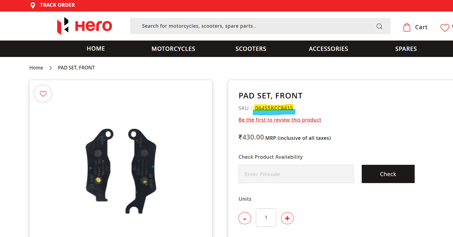

Front brake pads part number.
https://www.bike-parts-honda.com/honda-motorcycle/assignment_spare_parts/06455-KCC-841
Note: I have not tested front brakes myself , have tested only the rear brake pads and its working perfectly fine on Ather 450. Parts used are common among the various models from hero and Honda vehicles.

Updated Front brake pads with part numbers and photos for reference .
