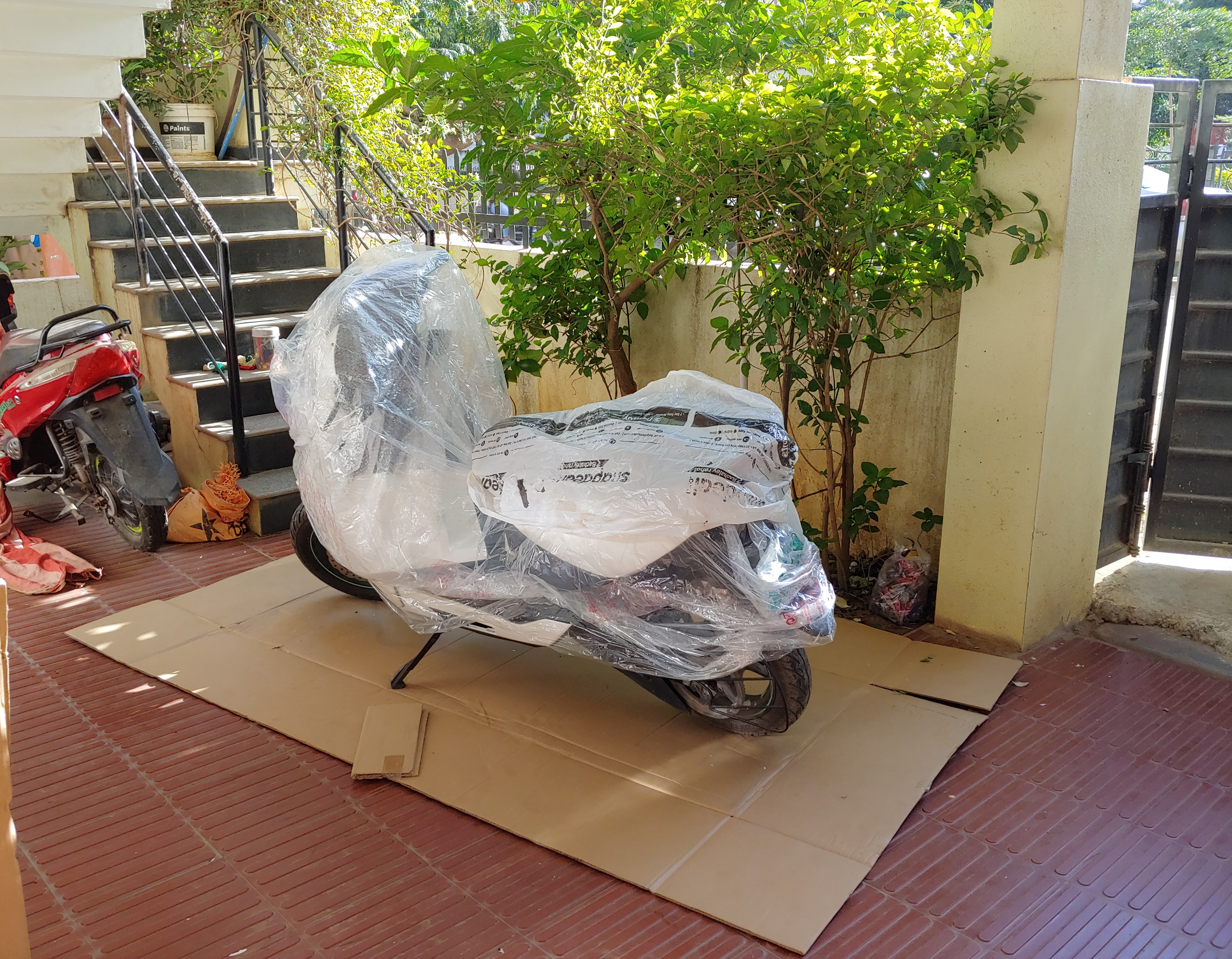

Ather picked up the scooter today morning and they said that the status will be updated once they diagnose it. The towing service they offered was quick and easy. Highly satisfied with it.
I knew about the risks of taking it outside Bengaluru, sir. But we had no option. We needed a scooter and we wanted it to be electric. Considering the huge time taken by electric two wheeler companies to foray even into metro cities, no doubt it would be a lot of time when they enter other tier 2 and 3 cities. The only scooters which we get here are the chinese ones. Having no option, we bet on this scooter despite knowing the risks. All these are just a part of the risk. No option than to face it. Heading back to Shivamogga now, hoping to get the scooter asap.:smiley:
Agree on what you said. Applause to all who took risk and I fully understand the interest/passion.
Thanks a lot for the support sir.:smiley: Probably, will ship back by the same truck.
no problem at all sir…:smiley:
Amazon type packing before shipping to Bengaluru😂. An old treadmill box and its plastic packing materials were of the right size to accomodate Ather.
