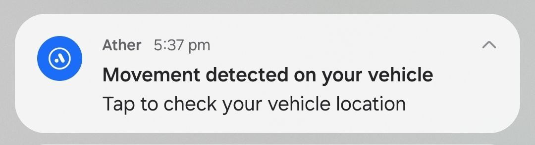

also notification worked for once

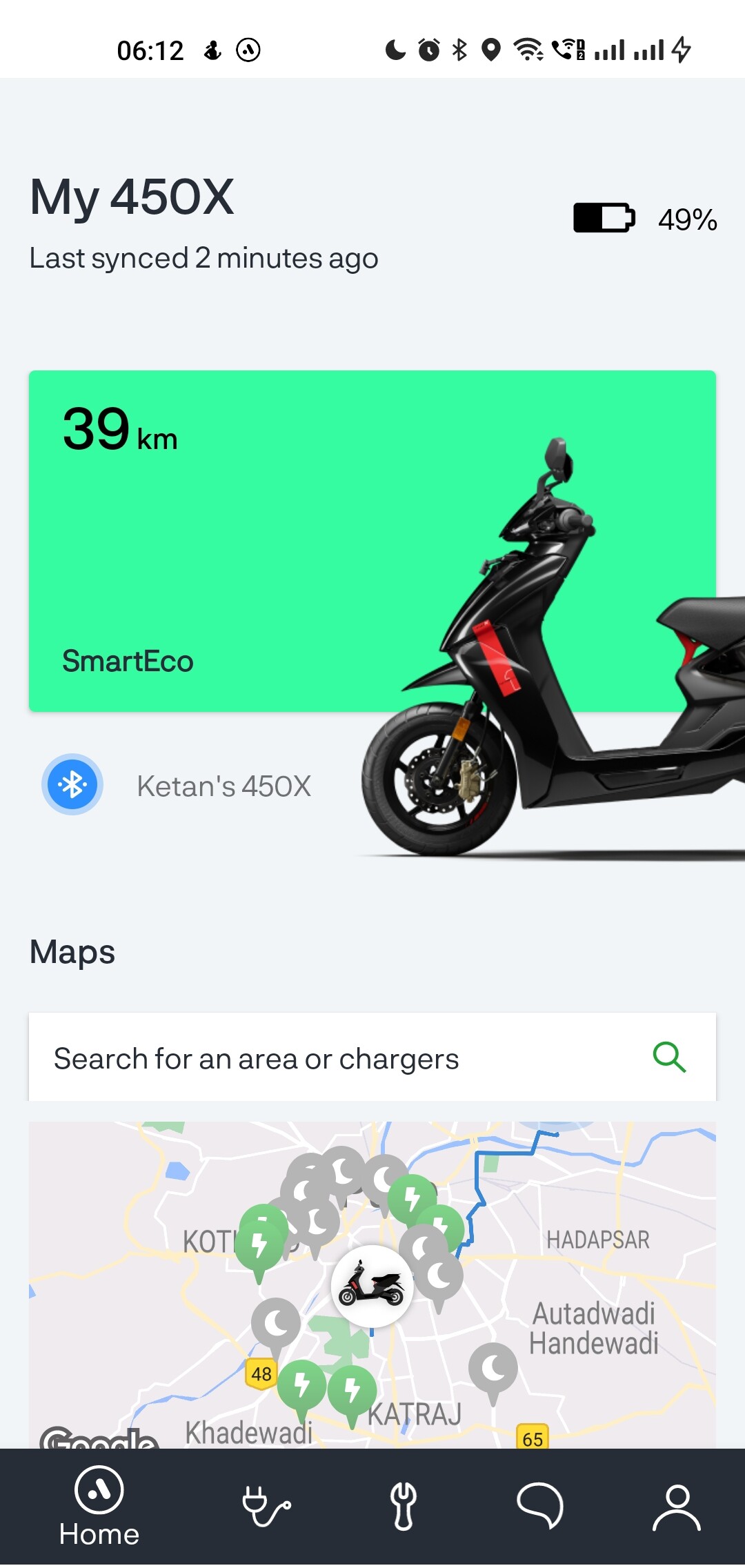

After the 10.5.10 update, Bluetooth stays connected even though my Ather was not on. I noticed it this morning after waking up that the Ather app was showing as connected. I checked my Ather, it was switched off. On turning on the key, I could see that Bluetooth was already connected. Usually it takes time to connect after turning on the key. The Blutooth got disconnected after turning off the key. I will observe tomorrow morning and update.
